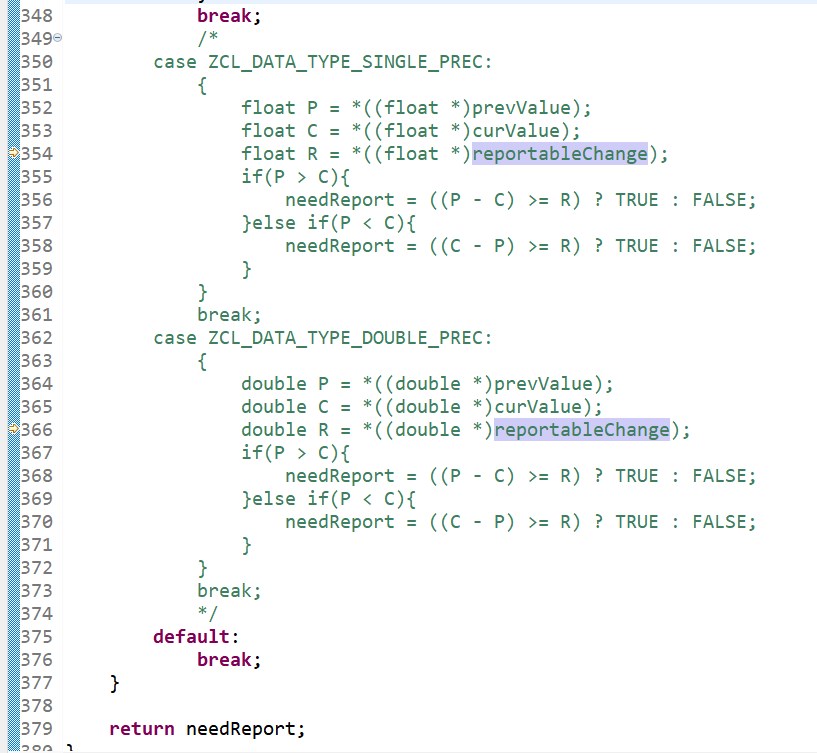

Hi.
Why is this part of the code in the file zcl_reporting.c commented out?
319

Hi,
The reason for commenting out is that 8258 does not support floating-point data types.

 楼主| 发表于 2025-6-7 02:07:37 | 显示全部楼层 来自 俄罗斯
TL_YB 发表于 2025-6-6 11:14
Hi,
You must be joking?

发表于 2025-6-9 05:22:08 | 显示全部楼层 来自 澳大利亚
Hi,
That can't be a reason!
Zigbee SDK is not only for TLSR8258
And you can have a look here for adding floating-point (soft-fp) library. https://forum.telink-semi.cn/forum.php?mod=viewthread&tid=117&highlight=float
