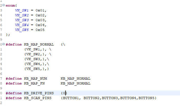

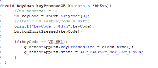

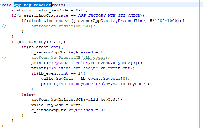

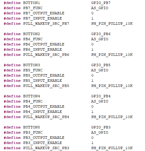

我添加多个按键如上图,但是打印出的keycode,一直只有1,2,3三个值,而且松开是3这是为啥呢?只有1,2两个按键能用

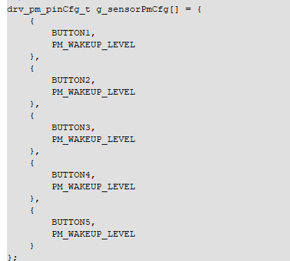

And I assume that you also have this in user_init():
drv_pm_wakeupPinConfig(g_sensorPmCfg, sizeof(g_sensorPmCfg)/sizeof(drv_pm_pinCfg_t));
I have 8 buttons defined this way and it has been working fine.

I also drv_pm_wakeupPinConfig(g_sensorPmCfg, sizeof(g_sensorPmCfg)/sizeof(drv_pm_pinCfg_t));
but my button can't used.

You could also add Led's to see if pressing the buttons works, or add some variables and check in BDT. You could add the code below (I only show for one button) in app_ui.c and see the variable btnstate when you press and hold a button.
u8 btnstate[8] = {0};
void app_key_handler(void){
        if(0 == drv_gpio_read(GPIO_PB4)){
                btnstate[4] = 1;
                led_on(LED1);
        else{
                btnstate[4] = 1;
                led_off(LED1);
'''' add for all buttons

Thanks, I will rewrite it according to your method. Here is how it is written in the Demo

You don't have to re-write.
Leave existing code as it is. But for your testing just add at the beginning of the function what I posted.This is just for testing. For working app you will need some button debouncing code..
