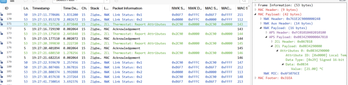

发表于 2024-12-18 19:34:58 | 显示全部楼层 来自 上海
void reportTemp(void){
        epInfo_t dstEpInfo;
        TL_SETSTRUCTCONTENT(dstEpInfo, 0);
        dstEpInfo.dstAddrMode = APS_SHORT_DSTADDR_WITHEP;
        dstEpInfo.dstEp = 1;
        dstEpInfo.dstAddr.shortAddr = 0x0000;
        dstEpInfo.profileId = HA_PROFILE_ID;
        s16 temp = 0x0834;//21.00
        zcl_report(1, &dstEpInfo, TRUE, ZCL_FRAME_SERVER_CLIENT_DIR,
                        ZCL_SEQ_NUM, MANUFACTURER_CODE_NONE,
                        ZCL_CLUSTER_HAVC_THERMOSTAT, ZCL_ATTRID_HVAC_THERMOSTAT_LOCAL_TEMPERATURE,
                        ZCL_DATA_TYPE_INT16, (u8 *)&temp);
77

发表于 2024-12-19 04:40:49 | 显示全部楼层 来自 澳大利亚
TL_YB 发表于 2024-12-18 19:34
《---myCode-C---》
Sorry, you are correct. You can use address 0x0000 because it is Gateway network address. This means that the report will only be received by the Gateway.
