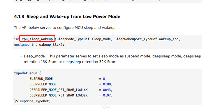

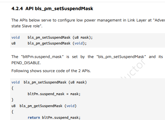

do we use this api put deep sleep mode   bls_pm_setSuspendMask()  but here there is no option for deep sleep without retention mode its only having deep sleep retention mode and suspend mode               #define                        SUSPEND_DISABLE                                0
#define                        SUSPEND_ADV                                        BIT(0)
#define                        SUSPEND_CONN                                BIT(1)
#define                        DEEPSLEEP_RETENTION_ADV                BIT(2)
#define                        DEEPSLEEP_RETENTION_CONN           BIT(3)
#define                        MCU_STALL                                        BIT(6)
1)how to configure deep sleep  without retention mode using this api bls_pm_setSuspendMask() ?
2)difference between this two api bls_pm_setSuspendMask() and cpu_sleep_wakeup() ?
305
1033
1033
发表于 2024-12-16 15:38:53 | 显示全部楼层 来自 广东深圳
You can refer to this handbook for specific content
