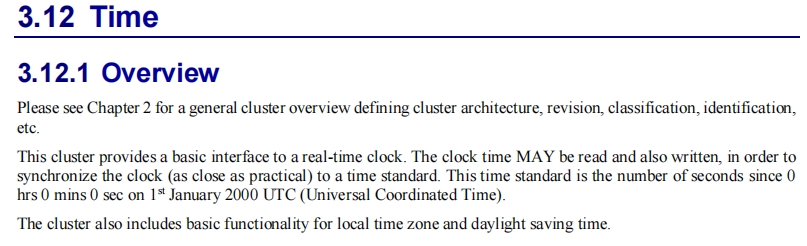

319
1021
1021
发表于 2024-12-23 17:36:59 | 显示全部楼层 来自 上海
You can find this passage in the ZCL spec.
77
430
430
发表于 2024-12-24 04:32:04 | 显示全部楼层 来自 澳大利亚
Thanks for that. I was reading this and somehow I missed it..
Why would they do it this way.
Someone didin't think that you have to get accurate time stamp from somewhere. And you get it from the internet from NTP server.
So, you have to convert it to ZigBee UTC time stamp.
