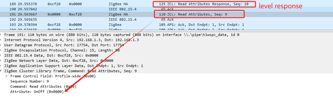

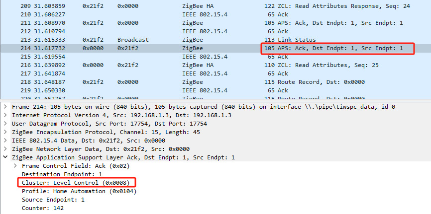

 楼主| 发表于 2024-12-24 08:32:56 | 显示全部楼层 来自 广东深圳
image is RF data, after returning level data, the gateway did not send an ASP ACK confirmation. But to immediately send an inquiry about Onoff?
