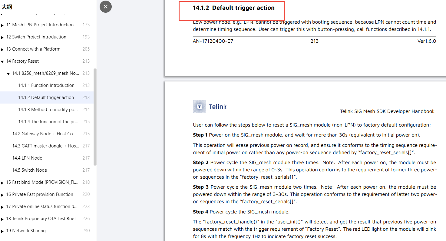

发表于 2024-12-26 15:37:20 | 显示全部楼层 来自 广东深圳
“Telink SIG MeshSDK Developer Handbook”,You can refer to this document

发表于 2024-12-26 19:10:20 | 显示全部楼层 来自 广东深圳
Following the normal procedure, when factory_reset() is called and the node restart is completed, the node status can be obtained by using get_ provision state
