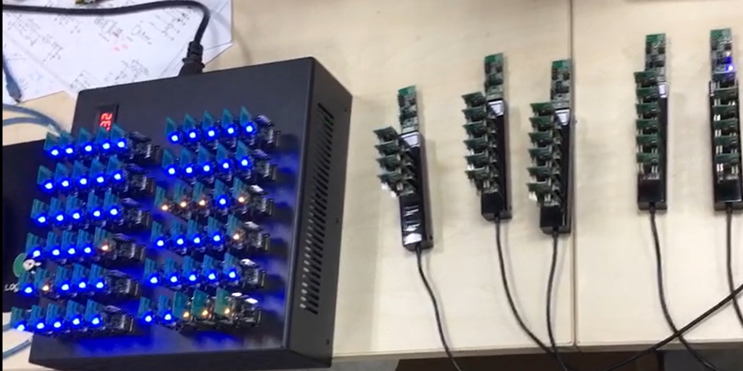

After I commissioned 1 coordinator and sampleLights(over 40pcs),
I turned off and on the coordinator.
What time is until all sampleLights (over 40pcs) connect to coordinator ?

When I use sampleLight (under 30pcs), coordinator communicate without problem.
But When I use sampleLight (over 40pcs), coordinator communicate with problems(some data have timeout).
Each sampleLight have 3 endpoints.(Light Endpoint, Motion Sensor Endpoint, Light Sensor Endpoint).
Do you know why ?

Are you tested with sampleLight (over 40pcs) ?
1. Commissioning over 40 pcs sampleLight Dongles.
2. Send command bight level and cct value to each sampleLight Dongles sequentially.
    => some dongles will be not connected with coordinator randomly.
