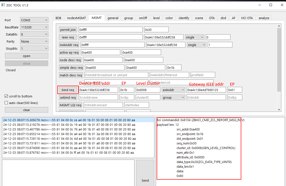

发表于 2024-12-25 05:54:25 | 显示全部楼层 来自 澳大利亚
You won't get an answer why it works differently on anothre manufacter chips.
That's all you have to do to bind it:
Or you can remove the references to cheking the binding table in the zcl_reporting.c
You were talking about x labs chips.
When I read here https://community.silabs.com/s/article/creating-bindings-and-reporting-entries-using-the-emberznet-cli?language=en_US it looks like the same what Telink is doing.
