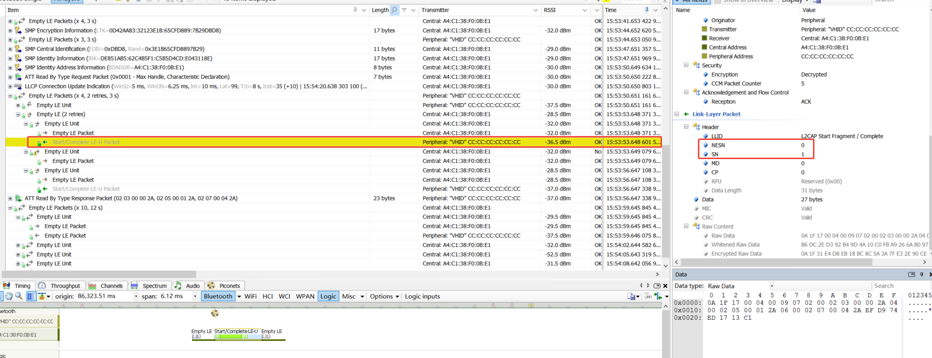

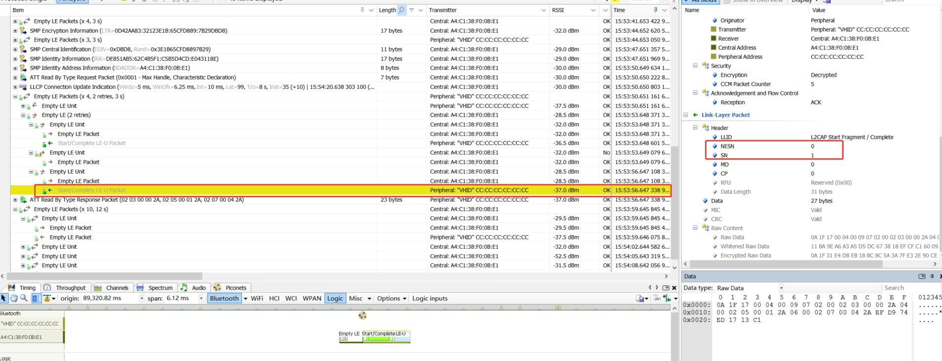

发表于 2025-9-22 16:03:37 | 显示全部楼层 来自 上海
Hi,  I conducted the test as per your method. As shown in the figure, when the central device does not receive the data packet, the peripheral device will resend the packet.
We conducted the test using the professional Bluetooth packet capture tool Ellisys. Could you please confirm whether the issue is caused by the packet capture tool on your side?
