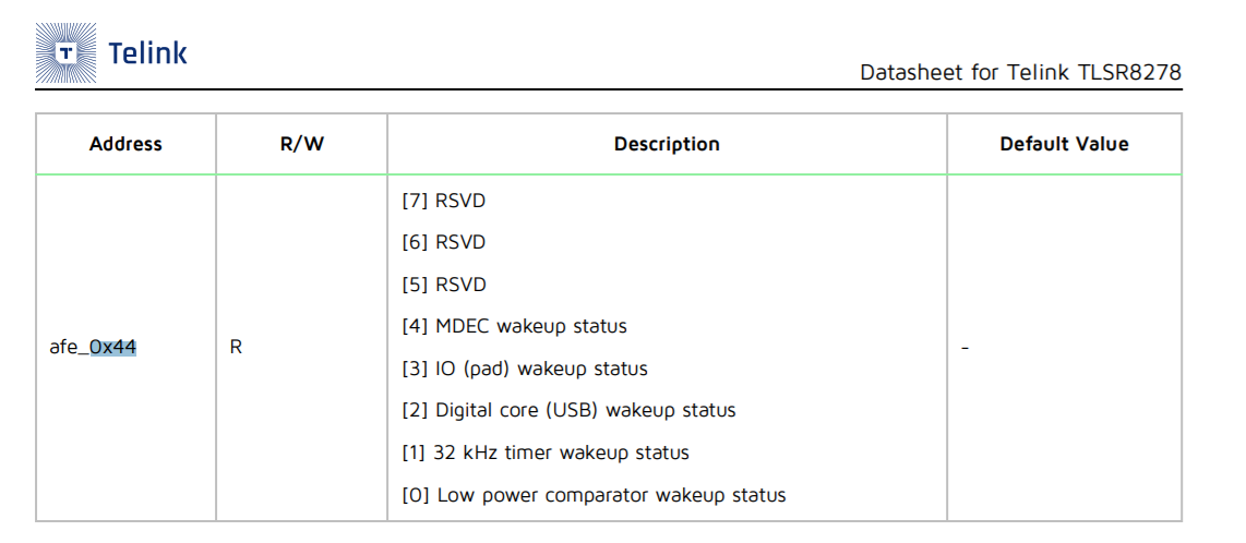

 楼主| 发表于 2024-8-24 16:27:41 | 显示全部楼层 来自 上海
读模拟寄存器0x44
发表于 2025-8-11 16:10:31 | 显示全部楼层 来自 广东深圳
* @brief      This function serves to get mcu status.
* @param[in]  none.
* @return     pm_mcu_status
static inline unsigned char pm_get_mcu_status(void)
SDK提供了库函数,如果是GPIO唤醒可以通过以下接口查询
* @brief      This function serves to determine whether mcu is waked up by pad.
* @param[in]  none.
* @return     1- yes , 0- no.
static inline unsigned char pm_is_padWakeup(void)
        return pmParam.is_pad_wakeup;
可惜的是查询不了是哪个GPIO唤醒的

 楼主| 发表于 2025-8-12 10:34:35 | 显示全部楼层 来自 上海
不支持查询GPIO唤醒口。可考虑在唤醒后检查GPIO
