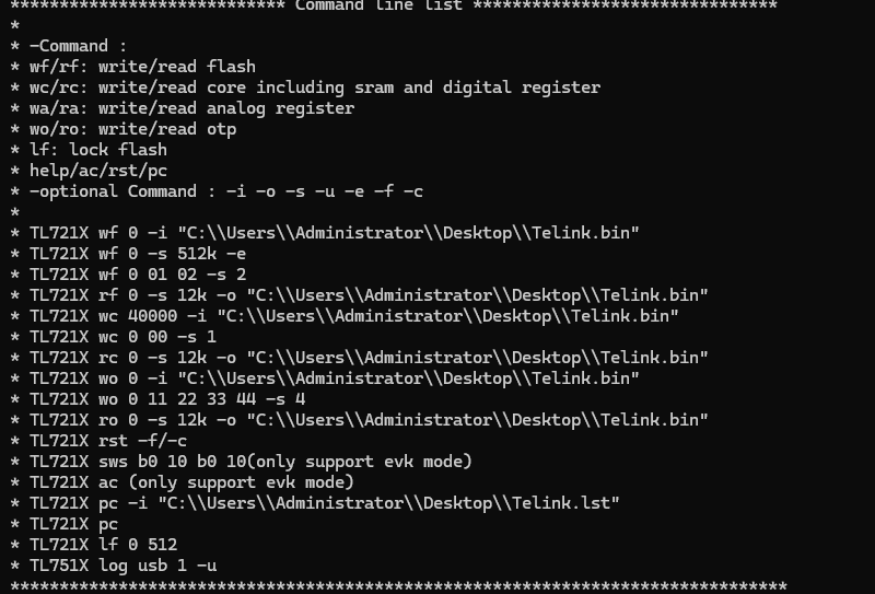

I'm using Telink BDT v5.8.5 and the command line tool Cmd_download_tool.exe to flash TLSR8258-based devices (via TC32 EVK, Swire interface).
When I use the GUI version of BDT, I Can get this output :
TC32 EVK: Swire ok flash mid = 0x001460c8, flash status = 0x0000, lock area: 0x00000000-0x00000000 flash uid: 41 50 33 32 36 36 32 07 00 c0 00 f3 ff ff ff ff  Total time: 761 ms
However, I’d like to get this same information (flash UID) using the command-line interface (CLI).
I’ve checked the available commands with:
Cmd_download_tool.exe help
and I see options like:
I’m not sure if there is a correct or recommended method to read flash info, or if there’s another CLI command that directly prints the flash MID/UID like the GUI does.
Can anyone from Telink or the community confirm the correct usage or show an example command for reading flash info via CLI?

The current version of the CLI does not support the flash info command for the time being. This one will be added in the future.

 楼主| 发表于 2025-11-1 13:17:41 | 显示全部楼层 来自 美国
TL_WMS 发表于 2025-10-31 16:31
The current version of the CLI does not support the flash info command for the time being. This one  ...
is there a specific place I can read the uid from in the flash ?
