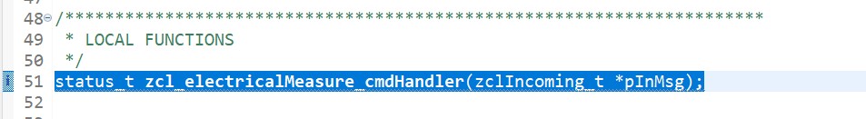

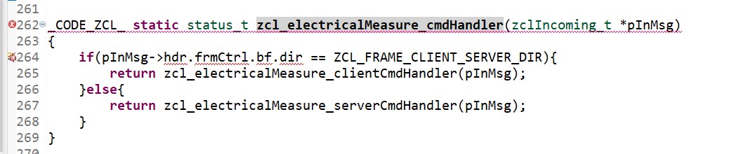

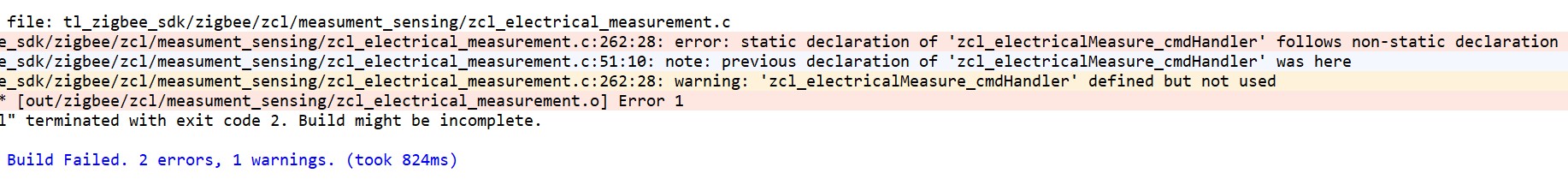

zcl_electrical_measurement.c:262:28: error: static declaration of 'zcl_electricalMeasure_cmdHandler' follows non-static declaration
