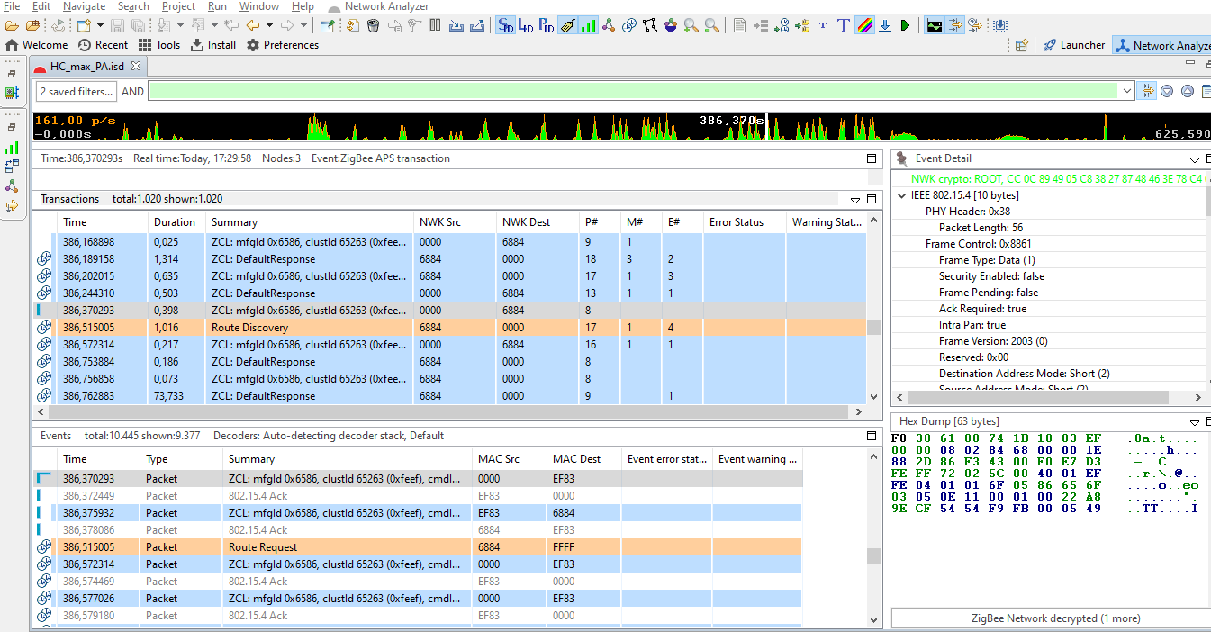

I have one concentrator with many-to-one and 2 routers.
Sometime, the condition is still normal, but I see the node router 0x6884 send the route discovery to 0x0000. I don't know why?
How can I disable Route Discovery of router or reduce the period of the Route Discovery of router?
You can check the attach file ( I get the sniffer using Silabs tool, Simplicity).
Route Discovery

Sorry, I am unable to open files in .ISD format.
You can try increasing TRANSFAILURE_CNT_MAX to reduce the sensitivity of routing table failures.
