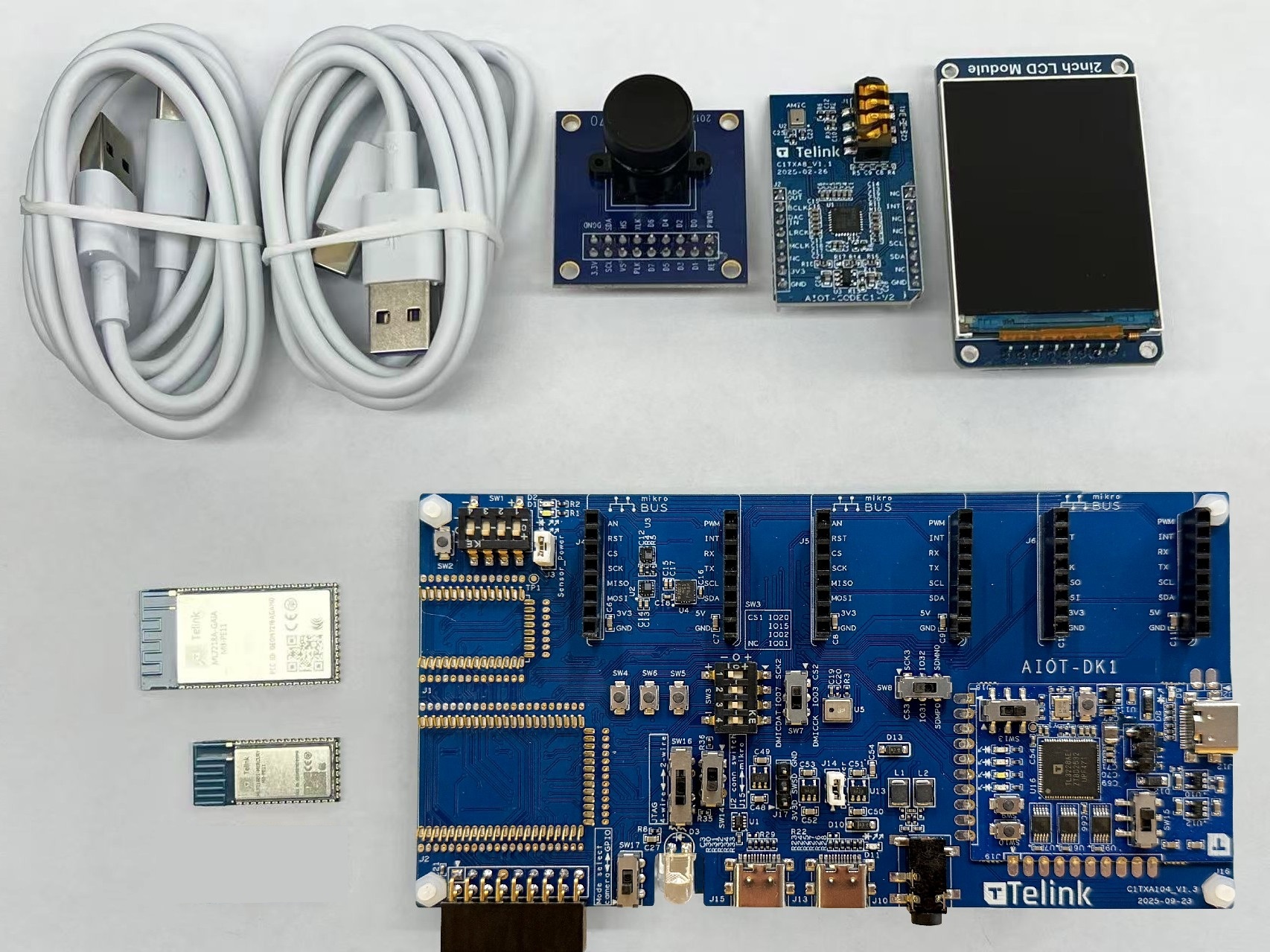

Hardware Preparation
Hardware
(1) AIOT-DK1 * 1
Used as motherboard, supporting on-board burning and enabling combined use with other submodules.
(2) Platform Module * 2
Only one platform module is supported to work at the same time, including TL721x big module, TL721x small module.
(3) Peripheral Module * 3

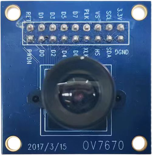

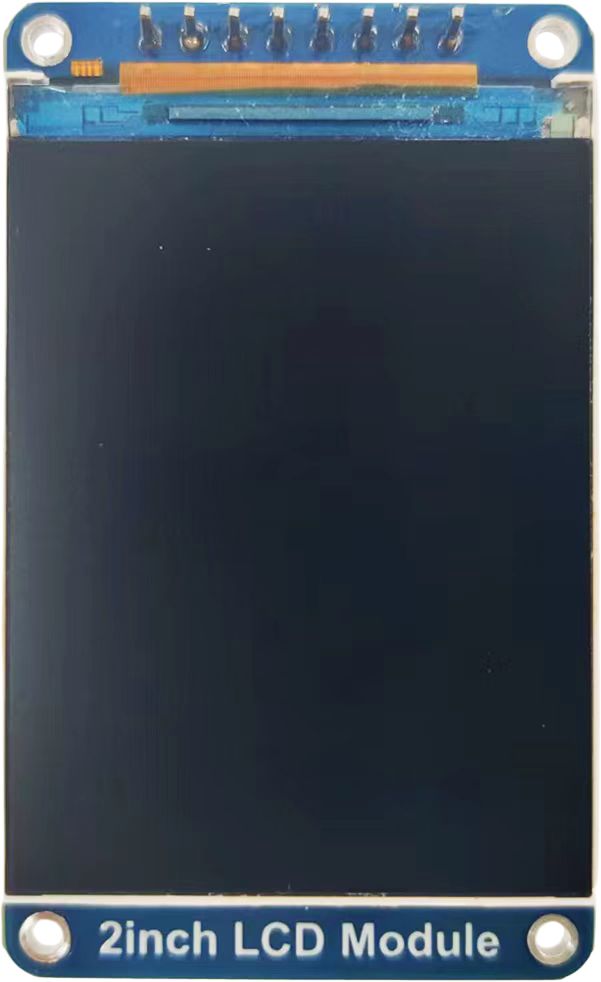

Contain 1 LCD module, 1 CODEC module, 1 camera.
(4) USB Type-A to Type-C Cable * 2
One cable is used for burning and the other cable is used for power supply and USB data communication.

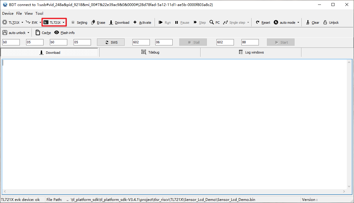

Users can burn the platform module directly through the Telink BDT tool using USB connection to J12 of the motherboard; SDK uses tl_platform_sdk and the software version needs to be higher than v3.5.0.
Software
Note
  • As shown above, this document takes the TL721x big module as an example, and chooses TL721X as the burning platform. Other platform modules need to replace the corresponding platform.

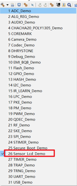

Select Sensor_Lcd_Demo project in tl_platform_sdk, compile and burn the target file to the module with the following physical connection:

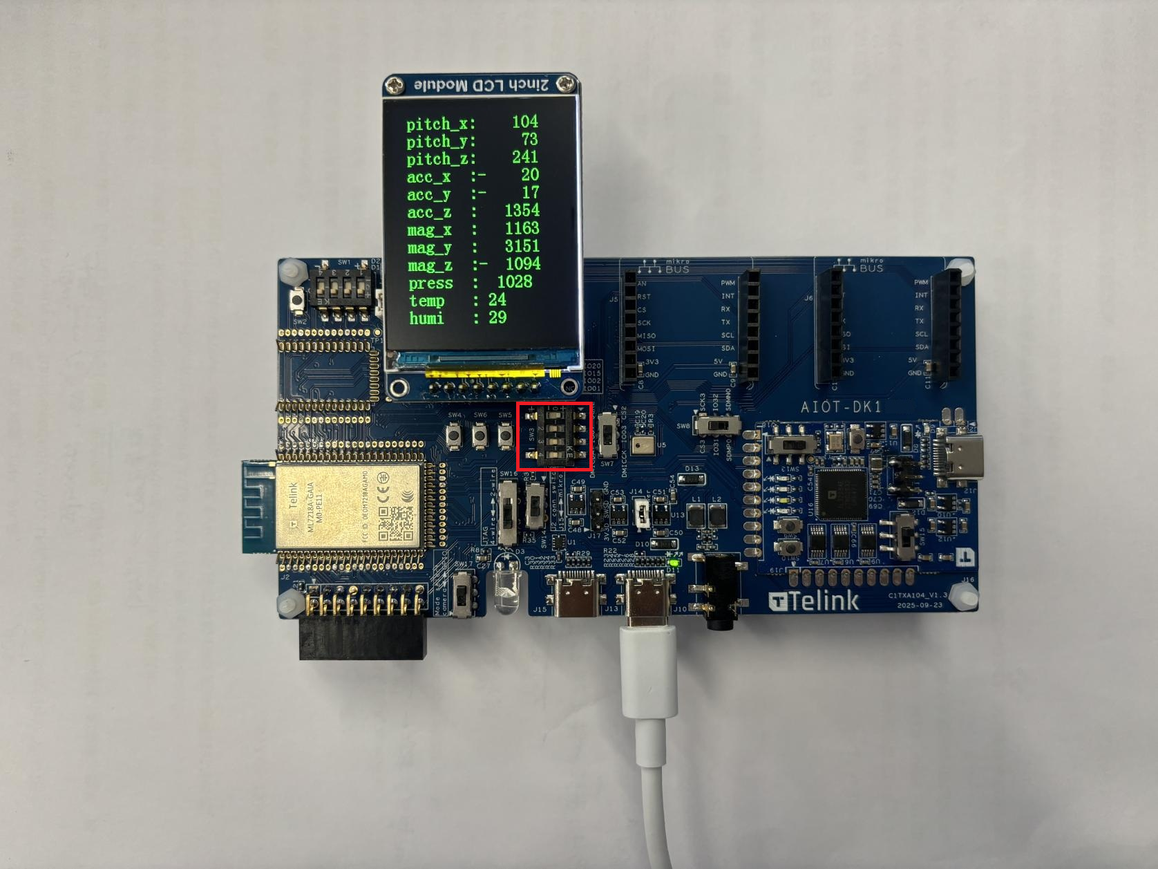

  • Connect the TL721x big module to J2 and mikroBUS J4 to the LCD module.
  • Turn on the switch 1 of the SW3 and turn off the switch 2-4 to select the corresponding chip select pin.
When the burning is complete, basic data of the Sensor will be displayed on the screen:
Sensor Data

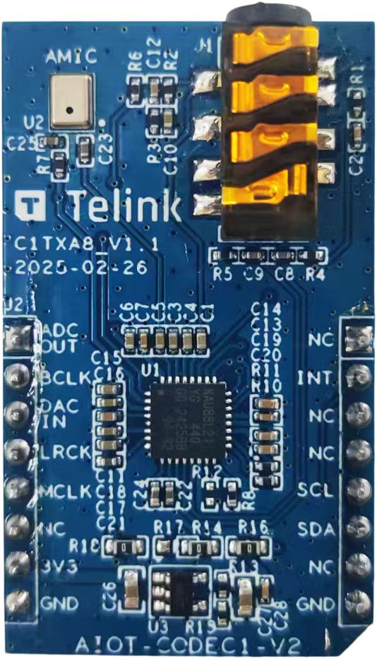

There are various models of external CODEC modules, and the currently supported ones are as follows:
  • AIOT-CODEC1-V2: NAU88L21
  • AIOT-CODEC2-V2: ES8389

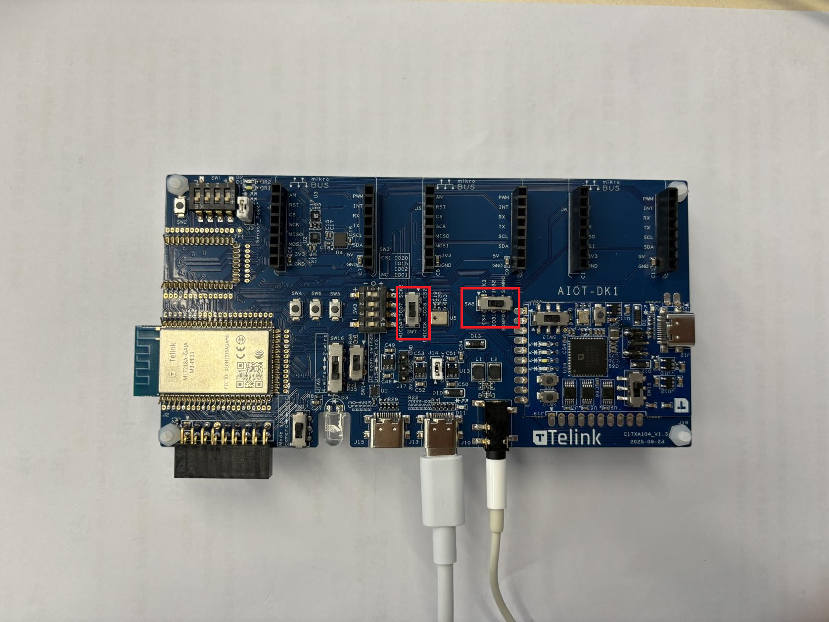

  • Connect the TL721x big module to J2 of the motherboard.
  • Set the SW7 switch to the lower side and the SW8 switch to the right side for use of the built-in CODEC.
After the burning is complete, the sound captured by the DMIC can be heard with headphones.

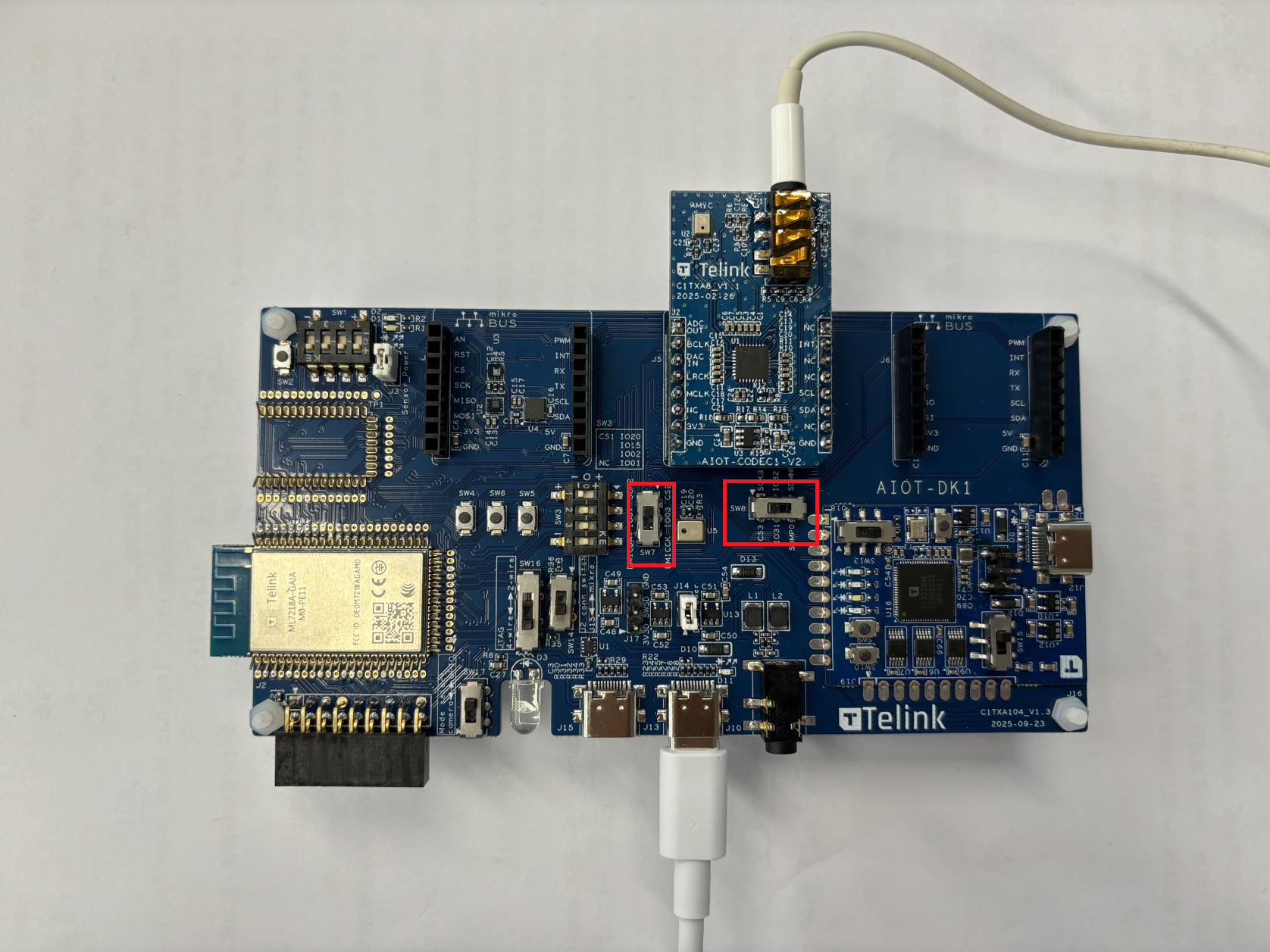

Compile and burn the target file to the module with the following physical connection:
External CODEC Burning Connection
Note
  • Connect the TL721x big module to J2 and the mikroBUS J5 to the CODEC module
  • Set the SW7 switch to the top side and the SW8 switch to the left side for use of an external CODEC.
The default configuration of software is I2S_TO_EXT_CODEC_USB mode, after burning, the USB port will enumerate the audio devices, select the Telink device:
Select Telink Device
The audio plays now can be heard through headphones.
If the software is configured with I2S_TO_EXT_CODEC_MIC_SPK, the sound captured by the MIC can be heard with headphones.

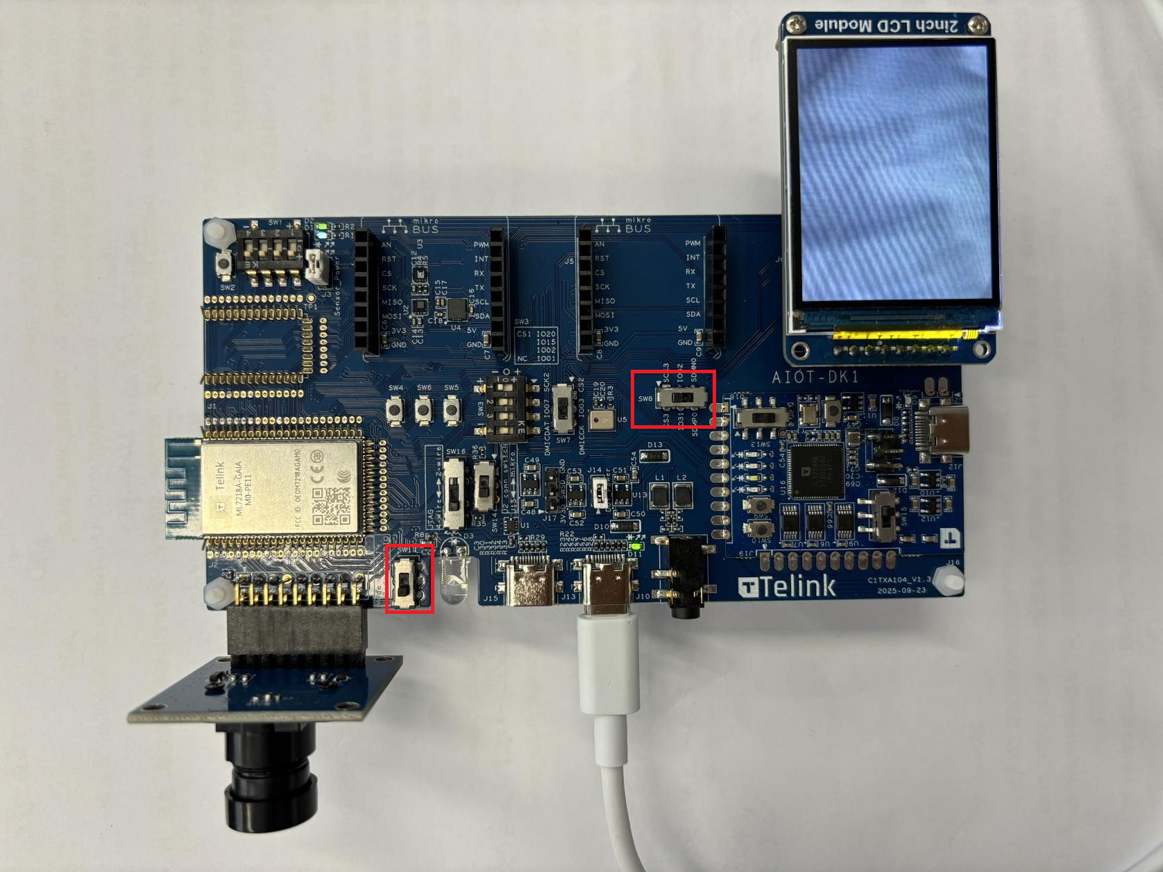

Select Camera_Demo project in the TL721x project in tl_platform_sdk, compile and burn the target file to the module with the following physical connection:
Camera Burning Connection
Note
  • Connect the TL721x big module to J2 and mikroBUS J6 to the LCD module and J7 to the camera module.
  • Set SW17 switch to the lower side and the SW8 switch to the left side.
After burning is complete, the screen will display the data captured by the camera in real time.
