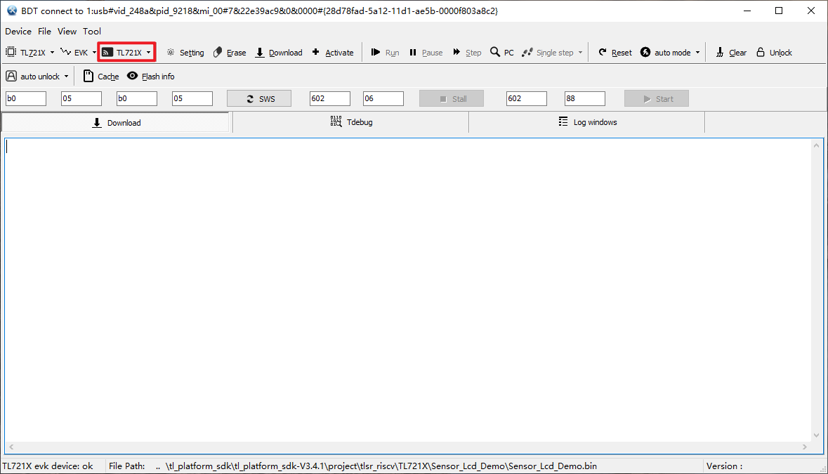

Users can burn the platform module directly through the Telink BDT tool using USB connection to J12 of the motherboard; SDK uses tl_platform_sdk and the software version needs to be higher than v3.5.0.
Note:
- As shown above, this document takes the TL721x big module as an example, and chooses
TL721Xas the burning platform. Other platform modules need to replace the corresponding platform.- When using BDT to burn, the motherboard's
SW13switch needs to be set to the right (to support Single Wire mode), and theSW15switch needs to be set to the right (to burn the module).

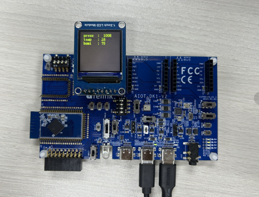

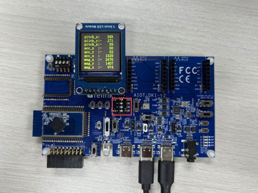

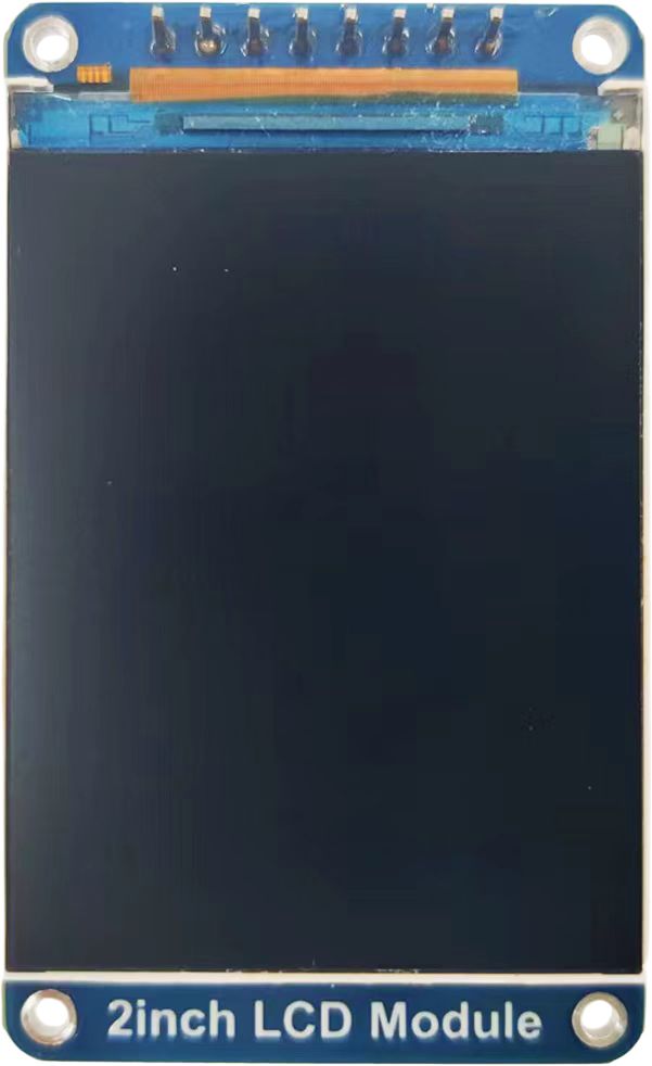

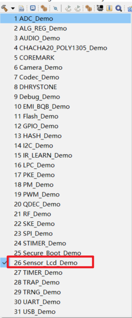

Select Sensor_Lcd_Demo project in tl_platform_sdk, compile and burn the target file to the module with the following physical connection:
Notes:
- Connect the TL721x big module to
J2and mikroBUSJ4to the LCD module. - Turn on the switch 1 of the
SW3and turn off the switch 2-4 to select the corresponding chip select pin.
When the burning is complete, basic data of the Sensor will be displayed on the screen. Due to the large amount of Sensor data, it is displayed in two pages, the above figure shows the data from the first page and the following figure shows the data from the second page:

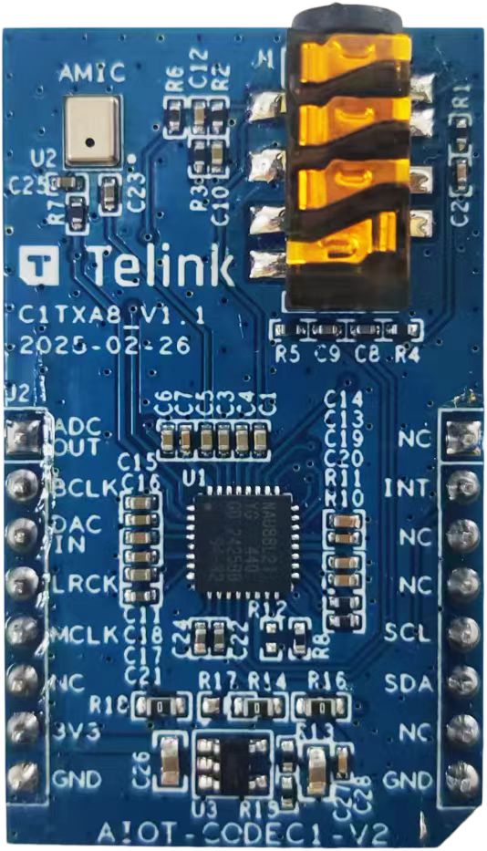

There are various models of external CODEC modules, and the currently supported ones are as follows:
- AIOT-CODEC1-V2:NAU88L21
- AIOT-CODEC2-V2:ES8389

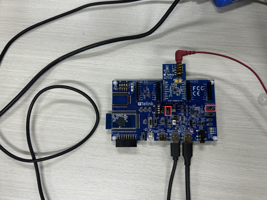

Built-in CODEC
Select Codec_Demo project in tl_platform_sdk and configure the macros as follows:
##define AUDIO_MODE DMIC_INPUT_TO_BUF_TO_LINEOUT
Compile and burn the target file to the module with the following physical connection:

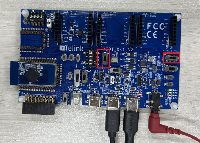

Notes:
J2of the motherboard and the mikroBUSJ5is inserted with the CODEC module. - Set the
SW7switch to the lower side and theSW8switch to the right side for use of the built-in CODEC.
After the burning is complete, the sound captured by the DMIC can be heard with headphones.
External CODEC
##define AUDIO_MODE I2S_TO_EXT_CODEC_USB
or
##define AUDIO_MODE I2S_TO_EXT_CODEC_MIC_SPK
CODEC is currently available in a variety of models, with corresponding macros selected according to the hardware:
/* Choose different external codec type */
##define I2S_TO_EXT_nau8821 1 //external codec
##define I2S_TO_EXT_es8389 2 //external codec
##define AUDIO_I2S_TO_EXT_MODE I2S_TO_EXT_nau8821
Notes:
J2and the mikroBUSJ5to the CODEC module - Set the
SW7switch to the top side and theSW8switch to the left side for use of an external CODEC.

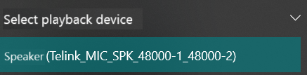

The default configuration of software is I2S_TO_EXT_CODEC_USB mode, after burning, the USB port will enumerate the audio devices, select the Telink device:
The audio plays now can be heard through headphones.
If the software is configured with I2S_TO_EXT_CODEC_MIC_SPK, the sound captured by the MIC can be heard with headphones.

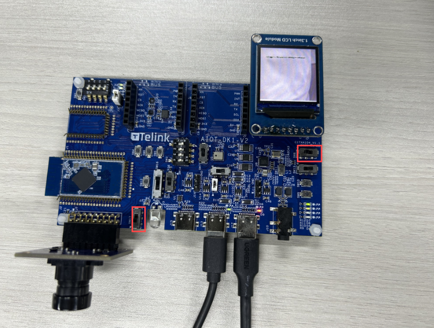

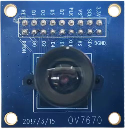

Camera Module
Due to the limitation of the quantity of IO, only the TL721x big module can support Camera.
Select Camera_Demo project in the TL721x project in tl_platform_sdk, compile and burn the target file to the module with the following physical connection:
Hardware Notes:
J2and mikroBUSJ6to the LCD module andJ7to the camera module. - Set
SW17switch to the lower side and theSW8switch to the left side.
After burning is complete, the screen will display the data captured by the camera in real time.
