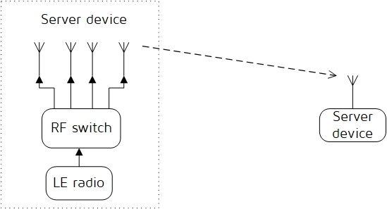

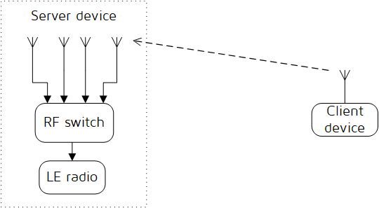

Angle of Arrival (AOA) Method
Client device can make its angle of arrival (AoA) information available to server device by transmitting direction finding enabled packets using a single antenna.
Server device, consisting of an RF switch and antenna array, switches antennae while receiving those packets and captures IQ samples. The IQ samples can be used to calculate the phase difference in the radio signal received using different elements of the antenna array, which in turn can be used to estimate angle.

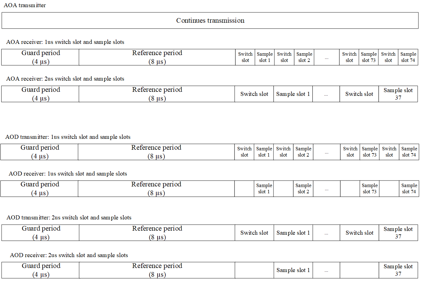

Constant Tone Extension
Constant Tone Extension is specified for AOA AOD feature. The Constant Tone Extension has a variable length; it is at least 16 µs and not greater than 160 µs.
The first 4 µs of the Constant Tone Extension are termed as the guard period and the next 8 µs are termed as the reference period. After the reference period, the constant Tone Extension consists of a sequence of alternating switch slots and sample slots, each either 1 µs or 2 µs long as specified by the Host. The structure of the Constant Tone Extension is shown in the figure below.
Antenna Switch
The device switches between the antennas either while receiving the AoA Constant Tone Extension or while transmitting the AoD Constant Tone Extension. The switching takes place during time periods called switch slots. The first 4 µs of the Constant Tone Extension are termed as the protection period and the next 8 µs are termed as the reference period. The receiving Link Layer captures IQ samples during the reference period and during time periods are called sample slots.
The first antenna in the pattern will be used during the reference period. The second antenna in the pattern will be used during the first sample slot, the third antenna during the second sample slot, and so on. The same antenna ID may appear more than once in the pattern. The antenna in use will only be changed during the protection period and switch slots.
IQ Sampling
When receiving a packet that contains an AoD Constant Tone Extension, the receiver does not need to switch antennas.
When receiving a packet that contains an AoA Constant Tone Extension, the receiver performs antenna switching at the rate and follows the switching pattern configured by the Host.
In both cases, the receiver takes an IQ sample each microsecond during the reference period and an IQ sample each sample slot (thus there will be 8 reference IQ samples). For 2 µs slots, there are up to 37 IQ samples; for 1 µs slots, there are up to 74 IQ samples. The Controller reports the IQ samples to the Host. The receiver samples the entire Constant Tone Extension, irrespective of length, unless it will conflict with other activities.

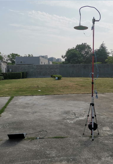

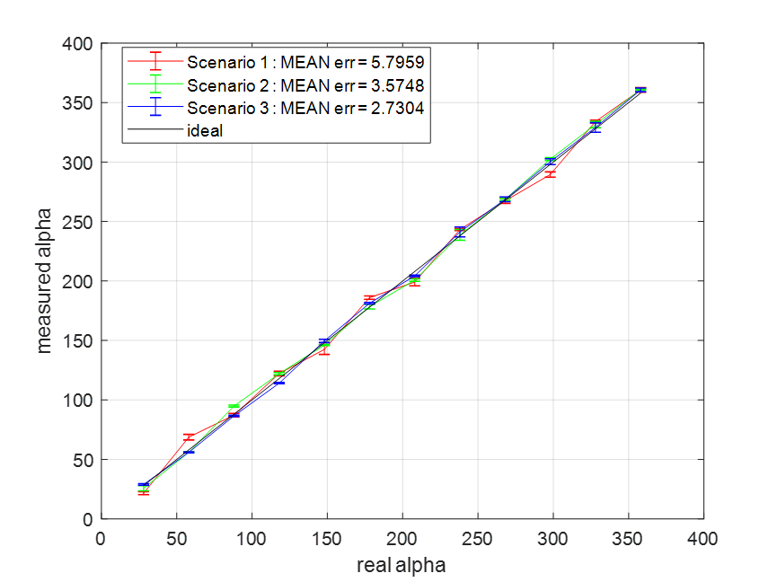

We tested chip 8278 according to spec “RF-PHY.TS.5.1.1”. The chip 8278 passes all AOA/AOD test cases. Here are some details about these test cases.

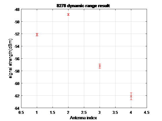

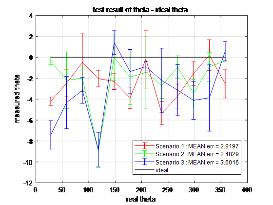

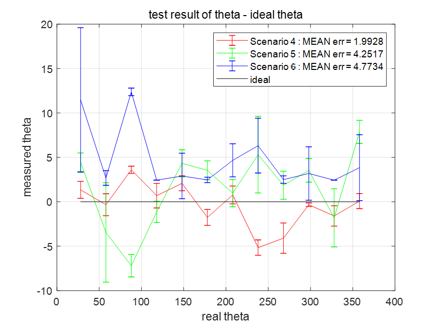

IQ Samples Dynamic Range
In order to implement high order algorithm such as MUSIC, the IQ samples shall show different amplitude corresponding to the received signal strength. The test case in Spec. is transmit -52,-49,-57 and -62dBm signal to Antenna 1, 2, 3 and 4. The Spec. requires MEAN ANT4 < MEAN ANT3 < MEAN ANT 1 < MEAN ANT 2. The ‘MEAN ANT n’ is IQ samples amplitude mean value of antenna n.
Chip 8278 outputs IQ samples with 8 bit precision. The figure shows the mean and STD. The value of IQ sample from different ports sample by sample, are normalized by the reference signal. The resolution of amplitude is less than 1dB.

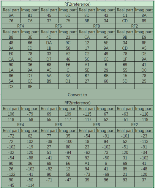

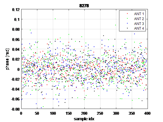

IQ Samples Coherency
In order to calculate phase difference of signal from different antennas to derive angle, the phase of same antenna at different time shall be coherent, and the phase difference from different antennas at different time shall be coherent. See section 5.2 of Core 5.1 for requirement details.

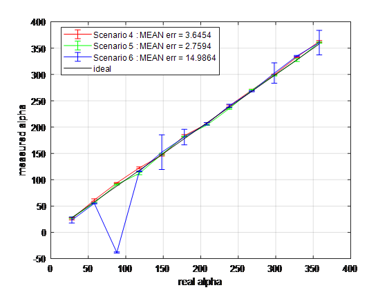

Use power divider to transmit signal to 4 ports of chip 8278, all packet attached with 160µs CW, calibrated cable difference and power divider difference, calibrated initial phase difference with reference signal. The spec requires phase variation (v-MRP) shall be less than 0.52 for same antenna, and phase variation (MRPD) shall be less than 1.125 between different antennas. The STD. value of phase from different ports across packets collected by 8278 are below 0.025 rad. The figure below is the phase of IQ samples from 4 ports.

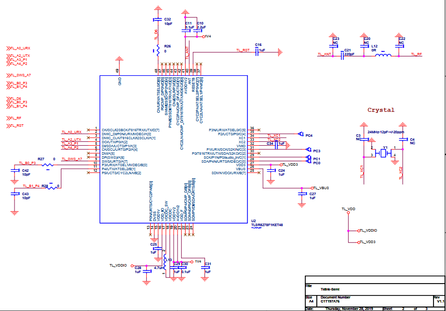

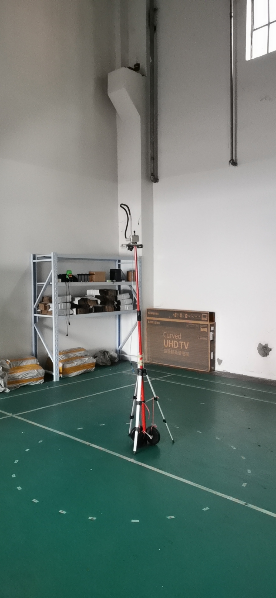

Hardware

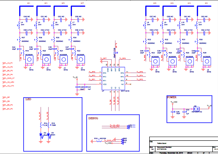

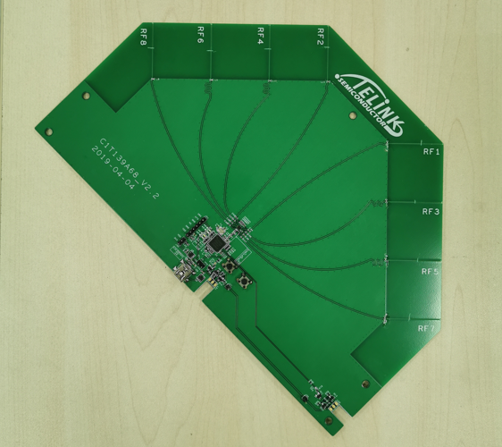

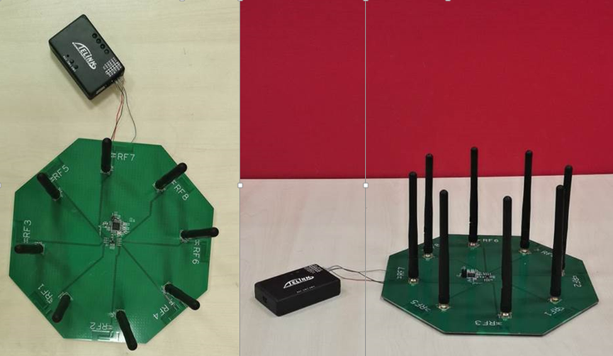

There are 3 selections of reference design, the reference design 1 is for board on the wall and the reference design 2 is for board on the ceiling, the reference design 3 uses PCB antennas as replacement of external antennas in reference design 2.

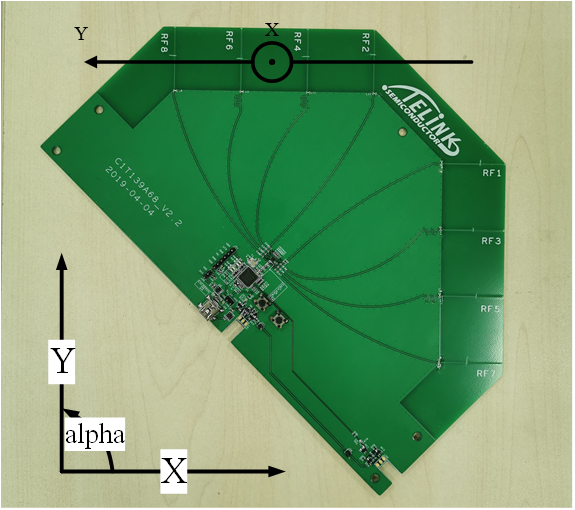

The reference board design 1 is shown in Figure 4.1. The Figure 4.2 shows the illustration of angle. The X axis points to 0 degree while the Y axis points to 90 degree.

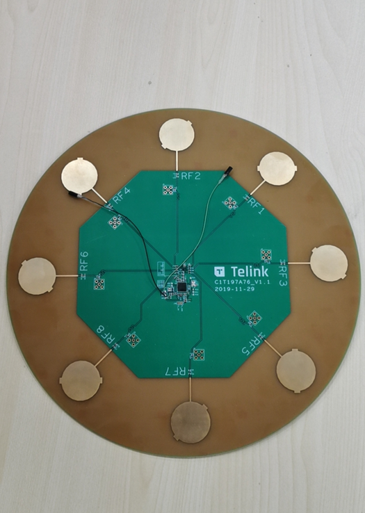

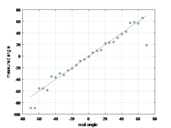

The reference board 2 design is show in Figure 4.3 and the illustration of angle see Figure 4.4. Set RF8-RF1 as x axis pointing to 0 degree while taking RF5-RF4 as y axis pointing to 90 degree.
The reference board 3 design is show in Figure 4.5 and the illustration of angle is the same as reference board 2.

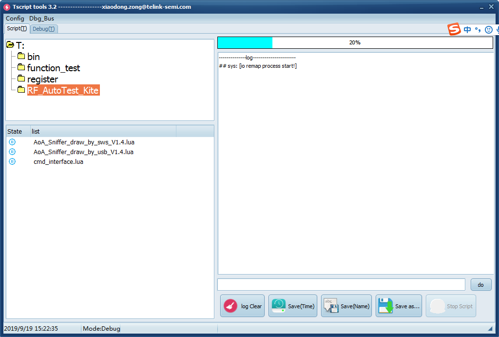

Tscript: http://wiki.telink-semi.cn/tools_and_sdk/BLE/827x_AOA_AOD_Solution.zip

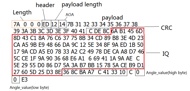

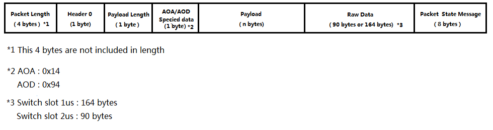

API and Raw Data
At present we put the interfaces for the AOA/AOD transceiver configuration in rf_drv.h and rf_drv.c, while the interfaces for the algorithms related to data splitting and angle calculation are in aoa.c and aoa.h. For this reason, customers need to port the corresponding libdriver.a, rf_drv.h and aoa.h to the corresponding project. The user can set up the AOA/AOD function and configure the number of antennas, switching order, sampling interval, etc. by calling the relevant interface in rf_drv.h after RF initialization. The detailed settings can be adjusted according to your needs in the demo section. In addition, aoa.c and aoa.h provide APIs for calculating the angle information from the packet data and the interface for obtaining raw data.

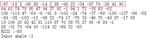

The user can obtain the input angle information by calling unsigned int raw_data_to_angle_no_z(unsigned char *ptr_packet), which returns the value bit plane angle information. The angle information can also be obtained by calling unsigned int raw_data_to_angle_with_z(unsigned char *ptr_packet,unsigned char *temp_theta), which in addition to returning a plane angle, will also output altitude angle information to the temp_theta variable, through which the user can obtain the altitude angle information. Examples are as follows.
unsigned int angle_value;
unsigned char theta_angle;
angle_value = raw_data_to_angle_no_z(&rx_packet[0]);//obtain plane angle information only
angle_value = raw_data_to_angle_with_z(&data_no_amplitude[0],(unsigned char *)&theta_angle);//obtain plane angle and altitude angle

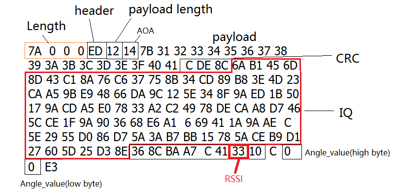

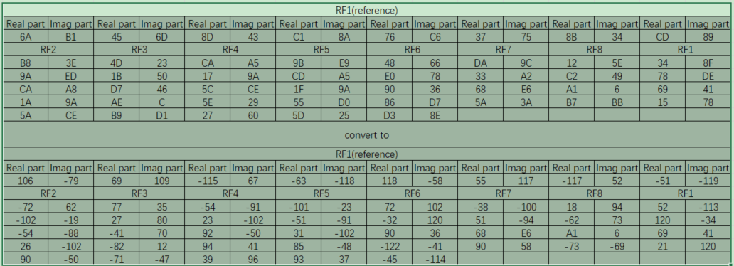

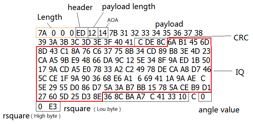

In addition, an interface is provided to obtain raw data, through which the user can obtain the raw IQ data from the receiving end of the packet. The raw data is pre-processed and converted to signed decimal numbers and can then be used by the algorithm to calculate the angle.
unsigned char raw_data[90];
get_raw_data(&raw_data[0],&rx_packet[0],90);
Then raw data is copied to raw_data[0],raw_data[1], raw_data[2] … raw_data[89], which stand real part of IQ0, imaginary part of IQ0, real part of IQ1 …imaginary part of IQ44. User need an unsigned char table which has at least 90 parameters because there are 45 sample data and each data includes real part and imaginary part.

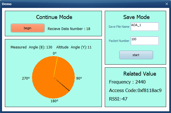

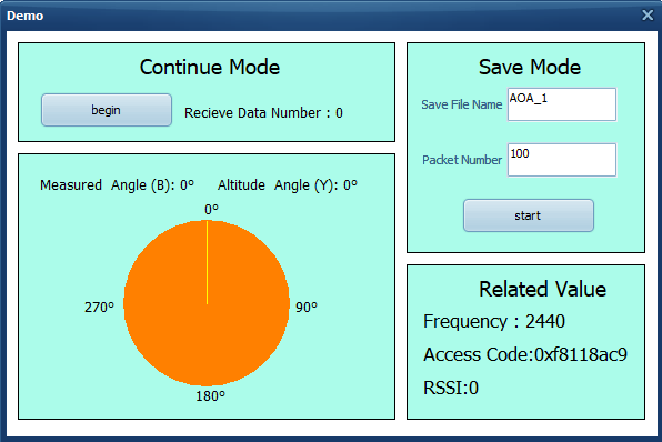

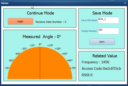

Demo

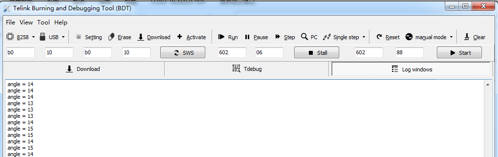

The demo supports the AOA/AOD mode, the customer can choose the mode they use by using the corresponding macro definition. Download the demo program to the reference hardware and the transmitter continuously sends data to the receiver to output the angle. The output angle can be printed via UART, usb to BDT/Tscript or SWS to Tscript. The reference hardware design AOA mode angle output only supports SWS upload to Tscript for output and graphical display.
The demo is currently compatible with the 8278 and 8258 chips, the 8278 will be used as an example when presenting the demo below. The 82xx in the following text can be replaced by 8258 or 8278 depending on the actual situation.

/***************Choose UART output or Tscript output*************************/
#define BY_TSCRIPT 1
#define BY_UART 2
#define USER_MODE BY_TSCRIPT
Output angle information using UART or Tscript.

/**************Script command space*****************/
unsigned char para_buff[commandBuffSize] = {0};
unsigned char temp_para[commandBuffSize] = {0};
When using Tscript for angular display, this space is used for command transmission.

/*******Upload the results to Tscript ********/
unsigned char trans_buff[136] = {0x00};
unsigned char trans_table[10];
It is for uploading data to Tscript.

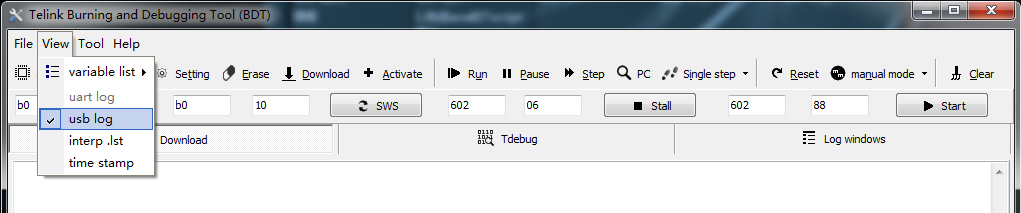

e. Use usb connect multi-antenna RX board to supply power and communicate, then change BDT to usb log mode by View -> usb log as shown in the figure below.
f. Open Log windows. Then user can see input angle once receive AOA packets. Make sure print it out if use print function in program, or program will come out unknown mistake.

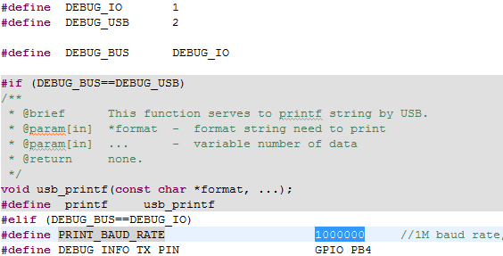

g. If user want to use UART to print, there are some definition need to be changed in drivers/8258/ printf.h. Change DEBUG_BUS as DEBUG_IO, set PRINT_BAUD_RATE and DEBUG_INFO_TX_PIN , then GPIO will emulate UART and print out message with baud rate up to 1000000.

Step1: download specified bin file to the chip. Then connect the board to computer with USB or SWS to power on and communicate. Connect the polygon board to the computer through SWS especially when testing AOA with polygon board since there is no USB on the board.
Step2: open Tscript.exe, double click RF_AutoTest_Kite\AoA.lua as follows. Then the interface is shown as the figure below. Choose AoA_Sniffer_draw_by_sws_V1.4.lua or AoA_Sniffer_draw_by_usb_V1.4.lua according to the different connection mode between the computer and the board.
Step3: choose continue mode or save mode to start, these two modes will be introduced in Section 5.3.2 Continue Mode and 5.3.3 Save Mode.
Continue Mode
The continue mode is designed to show calculation angle result of inner API. The receive board will continually receive data and calculate angle once receiving AOA/AOD data. After average angle data of fixed window, the result will be shown in the interface and the pointer in table will point to corresponding position. In addition, the received packet number and Frequency/Access Code/RSSI will be shown in the interface as follows. The current interface supports the display of height and plane angles.
Save Mode
The save mode is designed to collect AOA/AOD raw data. Click start button after inputting Save File Name and Packet Number. Then user can get Save_File_Name.txt that includes decimal sampled IQ value and Save_File_Name_backup.txt that includes hexadecimal source receive data. Users can use other algorithms to process these data or do other experiment.
Save_File_Name.txt will include decimal sampled IQ value of n packets, in which n is the packet number set by user. Each packet contains 45 groups including 90 numbers corresponding to 45 sample point messages. Every group contains two numbers, the first number indicates the real part and the second number represents the imaginary part of sample point. The figure below indicates the slot chart of AoA receiver. In reference period, the chip will sample message every 1µs, obtaining totally 8 groups of number. After that, the chip will sample message in each sample slot, totally 37 groups of number. So each packet includes 37 + 8 = 45 groups for total of 90 numbers.
For example, the above figure indicates one packet of AOA testing containing totally 90 numbers mentioned before. The first line lists 16 numbers sampled in reference period and the sample results are:
-97 – 18i, 2 – 86i, 88 – 14i, 2 + 88i, -90 + 23i, -34 – 97i, 79 – 26i, 41 + 90i
User can also get other 37 sample slot data by this way.

Packet format
This part will introduce packet format and make an example. Packets format are as bellows:
For example, here is a AOA packet of 2µs switch slot received by triangle board (saved by Tscript). If multiple antenna board is a triangle board, it can be analyzed in following way according to packet format. In save mode of solution that we mentioned before, the receiver will call function to calculate angle and rsquare once receiving a AOA/AOD packet, then put it behind rx_packet. Tscript will read total 130 bytes to get them all.
The raw data in rx_packet need to be treated as char variables. So the highest bit is sign bit and lower 7 bits are data bits. They can be transferred to decimal number in standard method. For example, the raw data in the example can be converted as the figure below. The antenna switch sequence is RF2-> RF4 -> RF6 -> RF8.
To make another example, here is a AOA packet of 2µs switch slot received by polygon board (saved by Tscript), it can be analyzed in following way according to packet format. In save mode of solution that we mentioned before, receiver will call function to calculate angle once receiving a AOA/AOD packet, then put it behind rx_ packet. Tscript will read total 130 bytes to get them all.
The raw data in the example can be converted as the figure below. The antenna switch sequence is RF1-> RF2-> RF3-> RF4-> RF5-> RF6-> RF7-> RF8.
The value of RSSI represents the signal strength of receiving data. We can get the RSSI value from the packet. The data which get from packet minus 110 (D) is RSSI. For example, the data is 0x33, 0x33 minus 110 is -59. So RSSI is -59.

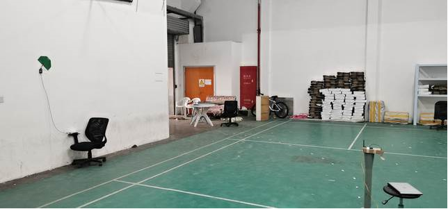

Field Test Result
Field Test Result of Reference Board 1
The indoor test environment is shown in the Figure 6.1. The multiple antenna side can switch antenna to transmit or receive constant single tone. It is placed 2 meters high from the ground attached to the wall. At the other side, a single antenna BLE modular is placed 5 meters away from the multiple antenna side. It is tested by 5 degrees step. The result is shown in Figure 6.2.
The following figure is the test result for various scenarios which indicates the mean of absolute value of error versus real angle. The height of reference board 1 is 1 or 2 meters and the height of single antenna BLE module is 1 meter. The distance from wall to the single antenna dongle is 0.5, 1, 2, 3 or 5 meters respectively following the below test.

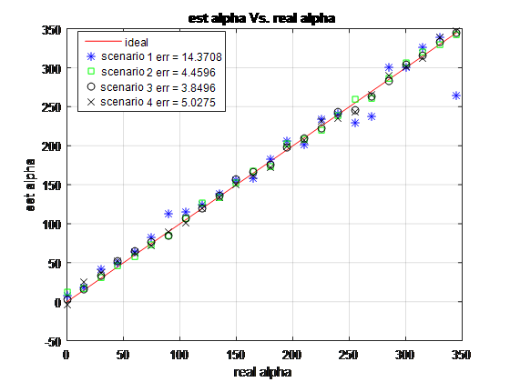

Field Test Result of Reference Board 2
The indoor test environment is shown in the Figure 6.4. The multiple antenna side can switch antenna to transmit or receive constant tone extension. It is hanging on the bracket which is 1.8 meter high. The other side is a single antenna BLE modular, placed on the floor or 0.9 meter high marked as H, 1 or 2 meters far from the bracket marked as D. It is tested by 5 degrees step. The result is shown in Figure 6.5 and Figure 6.6.
Scenario 1: D = 1, H = 0;
Scenario 2: D = 2, H = 0;
Scenario 3: D = 1, H = 0.9;
Scenario 4: D = 2, H = 0.9.
The angle of alpha and theta is measured simultaneously.
Field Test Result of Reference Board 3
The test environment is shown in the Figure 6.7. The multiple antenna side can switch antenna to transmit or receive constant tone extension. It is hanging on the bracket which is 2.5 meter high. The other side is a single antenna BLE modular, placed on the floor or 1.0 meter high marked as H, 1 or 2 meters far from the bracket marked as D. It is tested by 5 degrees step. The result is shown in Figure 6.8 to Figure 6.11.
Scenario 3: D = 3, H = 0;
Scenario 4: D = 1, H = 1;
Scenario 5: D = 2, H = 1;
Scenario 6: D = 3, H = 1;
Schematic for Reference Board
