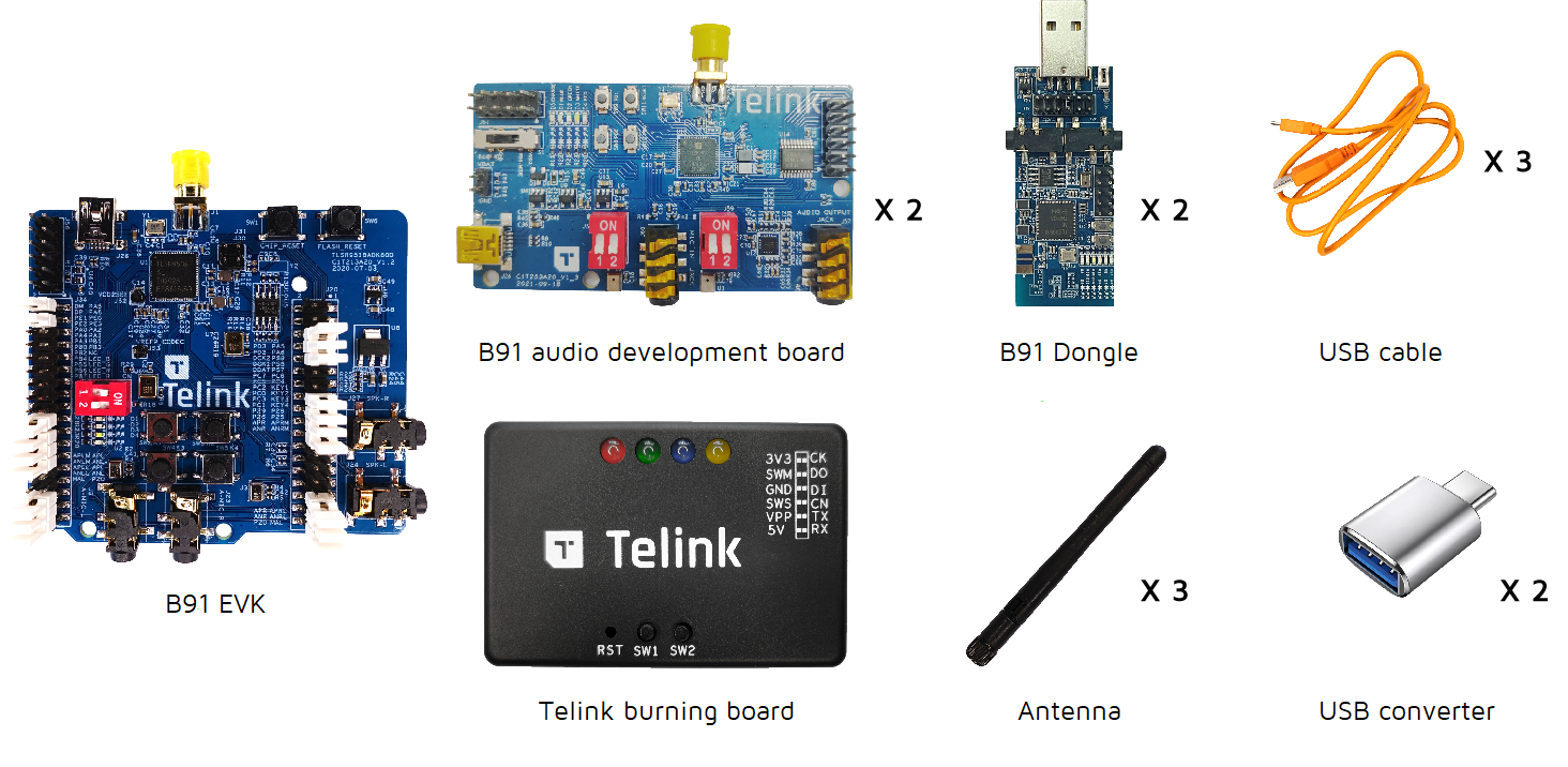

Telink Unicast Audio Kit
Hardware for the kit:
| Category | IC part number | Development board external name | Quantity | Kit accessories |
| Unicast Server | 9517C | B91 audio development board | 2 | USB cable (power) x2, Antenna x2 |
| Unicast Client | 9518A | B91 Dongle | 1 | USB converter x1 |
Purchase on taobao, if it is not already on the shelve, please contact Telink FAE to buy B91 Bluetooth Low Energy (BLE) audio kit.

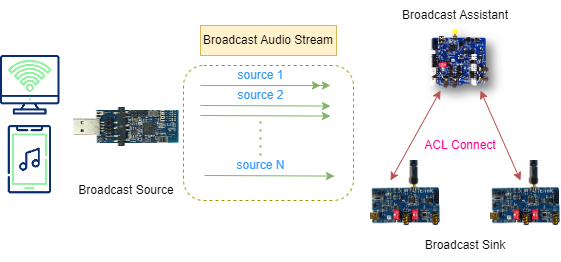

Telink Broadcast Audio Kit
| Broadcast sink | 9517C | B91 audio development board | 2 | USB cable (power) x2, Antenna x2 |
| Broadcast source | 9518A | B91 Dongle | 2 | USB converter x2 |
| Broadcast assistant | 9518A | B91 EVK | 1 | USB cable (power) x1, Antenna x1 |
Purchase on taobao, if it is not already on the shelve, please contact Telink FAE to buy B91 BLE audio kit.

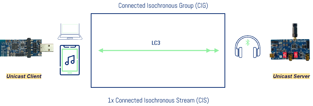

The Unicast Audio Demo is divided into two roles: Unicast Client and Unicast Server.
The B91m BLE Audio SDK v1.1.0.0 extends the usage range of unicast demo, users can simply configure it to achieve:
one-to-one (client to server), typical scenarios include headset.
one to two (client to server), typical scenarios include TWS.
Freely configurable audio uplink and downlink sampling rates of 16kHz/24kHz/32kHz/48kHz.
Mulplixing of audio data is that multiple channels of audio data are transferred on a single channel.

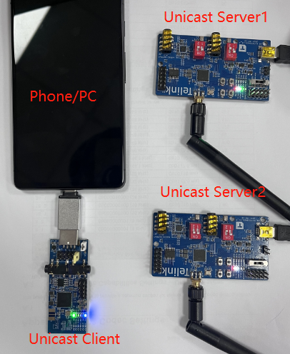

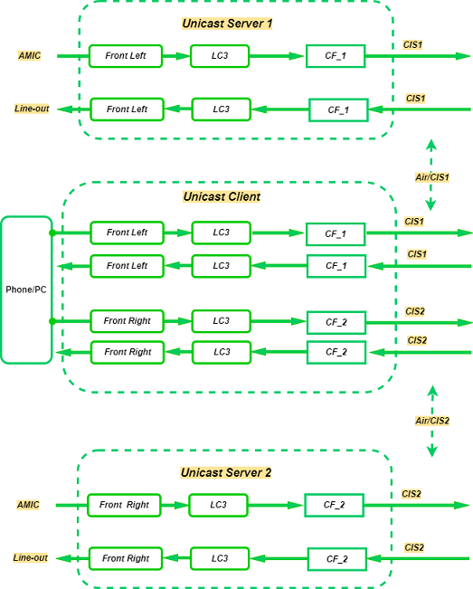

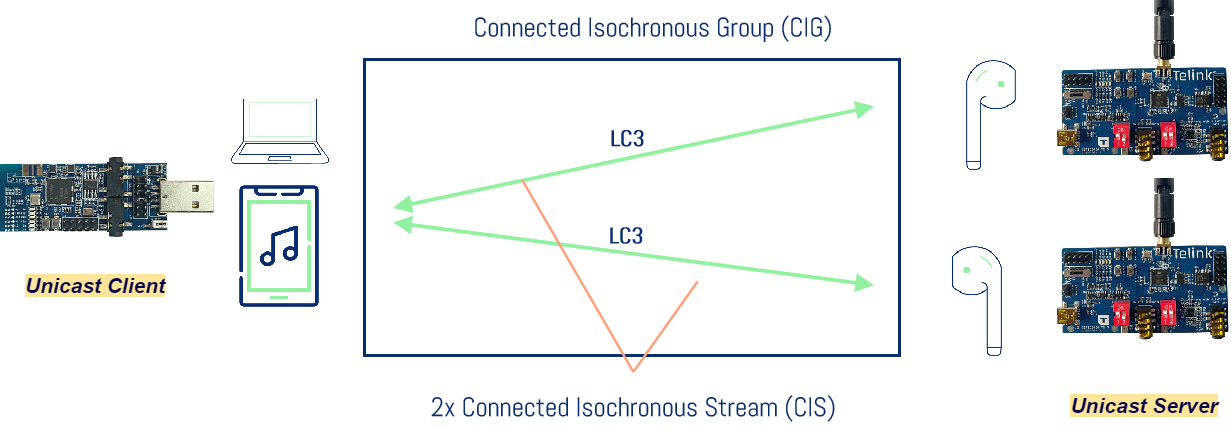

Unicast Demo Scenario 1
One unicast client to two unicast servers, with an uplink dual channel 16kHz sampling rate and a downlink dual channel 48kHz sampling rate, as shown in the above figure.
Development board for the kit:
| Unicast Client | 9518A | B91 Dongle | 1 | - |
Scenario Introduction
As a unicast client, B91 dongle establishes audio channels with two unicast servers respectively.
As the USB device, the B91 dongle acquires 48kHz dual channel audio data from the USB host (phone/PC connected to dongle), and sends the left and right channels to the two unicast servers respectively after LC3 compression.
After the two unicast servers obtain the audio data from the audio channel established with the unicast client, the mono data is played through the local Line-out.
The two unicast servers capture the 16kHz ambient sound data locally via AMIC and send it to the unicast client via the audio channel established with the unicast client.
After the B91 dongle receives the 16kHz mono channel data transmitted by the two unicast servers, it synthesizes the 16kHz dual channel data locally, and it acts as a USB Mic device to send the data to the USB host.
Note:
The Telink B91 dongle acts as a USB device that transmits 16kHz dual channel audio data to the USB host (phone/PC), some USB hosts may use one channel, and some USB hosts may use two channels.

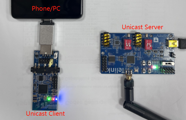

Operating Steps
Step1: Burn the unicast client firmware into a TLSR9518 dongle and connect it to the phone/PC via USB.
Step2: Burn unicast server firmware into two TLSR9517C audio boards (select left and right ear respectively), and power them via USB.
Step3: Press SW2 button on the dongle to pair, the dongle connects to one unicast server device, then it will automatically search and connect to another unicast server via the coordinated set CSIP protocol.
Step4: Play music or open the recording on the phone/PC to test the audio uplink and downlink channel.
Note:
Before the firmware is burned, please erase the whole flash (for B91 chip, it can be selected to erase 2048KB).
TLSR9518 Dongle UI
Press SW2 button to actively search for unicast server device and pair it.
Press SW7 button to unpair (need to be in connected state).
LED red breathing light, flashing once every second.
LED blue indicates that dongle has established a Bluetooth ACL connection with the server.
LED green indicates that dongle has established a Bluetooth CIS audio channel with server.
TLSR9517C Audio Board UI
SW8, SW9, SW10 are customized by users.
SW11 indicates chip reset.
LED green breathing light, flashing once every second.
LED red indicates that server has established a Bluetooth ACL connection with the client.
LED white indicates that server has established a Bluetooth CIS audio channel with client.

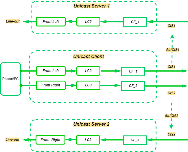

Unicast Demo Scenario 2
One unicast client to two unicast servers, single downlink, dual channel 48kHz, as shown above.

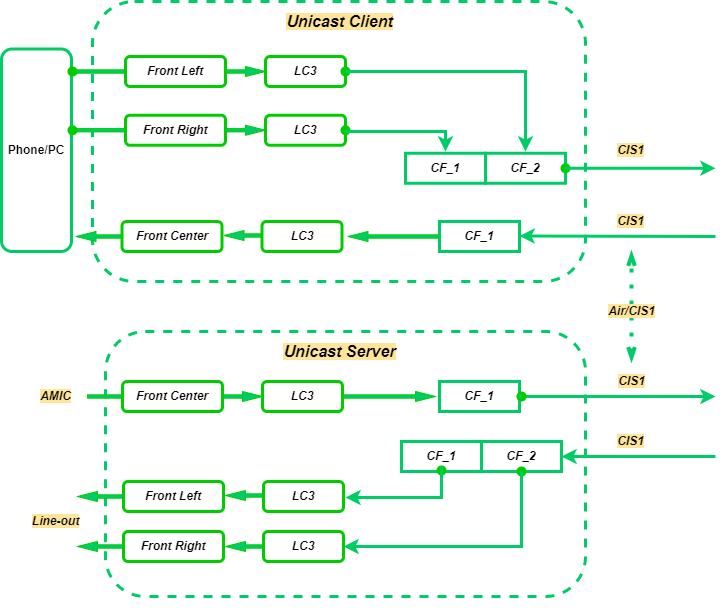

One unicast client to one unicast server, with a downlink 48kHz dual channel and multiplexing technology. One CIS channel transmits two audio data channels, and uplink 16kHz mono channel, simulating headset scenarios, as shown above.
| Unicast Server | 9517C | B91 audio development board | 1 | USB cable (power) x1, Antenna x1 |
As a unicast client, B91 dongle establishes audio channels with one unicast server.
As the USB device, the B91 dongle acquires 48kHz dual channel audio data from the USB host (phone/PC connected to dongle). After LC3 compression, the left and right channels are merged into one SDU and sent to unicast server.
After the unicast server obtains the audio data of two channels from the audio channel established with the unicast client, and then decodes them through LC3 and played through the local Line-out channel.
The unicast server capture the 16kHz mono channel ambient sound data locally via AMIC and send it to the unicast client via the audio channel established with the unicast client.
As a USB Mic device, B91 dongle receives the 16kHz mono channel data transmitted by unicast server and sends it to USB host.

Operating Steps
Step2: Burn unicast server firmware into a TLSR9517C audio board, and power it via USB.
Step3: Press SW2 button on the dongle to pair, and the dongle connects to the target unicast server.
Note:
TLSR9518 Dongle UI

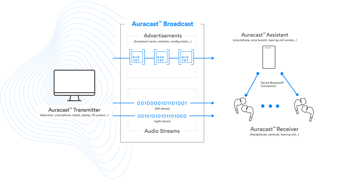

LE Audio introduces broadcast audio to Bluetooth technology, a technology that takes audio communication beyond peer-to-peer communication and enables an audio source device to broadcast audio stream to an unlimited number of nearby Bluetooth audio receiving devices. Broadcast audio is Bluetooth broadcast audio that conforms to a set of prescribed configurations that enable one-to-many audio broadcasting and sharing via Bluetooth technology, providing consumers with a new, globally interoperable audio experience.
The Bluetooth SIG has issued a new trademark for the Bluetooth broadcast audio feature, officially naming the audio sharing feature (part of the Bluetooth LE Audio technology) broadcast audio. The SIG has also issued a trademark guideline document, "Brand Guide for Bluetooth_Jun2022", which requires Bluetooth members to meet the technical requirements of the product must pass the "Public Broadcast Profile (PBP) specification" test, complete the Bluetooth qualification before the use of trademarks, which further ensures the unified interoperability.
A typical scenario of broadcast audio:
The broadcast audio stream from the broadcast source (e.g., smartphone, TV, etc.) and related receiving information include whether the transmission requires secure encryption, the name of the broadcast, the audio encoding method, and other information.
The receivers (e.g., headphones, earbuds, hearing aids, etc.) can search for various broadcast sources to send audio streams as well as receive information and receive transmissions.
The control assistant searches for Auracast broadcast and provides the user a user interface (UI) where they can choose to connect to Auracast broadcast. In practice, the broadcast control assistant can be a device like a smartwatch or a separate remote control, the purpose of which is to make it easier and faster for the end user to search for or select broadcast audio. After selecting the transmission on the control assistant, the control assistant will notify the receiver (e.g., headphones, earbuds, hearing aids, etc.) how to access the transmission, thus eliminating the process for the receiver to search or select. This is important for receiver devices (e.g. earbuds, hearing aids, etc.) that have a simple control interface.
Broadcast Demo Scenario 1
The broadcast sink synchronizes the source information through the asynchronous connection of the broadcast assistant.
| Broadcast Sink | 9517C | B91 audio development board | 2 | USB cable (power) x2, Antenna x2 |
| Broadcast Source | 9518A | B91 Dongle | 2 | - |
| Broadcast Assistant | 9218A | B91 EVK | 1 | USB cable (power) x1, Antenna x1 |

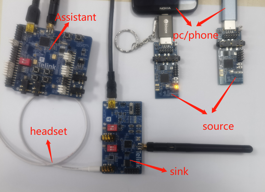

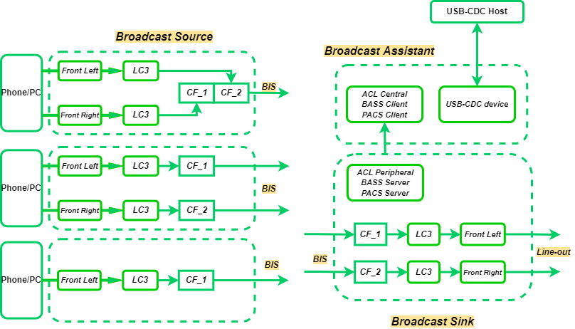

As a broadcast source, the B91 dongle broadcasts BIG (Broadcaster Isochronous Group) audio to the air. There are N sources broadcasting BIG information in the air. Source 1 has one BIS (Broadcaster Isochronous Stream) that transmits two audio channels; source 2 has two BIS, each transmitting one audio channel; and source N has one BIS that only transmits one audio channel.
There is an asynchronous connection between broadcast assistant and broadcast sink, and assistant selects which source to synchronize for the sink through the asynchronous connection. In this scenario, the assistant provides the USB-CDC interface for configuration instructions.
B91 dongle, as a broadcast source device, is configured as a USB device to obtain 48kHz dual channel audio data from the USB host (phone/PC connected to dongle), and after LC3 encoding, the audio data is transmitted into the air according to different configurations.
As a broadcast assistant device, the B91 EVK is configured as a USB-CDC device, which can communicate with the USB-CDC host (PC using serial port tool software) and receive USB instructions to perform different operations.
The B91 audio development board acts as a broadcast sink, establishing an asynchronous connection with the broadcast assistant device, receiving different instructions from the assistant to synchronize the broadcast source in the air. After the synchronization is established, the obtained audio data will be decoded by LC3 and synchronized to the local Line-out for playback.

Operating Steps
Step1: Burn broadcast source firmware into two B91 dongle and connect to the phone or PC via USB.
Step2: Burn the broadcast assistant firmware into a B91 EVK and connect it to the PC via USB-CDC.
Step3: Burn the broadcast sink firmware into a B91 audio board, power it via USB.
Step4: Follow the assistant's operation steps for pairing and connecting, broadcast synchronization, and volume adjustment.
Step5: Music is played on the phone or PC, and the sink can hear the music being played.

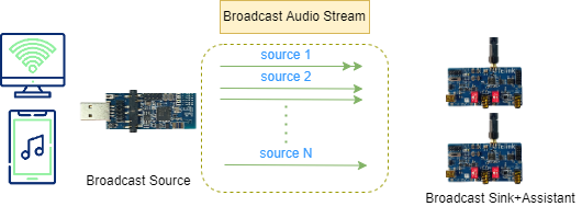

Broadcast Demo Scenario 2
The scenario integrates the sink and assistant functions in one demo, and the user can select to synchronize the source information directly through the buttons on the B91 audio development board.
| Broadcast Sink+Assistant | 9517C | B91 audio development board | 2 | USB cable (power) x2, Antenna x2 |

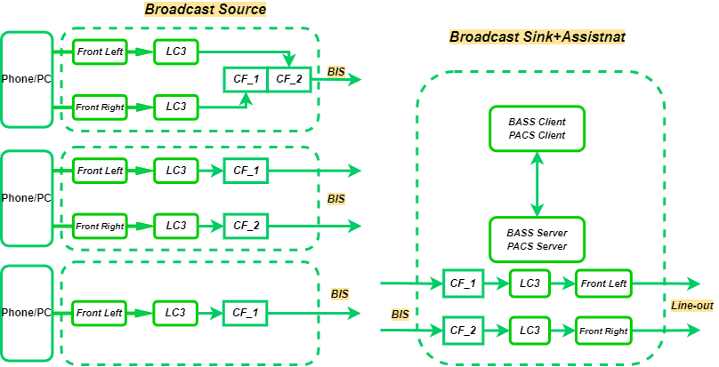

As a broadcast source, the B91 dongle broadcasts BIG audio to the air. There are N sources broadcasting BIG information in the air. Source 1 has one BIS that transmits two audio channels; source 2 has two BIS, each transmitting one audio channel; and source N has one BIS that only transmits one audio channel.
Broadcast assistant and broadcast sink are integrated in the B91 audio development board. When powered on, it will automatically scan the corresponding broadcast source information in the air, and the assistant UI is simplified to using buttons to trigger synchronization of the new source.
The B91 audio development board acts as a broadcast sink and broadcast assistant, after power on, the broadcast assistant function will automatically scan the broadcast source in the air. When the user uses the button to trigger the broadcast source synchronization, the broadcast source synchronization function of the broadcast sink is enabled. After the synchronization is established, the obtained audio data will be decoded by LC3 and synchronized to the local Line-out for playback.

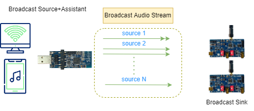

Broadcast Demo Scenario 3

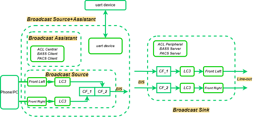

The scenario integrates the source and assistant functions in one demo, and the user can choose which sink device to synchronize the audio through the UART interface.
| Broadcast Source+Assistant | 9518A | B91 Dongle | 2 | - |
The B91 dongle acts as a collection of broadcast source+assistant, broadcasts BIG audio to the air. There are N sources broadcasting BIG information in the air. Source 1 has one BIS that transmits two audio channels; source 2 has two BIS, each transmitting one audio channel; and source N has one BIS that only transmits one audio channel.
There is an asynchronous connection between broadcast assistant and broadcast sink, and assistant selects which source to synchronize for the sink through the asynchronous connection. In this scenario, the assistant provides the UART interface to configure instructions.

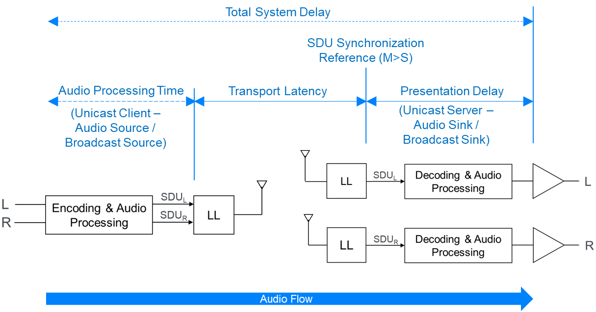

System Delay
Compared to Classic Bluetooth audio, BLE audio has the protocol layer advantage in terms of delay. The system delay source and composition of BLE audio typical scenarios are analyzed below.
It can be seen from the above figure that the total delay of the system consists of three parts:
Audio Processing Time
Transport Latency
Presentation Delay
Audio Processing Time is referred to as T_proc.
Taking the unicast scenario as an example (broadcast and unicast scenarios are basically the same), the audio processing time is mainly composed of the following parts, as shown below:
- Audio capture time: T_capture
The audio capture time is a fixed time, if the SDU interval is 10ms, the capture time is fixed at 10ms, if the SDU interval is 7.5ms, the capture time is fixed at 7.5ms.
- Audio codec time: T_coder
The codec time of audio is mainly affected by two factors:
(1) The amount of data per frame
The amount of data per frame is affected by factors such as sampling rate, bit width, frame length, etc.
(2) The data processing capability of the device
Mainly reflected in the computing power of the CPU, which is affected by the device clock frequency.
- Processing time and transmission wait time: T_wait_1 and T_wait_2
After a frame of audio data is captured, it needs to be processed before encoding and decoding, such as left and right channels (if any) extraction, software program running time, etc., which introduces the waiting time T_wait_1.
After a frame of audio data is captured, it cannot be sent immediately after encoding, and it needs to wait until the next packet sending time, which introduces the waiting time T_wait_2.
As can be seen from the above description, the audio processing time is mainly composed of three parts:
T_proc = T_capture + T_coder + T_wait_1 + T_wait_2
T_capture is the audio data capture time, fixed to SDU_Interval.
T_coder is mainly affected by device performance, and strong CPU performance can shorten the time.
T_wait_1 and T_wait_2 are the software running time and the logic null waiting time, with the greatest flexibility.
Transport Latency
Transport Latency is referred to as T_trans.
The audio data is sent from the link layer of the sending end to the link layer of the receiving end, and the time from sending to receiving is fixed. Taking central to peripheral and the data format is unframed as an example, the specific calculation formula is as follows:
T_trans = CIG_Sync_Delay + (FT-1)*ISO_Interval + (ISO_Interval÷SDU_Interval-1)×SDU_Interval
CIG_Sync_Delay is a delay introduced to synchronize multiple CIS within the same CIG.
ISO_Interval can be considered as a CIS Interval.
SDU_Interval is the generation time of SDU, if SDU_Interval = 10ms means there is a SDU generated every 10ms.
FT is a SDU that can be transmitted within a maximum of several ISO Intervals.
For the specific meanings of the above parameters, please refer to "Core_V5.4", Vol 6, Part B.
In short: Once the negotiated CIS link between CIS central and CIS peripheral is established, the transport latency between the two is determined.
Presentation Delay
After the receiver receives the SDU reported by the controller, it needs to be processed by the software, decoded by LC3, and then sent to the codec at a fixed time for playback, which introduces the presentation delay, or T_pres for short.
Audio System Delay
From the above analysis:
T_system_delay = T_proc + T_trans + T_pres
that is,
T_system_delay = T_capture + T_coder + T_wait_1 + T_wait_2 + T_trans + T_pres
T_capture is the audio capture time, fixed as SDU_Interval.
T_coder and T_pres are related to the LC3 codec time, mainly related to CPU performance.
T_wait_1 and T_wait_2 are mainly related to the software architecture, a good software architecture can minimize the time.
T_trans is mainly related to FT, that is, the number of retransmissions. The less ISO_Interval that one SDU is transmitted in, the shorter transport latency is.
From the above analysis, it can be seen that if the total system delay is to be reduced, the measures that can be taken are:
(1) Shortening SDU_Interval can shorten T_capture and T_trans.
(2) Using a CPU with stronger computing power can shorten T_coder and T_pres.
(3) Depending on the specific project, using an efficient software architecture can minimize T_wait_1 + T_wait_2 and T_pres.
(4) Reduce the FT, and shorten the number of retransmissions as much as possible while ensuring the quality of the wireless transmission.

Assistant Command Set
All control commands for the Broadcast Assistant need to end with "\r\n" (ASCII: 0x0d 0x0A). In the following description of the commands, this will not be repeated.

This section takes one assistant, two sinks and two sources as an example to explain how to configure different source information for the two sinks.
Basic information of the sinks:
sink 1:
- public address: 12:34:56:00:00:00
- Device name: Telink-BIS-SINK
sink 2:
- public address: 12:34:56:00:00:01
Basic information of the source:
source 1:
- public address: 12:34:56:00:01:00
- Device name: Telink-BIS-SOURCE
source 2:
- public address: 12:34:56:00:01:01

[10:38:50.751]recv: sink PA state is Sync
BIS Synced state is 0x00000000
[10:38:50.930]recv: sink PA state is Sync
BIS Synced state is 0x00000003
//Synchronize the left channel audio of Source 1;
[10:38:59.580]send: add-source 1 1 1
[10:38:59.585]recv: started add source
[10:38:59.690]recv: sink PA state is Loss
[10:38:59.810]recv: Sink no any Sync Source Info
[10:39:00.231]recv: sink PA state is Sync
[10:39:00.291]recv: sink PA state is Sync
BIS Synced state is 0x00000001
//Synchronize the left channel audio of Source 2;
[10:39:03.709]send: add-source 1 2 1
[10:39:03.714]recv: started add source
[10:39:03.830]recv: sink PA state is Loss
[10:39:03.950]recv: Sink no any Sync Source Info
[10:39:04.430]recv: sink PA state is Sync
[10:39:04.551]recv: sink PA state is Sync
//Synchronize the right channel audio of Source 1;
[10:39:08.837]send: add-source 1 1 2
[10:39:08.841]recv: started add source
[10:39:08.990]recv: sink PA state is Loss
[10:39:09.110]recv: Sink no any Sync Source Info
[10:39:09.531]recv: sink PA state is Sync
[10:39:09.650]recv: sink PA state is Sync
BIS Synced state is 0x00000002
////Synchronize the right channel audio of Source 2;
[10:39:12.597]send: add-source 1 2 2
[10:39:12.602]recv: started add source
[10:39:12.711]recv: sink PA state is Loss
[10:39:12.890]recv: Sink no any Sync Source Info
[10:39:13.250]recv: sink PA state is Sync
[10:39:13.430]recv: sink PA state is Sync
