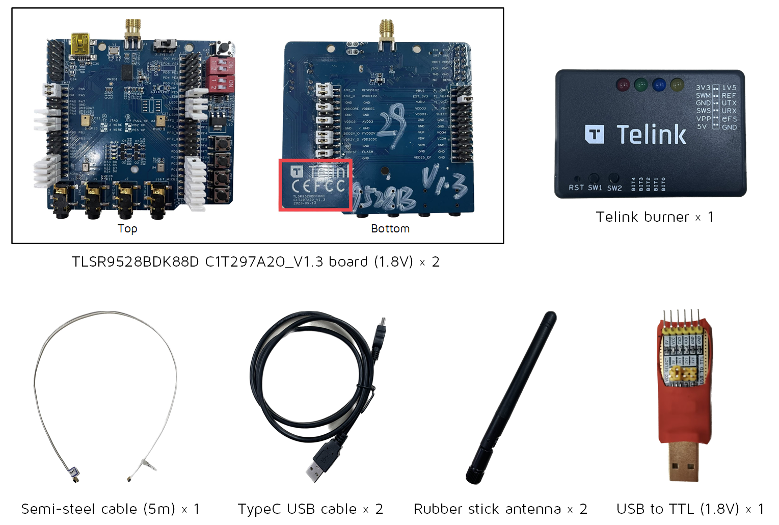

Hardware and Software Requirement
Telink channel sounding development kit
  • Burning Tool (Telink BDT)
  • RISC-V TDB
  • Serial terminal
  • SDK

  • The channel sounding development kit has two roles: cs_acl_central (CS role is initiator by default) and cs_acl_peripheral (CS role is reflector by default).
  • The test has two modes of signal transmission: semi-steel cable and rubber stick antenna.

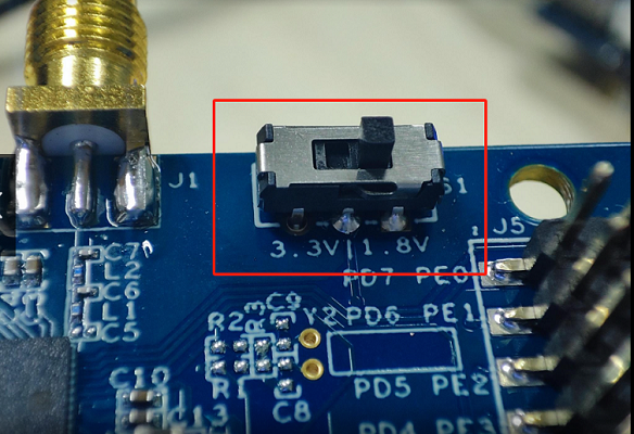

(1) Select 1.8V on the development board.

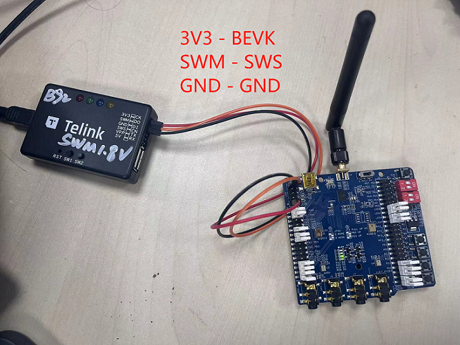

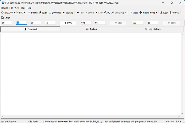

(2) Use the BDT to burn the development boards separately.
The burned file is:
cs_acl_central_xxx.bin: build from the cs_acl_central project.
cs_acl_peripheral_xxx.bin: build from the cs_acl_peripheral project.
The two ends of the Telink burner are connected to the PC and development board respectively, and the bin file is burned from BDT to the development board through Telink burner.
BDT connection reference
The picture above is for reference only, the actual product may have updated appearance.

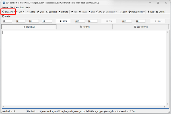

Note:
Select B92_1V8 mode in BDT.
Select B92_1.8V in the BDT
(3) The cs_acl_central_xxx.bin is burned into the initiator device and cs_acl_peripheral_xxx.bin is burned into the reflector device. After burning, the blue light will flash on the initiator device, and the green light will flash on the reflector device.
(4) To prevent the current from returning, after burning, users need to unplug the Telink burner's cable that is connected to the device, and then use USB to power the device.

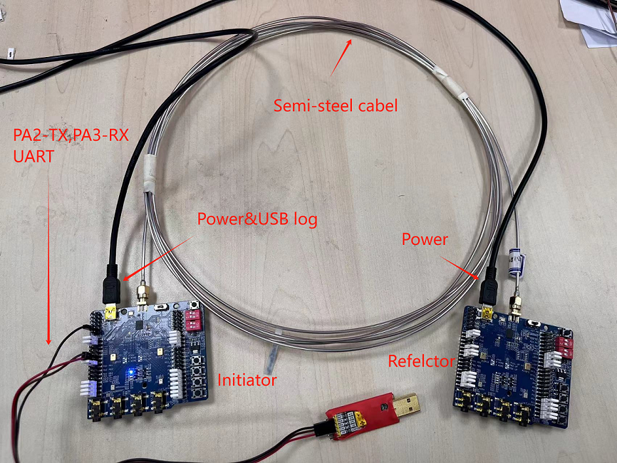

Step 2 Environment Setup
After burning, start setting up the test environment:

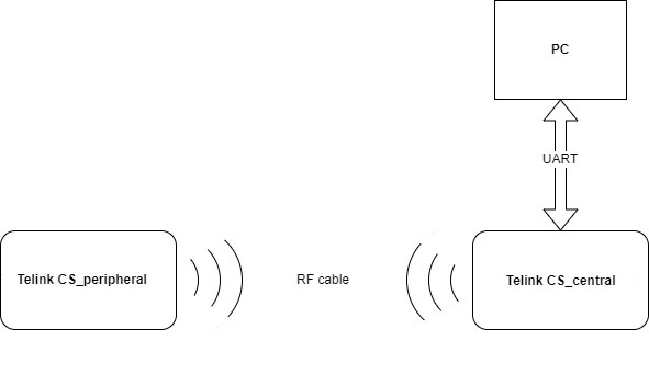

  • Connect the two devices via semi-steel cable (replace the semi-steel cable with rubber stick antenna for RF wireless testing).
  • One end of the "USB TO TTL" converter (with rubber protective sleeve) is connected to the UART pins (UART1_RX_PA3, UART1_TX_PA2, GND) of the initiator device and the other end is connected to the PC.

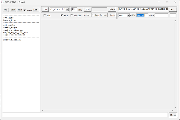

  • The initiator device is connected to the PC via a USB cable, the RISC-V TDB software on the PC will prompt: "Found" and can be log printed, the reflector device can be powered by 5V USB.
As shown in the figure below to set up the test environment.
Test environment setup

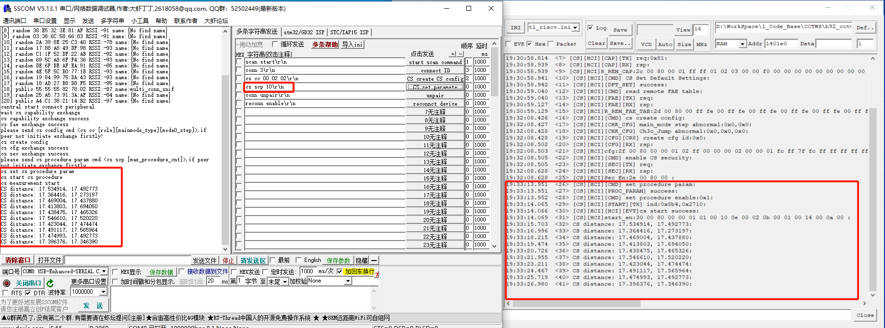

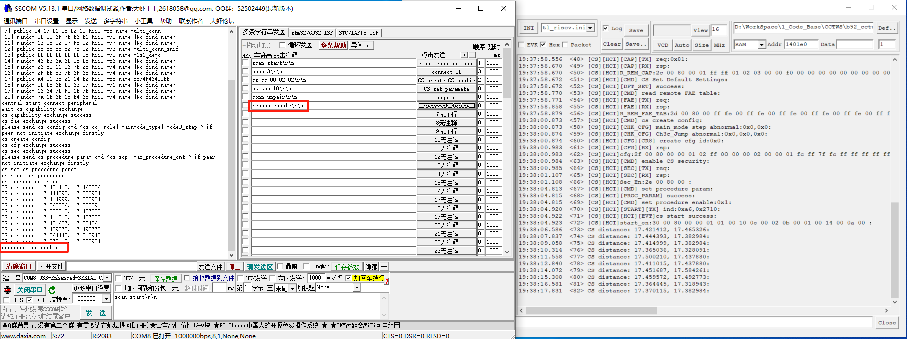

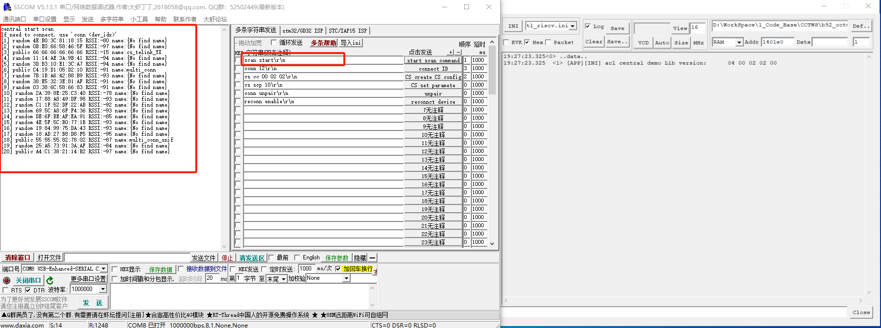

Step 3 Execute Command
After burning, use the serial tool to print the results using the following commands:
(For details of the command, please refer to chapter 3 UART Command)
scan start\r\n           //step1: Start scanning advertising
conn 3\r\n               //step2: Connect device 3: "3" is the mac address index of the desired connected device.
cs cc 00 02 02\r\n       //step3: Create CS configuration to select mainmode and the number of mode0:
                         //"00" means CS initiator role
                         //The first "02" means mainmode2, it can be changed to 01 that means mainmode1
                         //The second "02" means the number of mode0, the range of this option is 01/02/03.
cs scp 10\r\n            //step4: Number of tests: "10" means test ten times, which can be modified to the number of tests required.
reconn enable\r\n        //Step 1 and 2 can be skipped during reconnection, without advertising and connecting again, using the "reconn" command.
During the execution of the above command, the LED status will change with Bluetooth connection and disconnection, the user can judge the LED status by the following table:
Device Chip_Reset Bluetooth connection Bluetooth disconnection
Initiator Blue light flashing Blue light flashing + Red light always on Blue light flashing + White light always on
Reflector Green light flashing Green light flashing + Red light always on Green light flashing

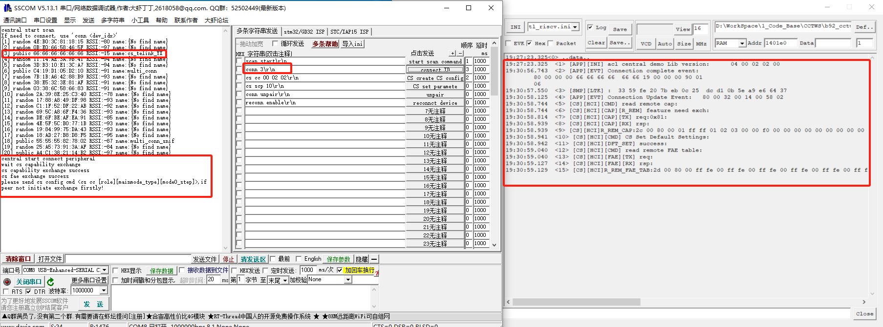

The figure corresponding to each line of code above is as follows, with the serial commands on the left and the corresponding log on the right.
scan start\r\n
scan start\r\n
conn 3\r\n
conn 3\r\n
cs cc 00 02 02\r\n
cs cc 00 02 02\r\n
cs scp 10\r\n
cs scp 10\r\n
reconn enable\r\n
reconn enable\r\n
Log description:
Each log has two values.
  • For Mainmode1: Both values are test results and the values are the same.
  • For Mainmode2: The first value is phase-distance, and the second value is music-distance (they are the results of two different algorithms).

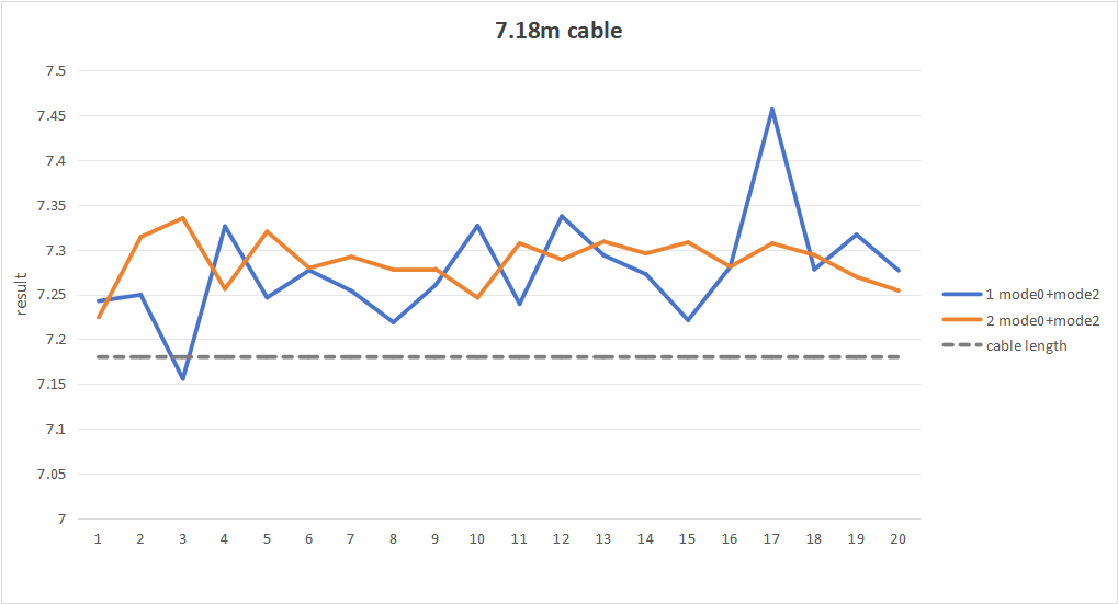

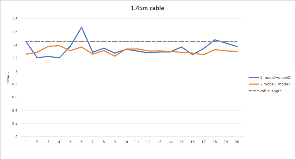

Below is a more visual and detailed waveform of the test results:
Test conditions: mode2, 1.45m cable. (The length here refers to the electrical length, not the physical length)
Waveform result with distance of 1.45m cable
Test conditions: mode2, 7.18m cable. (The length here refers to the electrical length, not the physical length)
Waveform result with distance of 7.18m cable

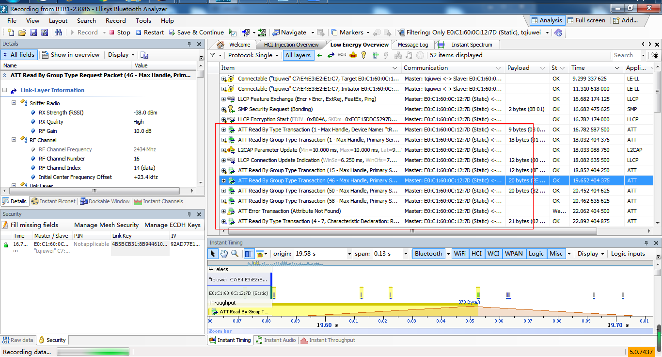

Sniffer of Ellisys
Analyzer Hardware Information
Ellisys

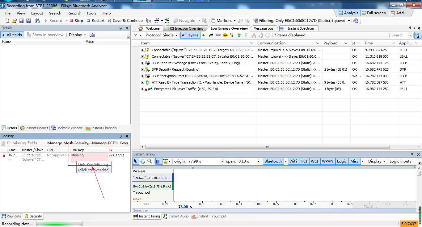

When we use Ellisys to capture packets, decryption failure may happen.
A method to solve this problem: from our equipment for LTK on the log, and then added LTK to the Ellisys, Ellisys can decrypt the packets successfully.
The following are the procedures:

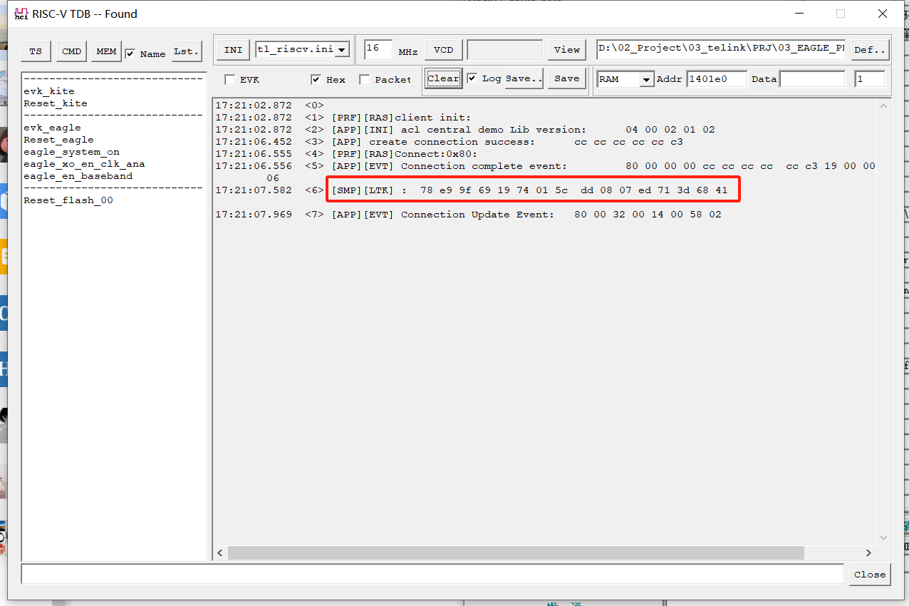

(1) When decryption fails, the user can see the following information:
Decryption failure
(2) Read the LTK from the log or the flash. For example, the CS development kit log will automatically display the LTK after the first pairing or link back, as follows:
Log display LTK

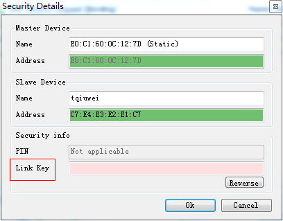

(3) Copy the LTK into Ellisys. Find Ellisys interface as follows: Security | Link Key.
Ellisys interface
Then double-click the Missing, it appears the following interface:
Security details interface
Then paste LTK into the "Link Key" box (try clicking Reverse if you get an error) and click OK.
All the data can be decrypted and seen as shown below:
All data is decrypted
