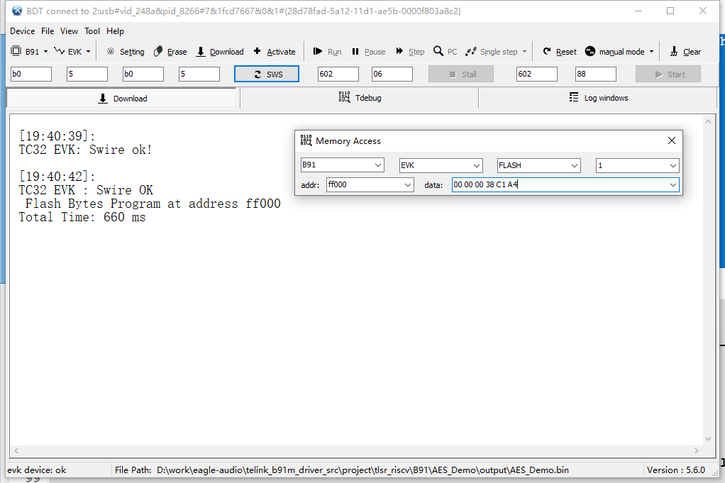

Step 1 Burn the MAC address: 0xA4C138000000, burn it via the BDT tool shown as below:
