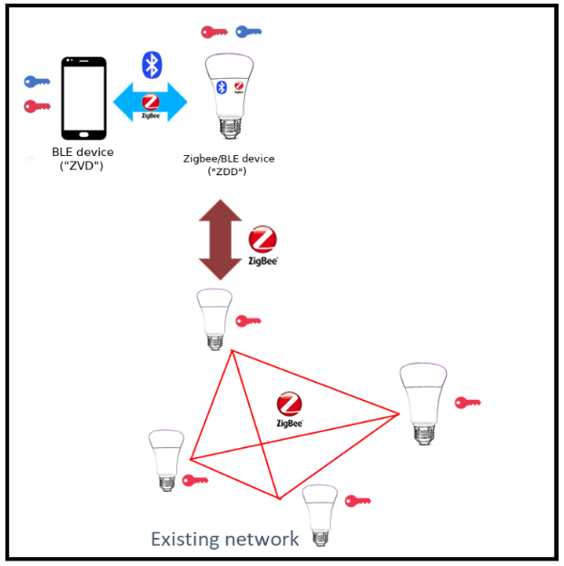

Zigbee Direct Protocol Introduction
The intent of Zigbee Direct is to allow for encrypted and authenticated access to Zigbee devices and networks from Bluetooth Low Energy(BLE) capable devices. This enables devices like smartphones, tablets, smart speakers and hubs to commission and control devices on a Zigbee network.
Typical application of Zigbee Direct

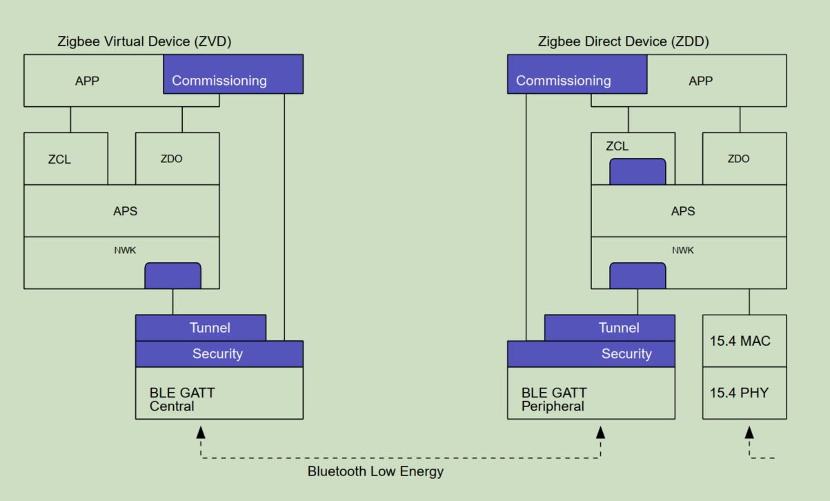

The BLE services included in Zigbee Direct: Security Service, Commissioning Service and Tunnel Service.
Protocol stack overview of Zigbee Direct

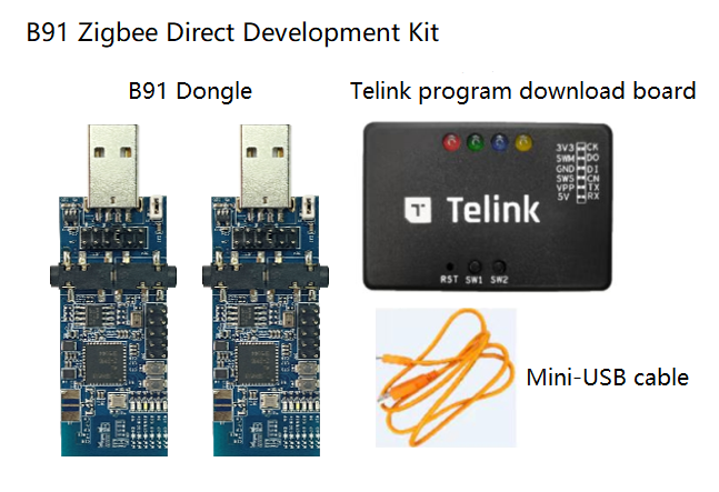

B91 Zigbee Direct Development Kit
B91 Zigbee Direct development kit
Hardware Introduction
Category Chip part number Development board external name Quantity
Zigbee+BLE dual-mode device 9518A B91 Dongle 1
Zigbee single-mode device 9518A B91 Dongle 1
Note:
They can be purchased on Taobao.com. If they are not listed in the store, please contact Telink FAE to buy B91 Zigbee Direct development kit.

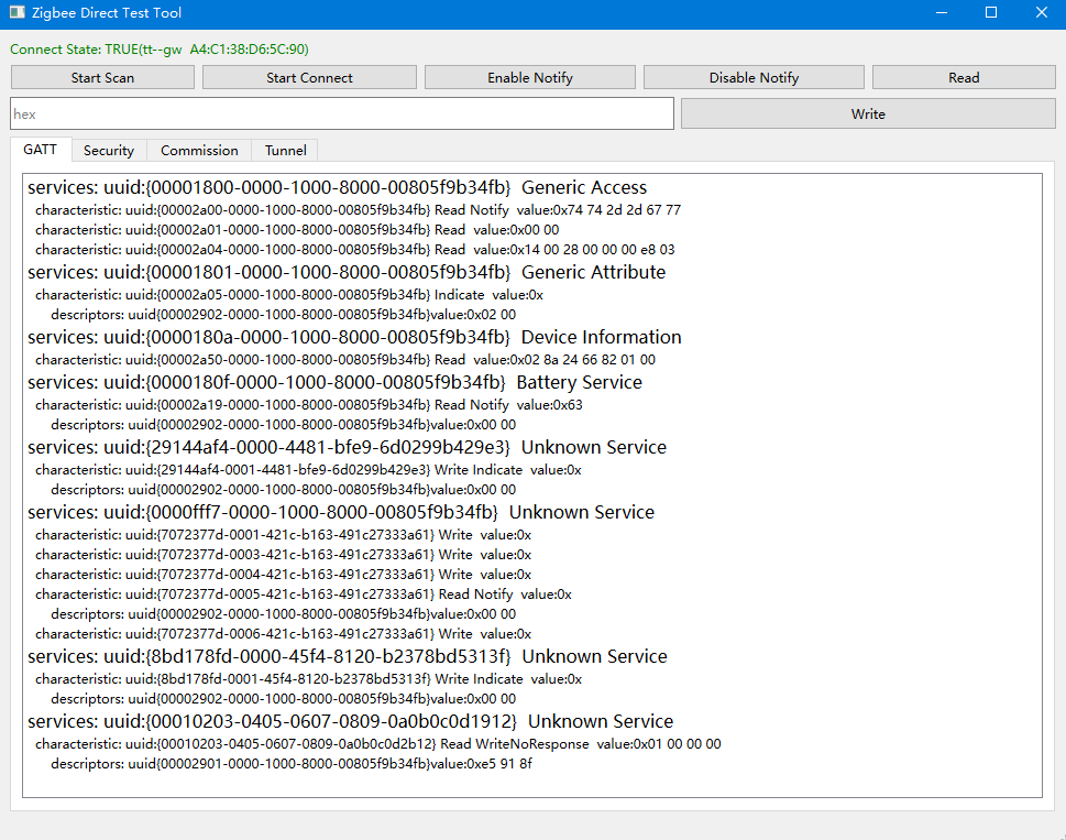

Establish BLE Connection
Open the computer-side test tool-Zigbee Direct Test Tool, click the "Start Scan" button, wait for the scan results, and then select the ZDD device in the scan results, click the "Start Connect" button to initiate the BLE connection. During the connection process, the tool will discover all the attributes of the device, so the connection time will be slightly longer.
BLE connection established successfully

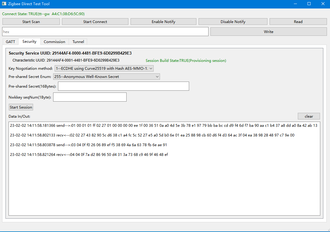

Establish Configuration Session
Switch to the "Security" page, click the "Start Session" button according to the default configuration, establishe configuration session, and negotiate the configuration session key. The "Data In/Out" dialog box displays the interactive data of the session establishment process.
Establish configuration session

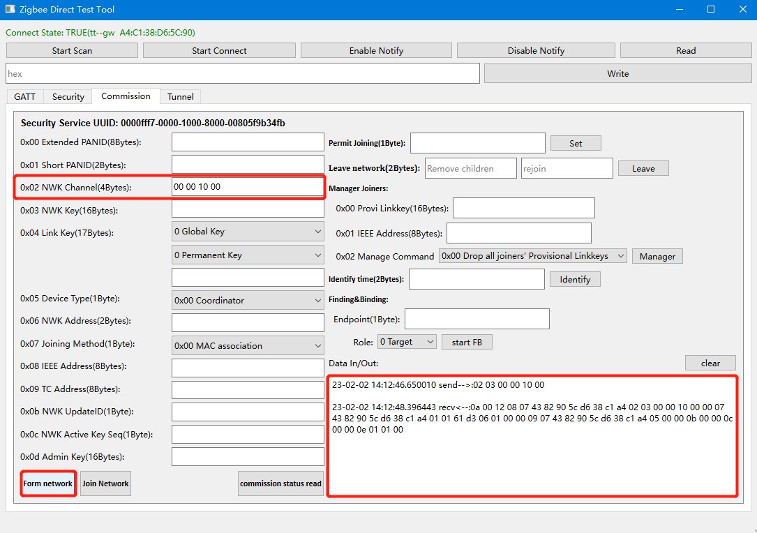

ZDD Form the Network

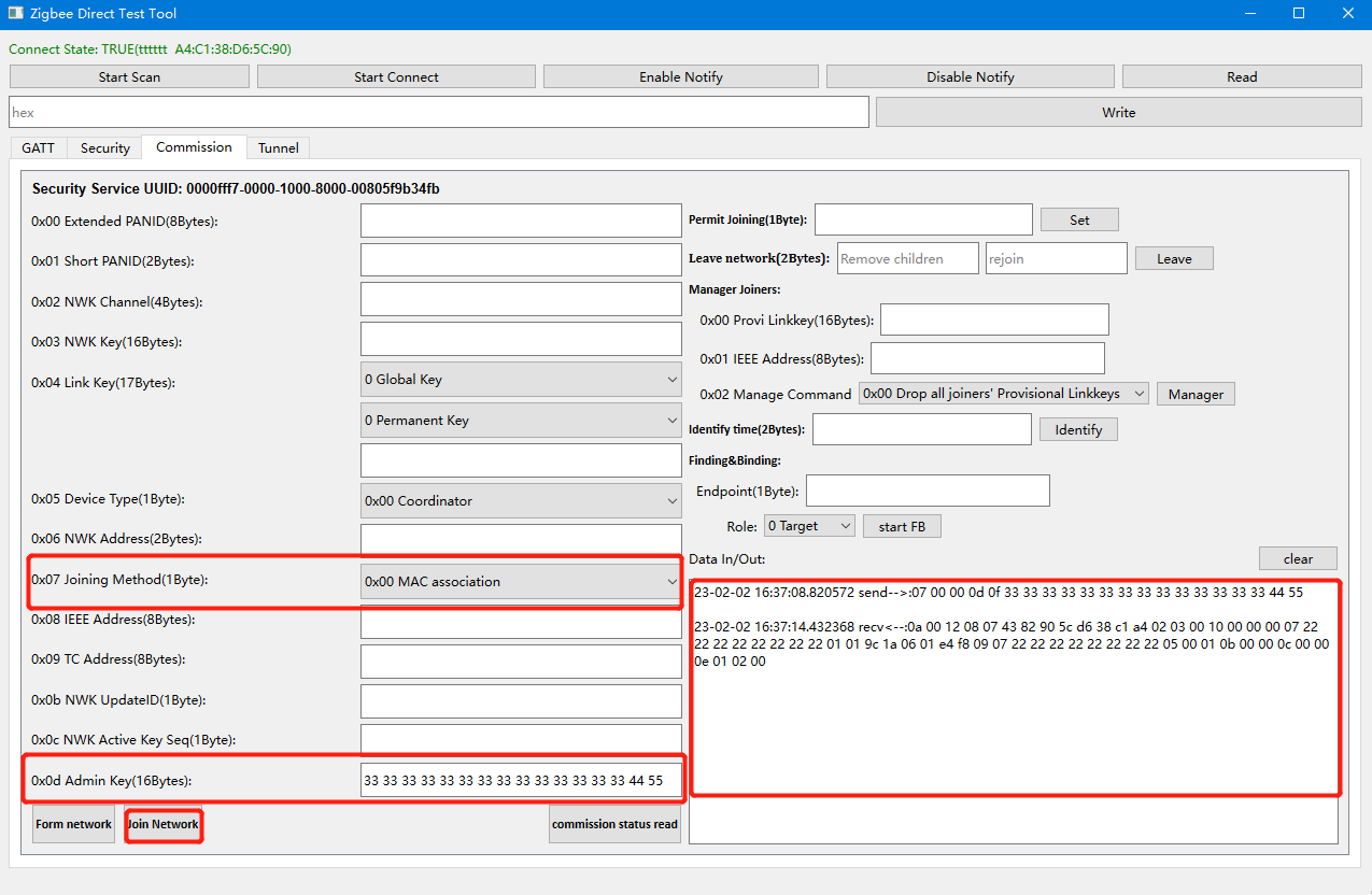

Switch to the "Commission" page, configure the networking parameters in the left area of the page, and then click the "Form network" button to initiate the networking, ZDD will report the networking results and network parameters.
Only "NWK Channel" is configured here, and the communication data is in the "Data In/Out" dialog box.
The networking parameters are packaged using the "TLV" format.
ZDD forms Zigbee network
Name Usage Type ID Length (Byte) Description
Admin Key Optional 0x0d 16 It is used to establish an Admin-level authorization session. If it is not configured, TCLK is used by default in the centralized network. In the distributed network, if it is not configured, the Admin session cannot be established.
Trust Center Address Required(conditionally) 0x09 8 When forming a distributed network, it must be configured and fully ff; If it is a centralized network, it does not need to be configured.
Extended PAN ID Optional 0x00 8 If not configured, the networking device will select a random number.
Short PAN ID Optional 0x01 2 If not configured, the networking device will select a random number.
Network Channel Optional 0x02 4 If not configured, the networking device will scan the full channel to select the working channel.
Network Key Optioanl 0x03 16 If not configured, the networking device will select a random number as the key.
Link Key Optional 0x04 17 If not configured, the pre-install code or the default linkkey will be selected.
NWK Address Optional 0x06 2 NWK Address configuration is ignored in centralized network.
NWK Update ID Optional 0x0b 1 If not configured, 0 is used by default.

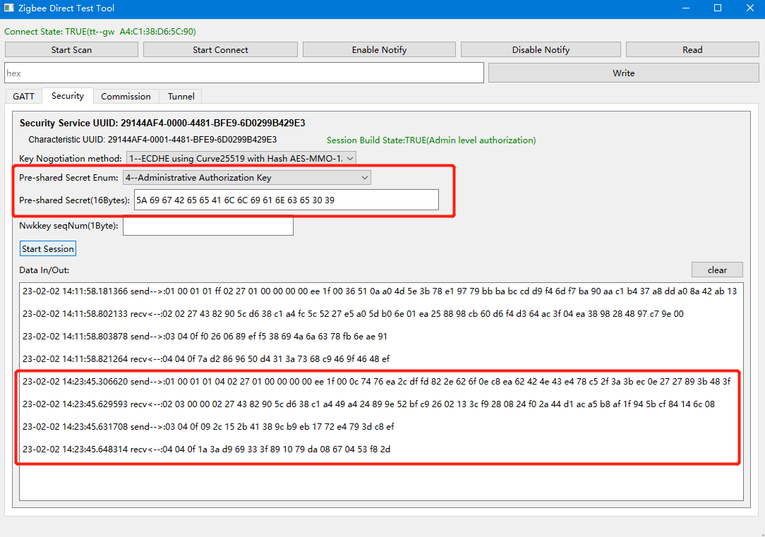

The devices already in the Zigbee network need to be upgraded to the Admin Authorization session and negotiate a new key before subsequent BLE communication.

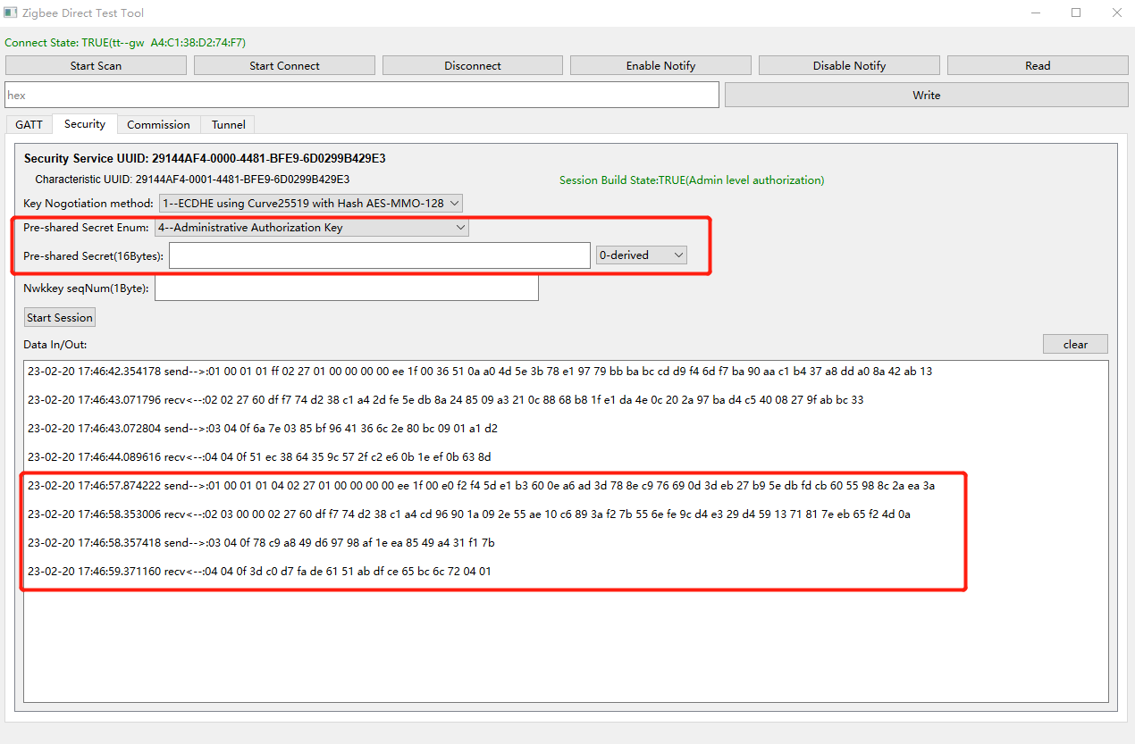

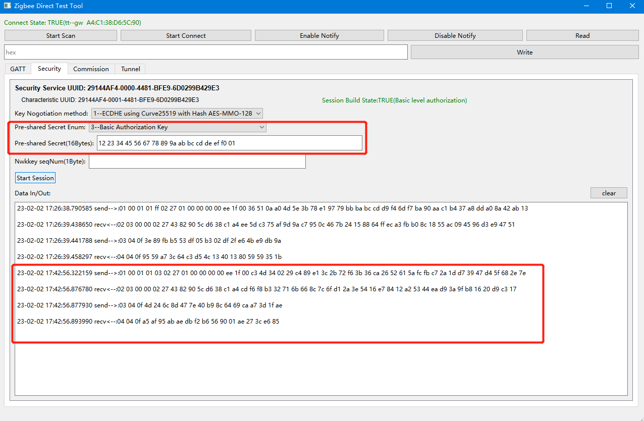

Establish Admin Authorization Session
Because the Admin key is not configured during networking, the coordinator can use the default TCLK(ZigBeeAlliance09: 5A 69 67 42 65 65 41 6C 6C 69 61 6E 63 65 30 39) to derive the Admin key in the centralized network.
The pre-configured key type is selected as "Administrative Authorization Key".
Establish Admin Authorization session

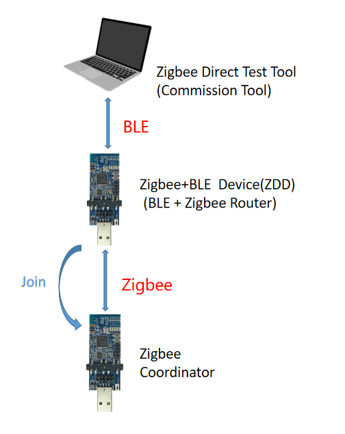

ZDD Joins Existing Zigbee Network
Topology Example
ZDD joins the network topology

Form a Zigbee network
Single-mode Zigbee Coordinator module forms a network, and will allow the switch to join the network to be turned on, the green light on the module will be on.
ZDD Joins the Network
Switch to the "Commission" page, configure the parameters of joining the network in the left area of the page, and then click the "Join network" button to initiate the joining of the network, and ZDD will report the network joining results and network parameters. By default, the switch that allows the ZDD device to join the network is turned off, so the green light will not be on here. "Joining Method" and "Admin Key" (33 33 33 33 33 33 33 33 33 33 33 33 33 33 44 55) are configured here. The communication data is in the "Data In/Out" dialog box.
After joining the network, press the "SW2" button on the Zigbee Coordinator module, the Zigbee Coordinator module will broadcast the on/off command at an interval of 1 second. The red light on the ZDD module will flash along with it, and press the "SW2" button again to stop flashing.
The networking data is packaged using the "TLV" format.
ZDD joins Zigbee network

The devices already in the Zigbee network need to upgrade the session to the Admin Authorization session and negotiate a new key to perform subsequent "Commissioning Service" data interaction.
Since the Admin key has been configured when accessing the network, there is no need to configure it again, and select "Administrative Authorization Key" as the pre-configured key type to establish a session.
Router device establishes Admin Authorization session

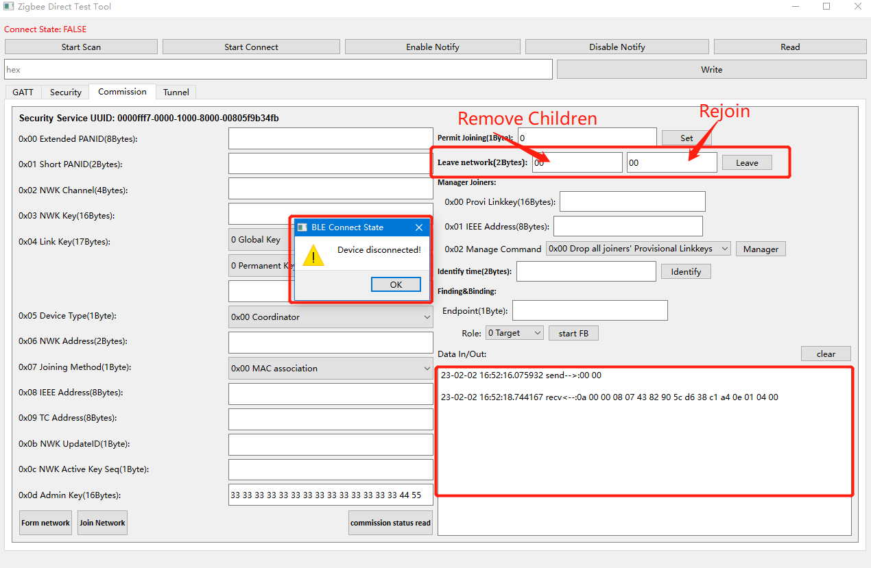

ZDD Device Leaves the Network
On the "Commission" page, use the "Leave network" command to leave the network. After the ZDD device leaves the network, the BLE connection will also be actively disconnected.
ZDD leaves the network

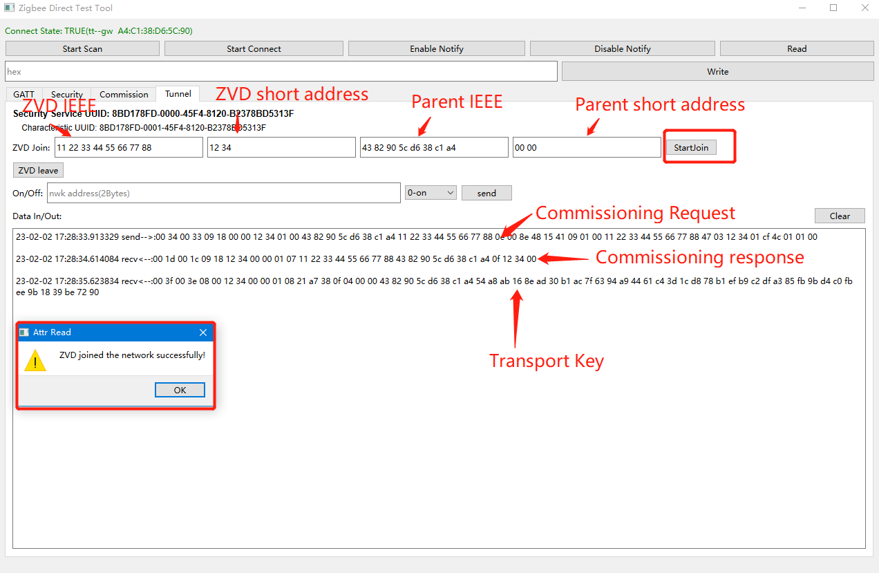

ZVD Joins Zigbee Network
Ensure that the switch of allowing ZDD to join the network has been turned on before ZVD starts to join the network.

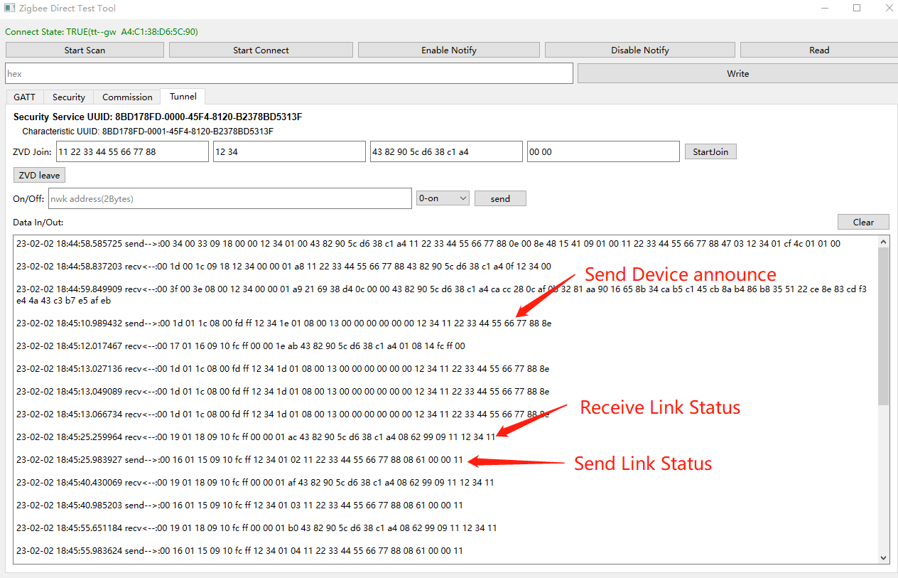

Switch to the "Tunnel" page, set parameters in the input box after "ZVD Join", and then click "StartJoin" to let ZVD join the known network. "ZVD IEEE" and "ZVD short address" are randomly selected and can be specified by users. "Parent IEEE" and "Parent short address" are parameters of the parent node ZDD.
ZVD joins Zigbee network
Establish Basic Authorization Session
The host computer tool switches to the "Security" page, the pre-configured key type selects "Basic Authorization Key", select the network key of the current network as the pre-configured key, and establish the Basic Authorization session.
The pre-configured key can be derived from the "transport key" command data received by the ZVD device when it joins the network. The current tool does not implement this function, so it is entered manually here.
Establish Basic Authorization session
ZVD Device Controls Zigbee Network Device
After the ZVD device joins the Zigbee network and establishes a "Basic Authorization" session, it will send a "Device announce" command once and a "Link Status" command every 15 seconds.
ZVD joins network communication data

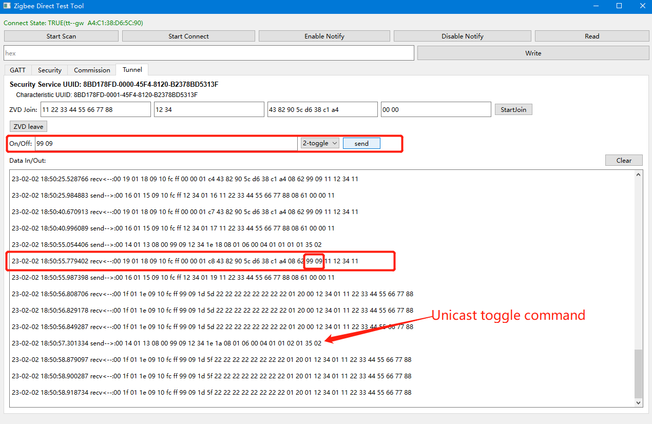

Fill in the address of the device to be controlled in the input box after "On/Off", click the "send" button to send the command, and you can see that the red light on the device will turn off.
ZVD sends unicast data
