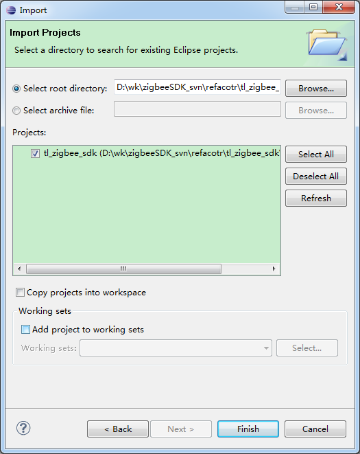

1) Start the IDE and go to the interface File -> Import -> Existing Projects into Workspace in order.
2) Select the project you want to import in tl_zigbee_sdk/build. For example, if you develop on the B85 (TLSR8258) TC32 platform, select tlsr_tc32; if you develop on the B91, TL721x, or TL321x RISC-V platforms, select the corresponding iot_riscv_xx project.
3) Click "Finish" to complete the project import.

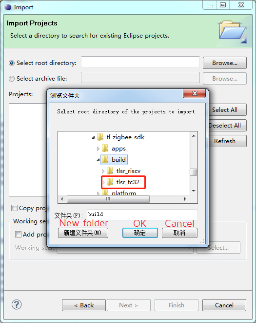

2) Select tlsr_tc32 in the tl_zigbee_sdk/build directory -> click "OK".

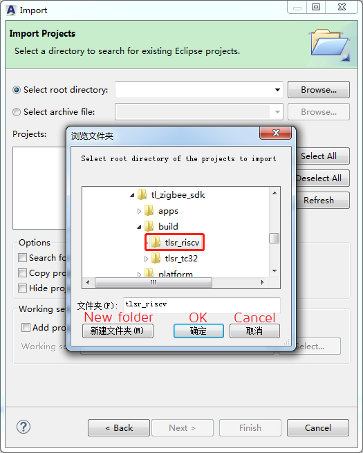

2) Select tlsr_riscv in the tl_zigbee_sdk/build directory -> click "OK".
