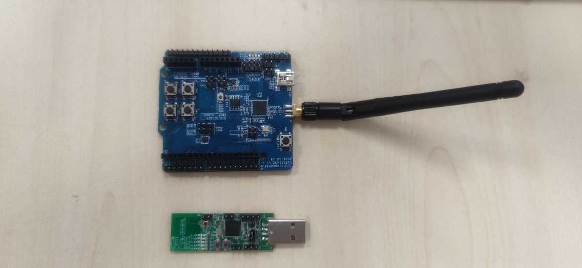

- Test board: TLSR8208ADK56(C1T261A30_V1.1) with TLSR8208AER chip
- SDK: 80_ble_single_connection_sdk(V3.4.1.0)

The Agilent N6705B was used to supply 2.2V and 3.3V to the test board. When the test board was advertising, the Agilent N6705B was used to record the current waveform and data in the advertising state of the test board; the test board was connected to the 8208 dongle and the Agilent N6705B was used to record the current waveform and data in the connected state of the test board.

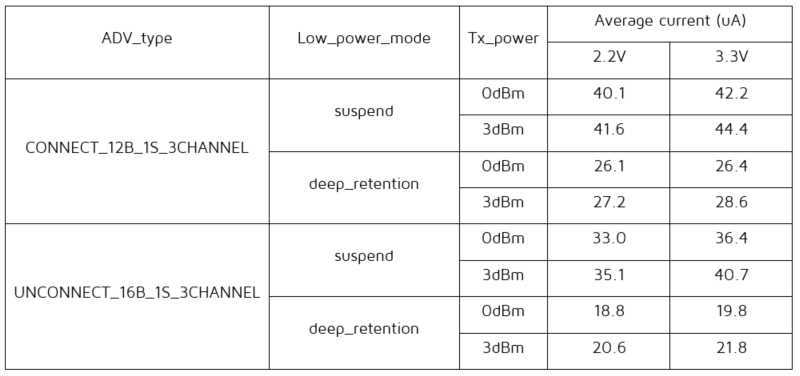

(1) Current test in advertising state
The current test conditions in the advertising state are as follows.
- Power supply: 2.2V, 3.3V
- ADV type: CONNECT_12B_1S_3CHANNEL, UNCONNECT_16B_1S_3CHANNEL
- TX power: 0dBm, 3dBm
- Low power Mode: Suspend, Deep Retention
- 32K clock source: Internal 32KHz RC, External 32KHz Crystal

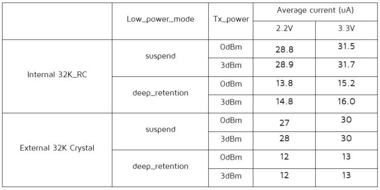

(2) Current test in long connection
The current test conditions in the long connection state are as follows.
- CL (Connection Interval): 10 ms
- SL (Slave Latency): 99
Test in Advertising State
Test condition 1 for advertising state:
- Power supply: 3.3V
- TX power: 3dBm
Test condition 2 for advertising state:
- TX power: 3dBm
- Low power Mode: Deep Retention

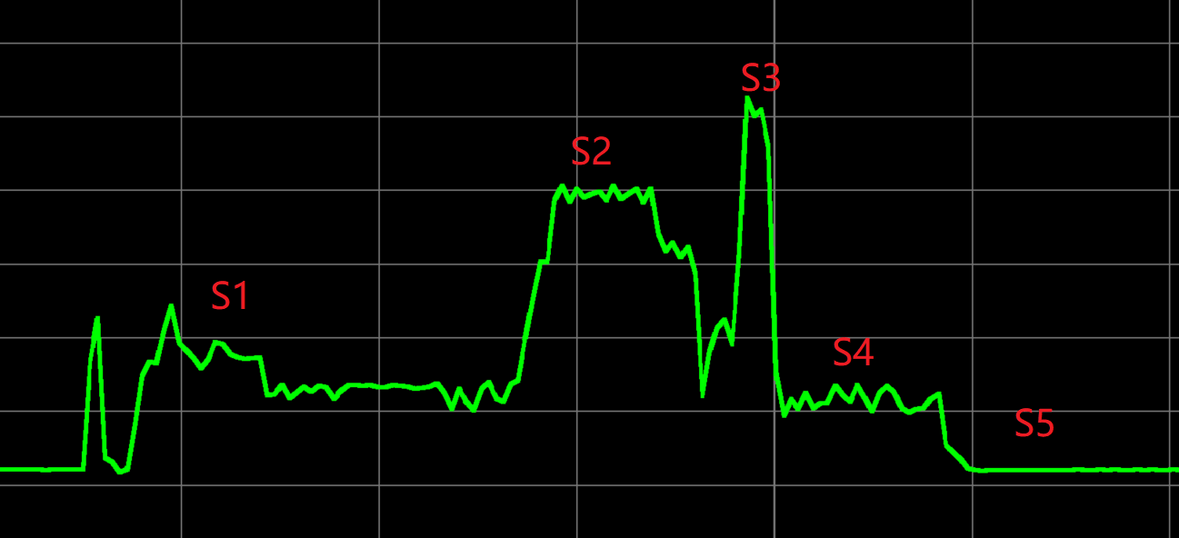

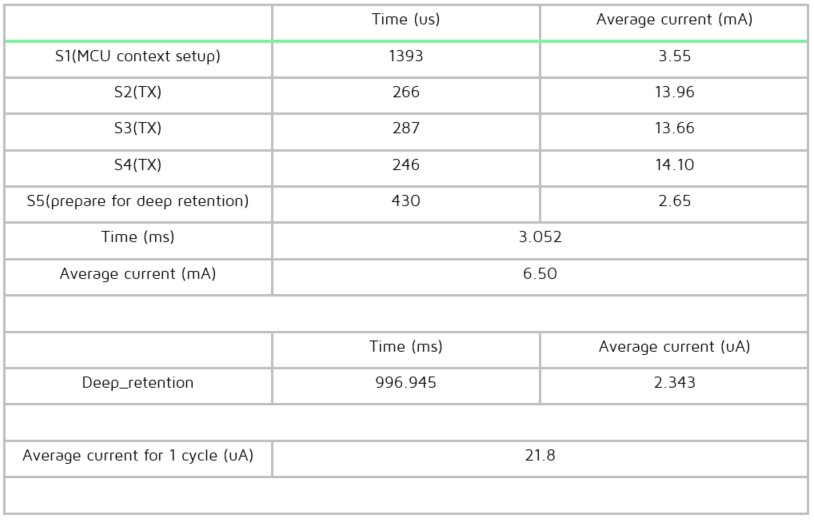

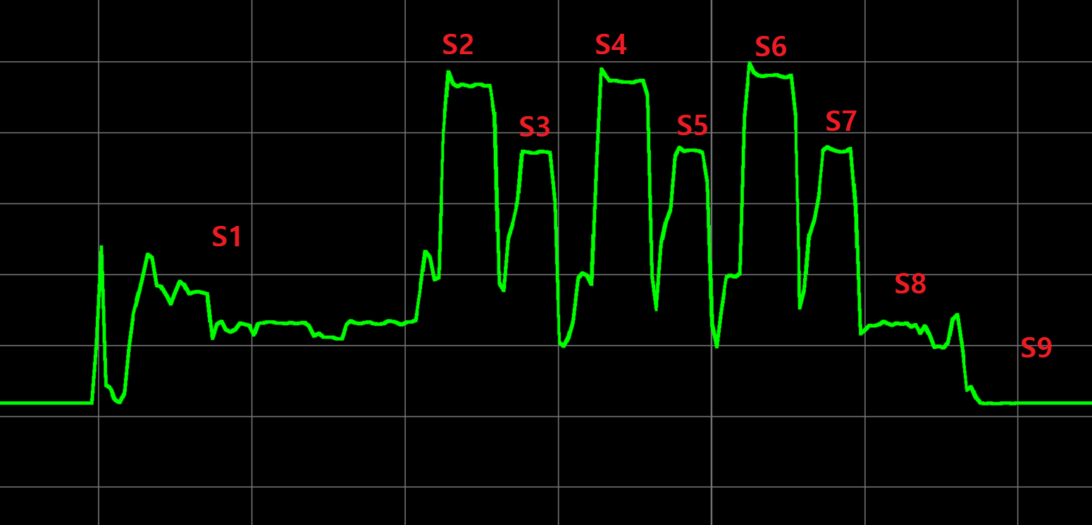

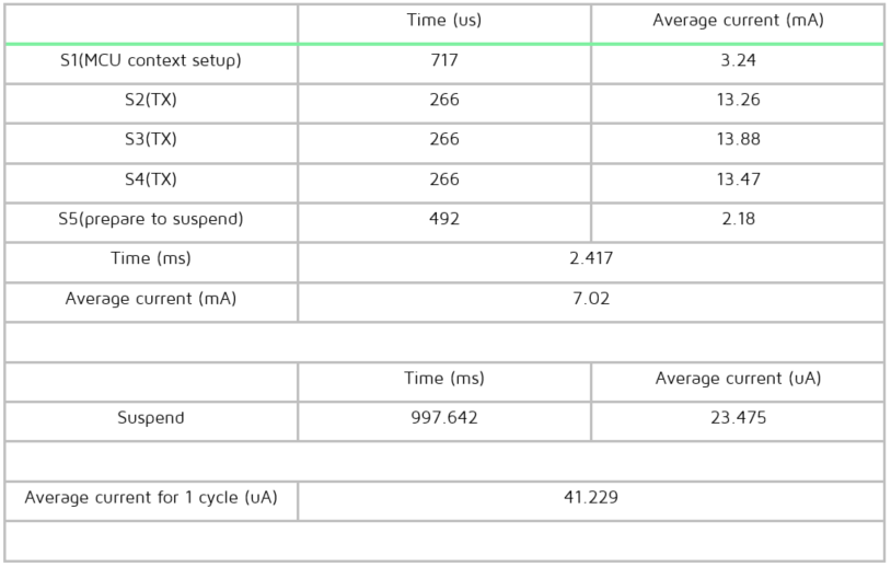

Test condition 3 for advertising state:
- ADV type: UNCONNECT_16B_1S_3CHANNEL
- TX power: 3dBm

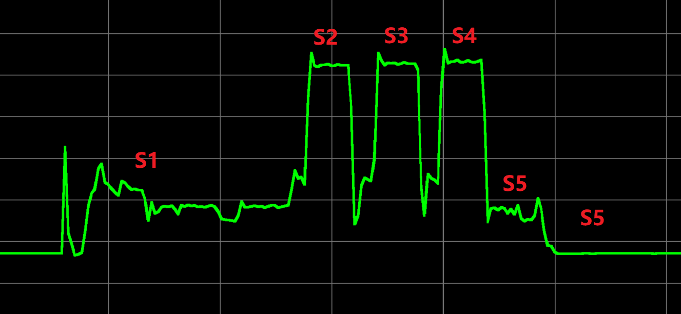

![Current curve for advertising state test condition 3] Current curve for advertising state test condition 3](../pic/currentcurveadv3.png)
Test condition 4 for advertising state:
- TX power: 3dBm

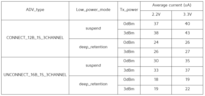

The average current for each test condition in the advertising state with Internal 32K RC are as follows.
The average current for each test condition in the advertising state with External 32K Crystal are as follows.

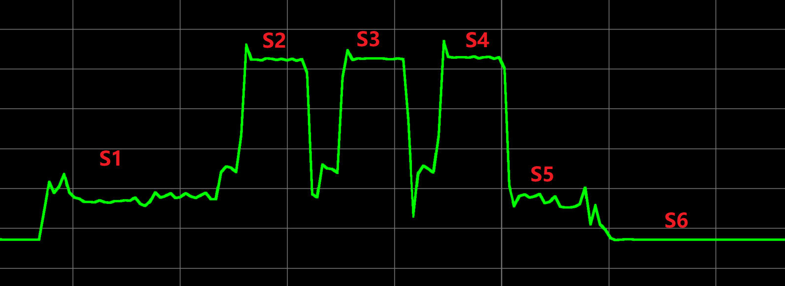

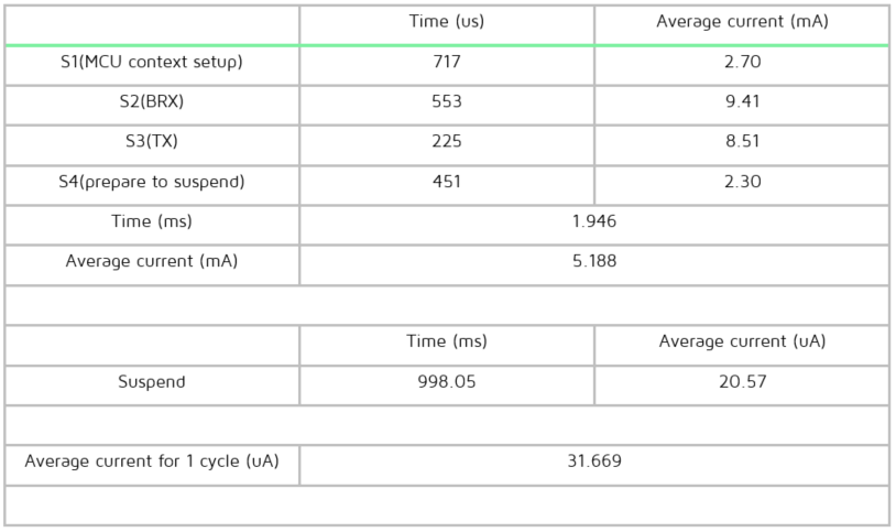

Test in Long Connection
Default condition: CL (Connection Interval): 10 ms, L (Slave Latency):99, L * (SL + 1) = 1 s
Test condition 1 for long connection:
- TX power: 3dBm

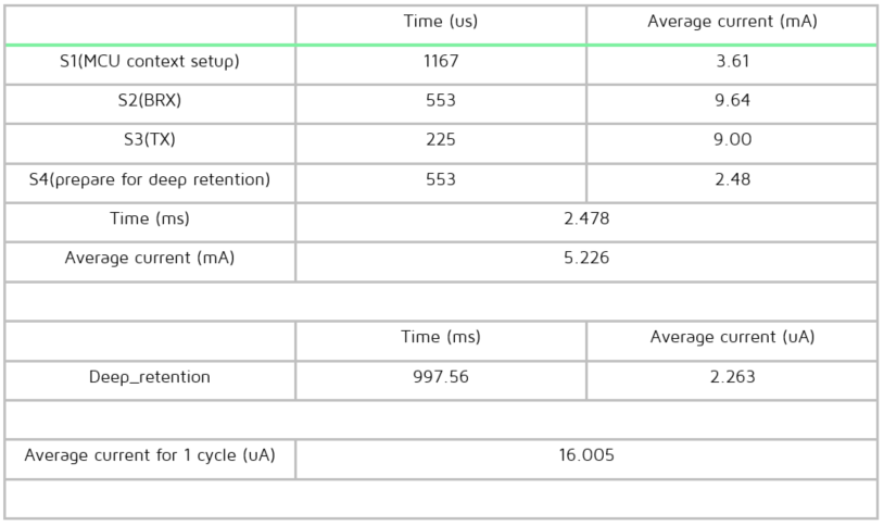

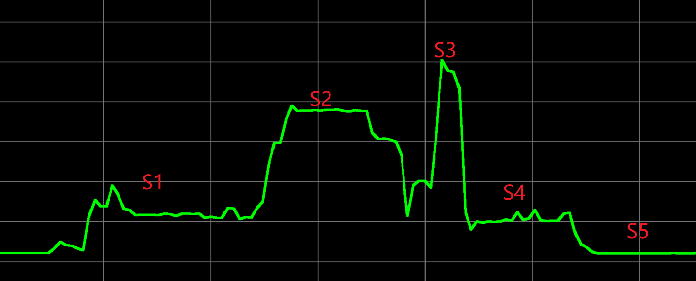

Test condition 2 for long connection:
- TX power: 3dBm
The average current for each test condition in the long connection are as follows.
