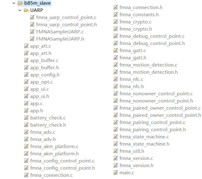

vendor file structure
The vendor directory contains 3 projects: b85m_demo, b85m_feature, and b85m_slave. Currently the FMN feature is only supported on b85m_slave. The vendor directory also contains the common, platform folders.
b85m_slave file structure

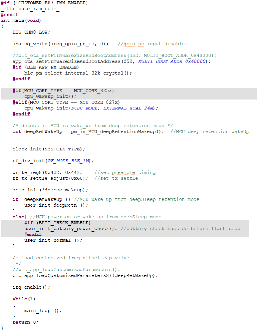

main.c
The main.c file contains the main function and interrupt handling functions. The main function is the entry point of the program and includes the necessary configuration for the system to work properly. Considering the power consumption when the program enters deep retention, it is recommended that users do not modify it. The interrupt handling function serves as the entry function when the system triggers an interrupt.
main function
app_config.h
This is the user configuration file used to configure various parameters of the entire system (such as BLE parameters, GPIO configuration, low power enable/disable, encryption enable/disable, etc.).
In the subsequent introduction of SDK configuration, detailed explanations of the meanings of each parameter in app_config.h will be provided.
Application files
app.c: It is used to complete BLE system initialization, event/data processing, low power handling, FMNA initialization, main loop processing, and so on.
app_att.c: Provides GATT service table and profile. The GATT service table already includes standard GATT services, standard GAP services, and FMNA-related services. Users can refer to these and add their own services and profiles.
app_ui.c: Mainly provides keystroke functions.
app_buffer.c: It is used to define the buffers used by each layer of the stack, e.g., Link Layer TX & RX buffer, L2CAP layer MTU TX & RX buffer, HCI TX & RX buffer, etc.
app_opt.c: It is used for CPU wake-up initialization, rf drv initialization, etc.
battery_check.c: It is used for battery level detection and low battery handling.
FMNA files
fmna_adv.c: It is used for setting the content of FMNA broadcast packets.
fmna_akm_platform.c: It is used for store and restore of fmna key.
fmna_config_control_point.c: It is used for setting FMNA related parameters and status, controlling audio play/stop, and issuing commands for unpairing and other interactions.
fmna_connection.c: It is used for switching, querying, judging the connection and disconnection status of FMNA, as well as handling the logic for unpairing.

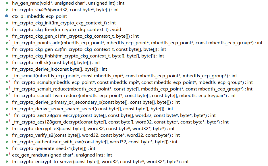

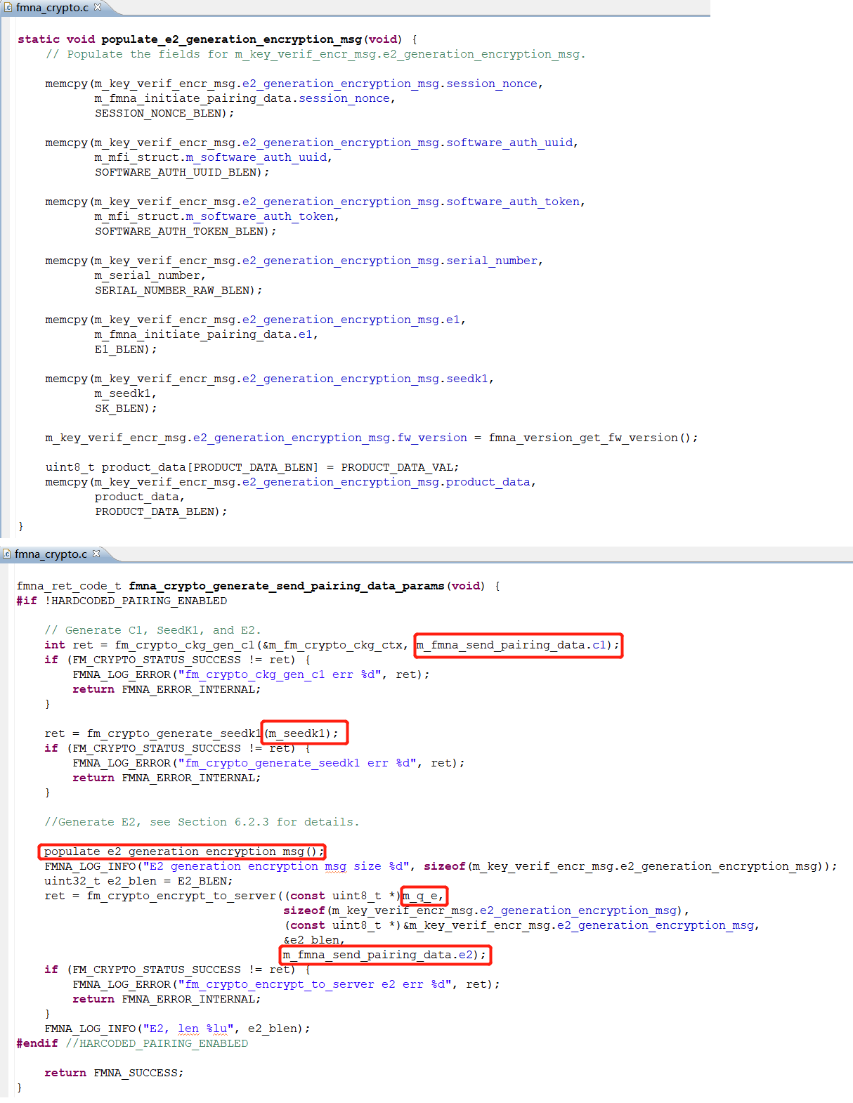

fmna_crypto.c: It is used for initializing FMNA crypto, handling data processing in the pairing process, generating FMNA keys, and managing the logic for serial number processing.
fmna_debug_control_point.c: It is used for parameter settings and log retrieval of FMNA devices in debug mode through the FMCA tool app.
fmna_gatt.c: FMNA interacts with write request and indicate operations through BLE GATT, implemented by callback functions, and so on.

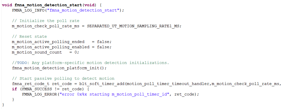

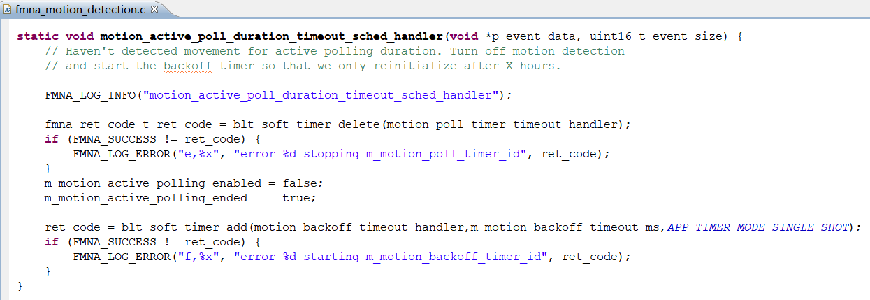

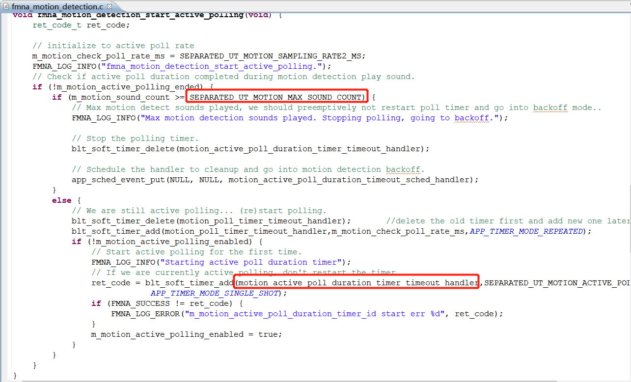

fmna_motion_detection.c: The processing implementation of motion detection in the separated state of FMNA devices, and so on.
fmna_nfc.c: It is used for NFC initialization, obtaining and updating NFC URL keys, and so on.
fmna_nonowner_control_point.c: It is used for non-owner control of FMNA devices, such as playing and stopping sounds.
fmna_paired_owner_control_point.c: It is used for owners to retrieve the current primary key, iCloud ID, serial number, and other information from FMNA devices.

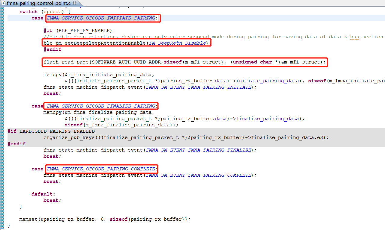

fmna_pairing_control_point.c: It is used for FMNA devices to process pairing commands.

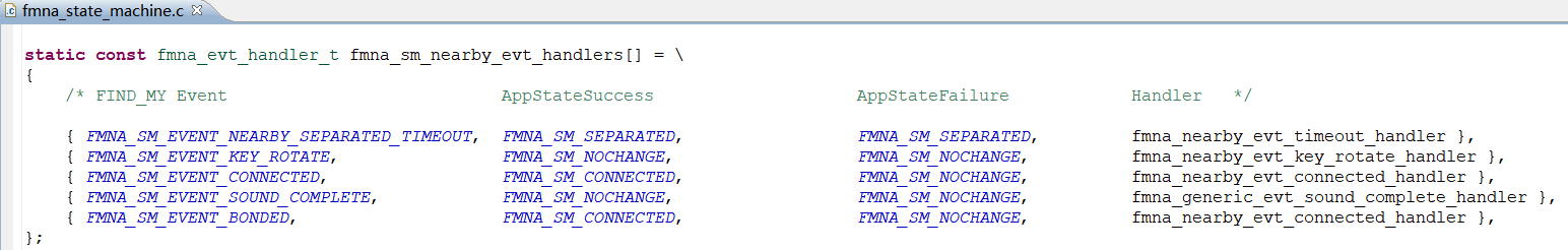

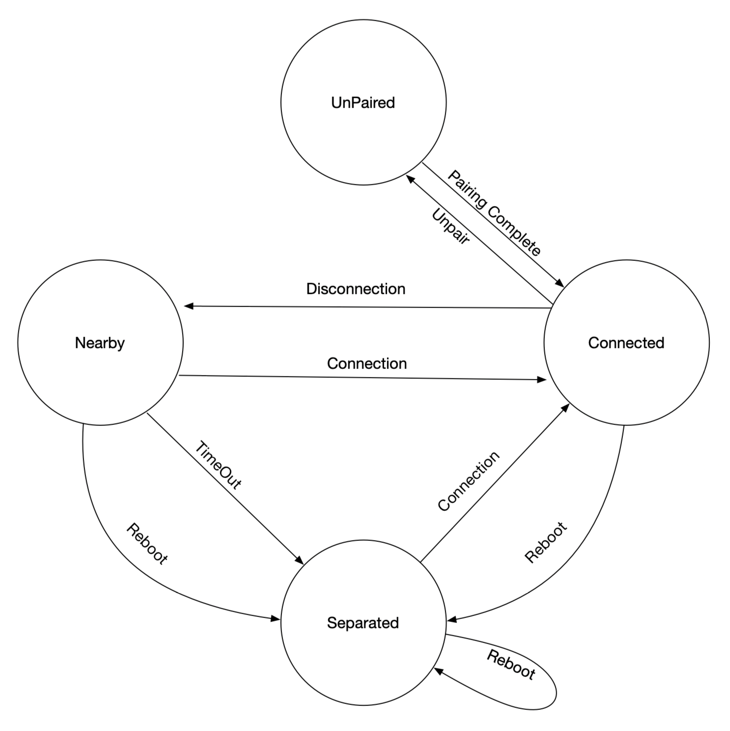

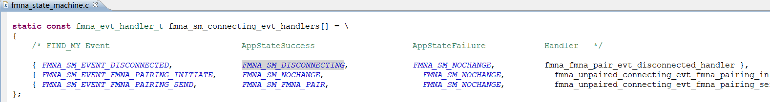

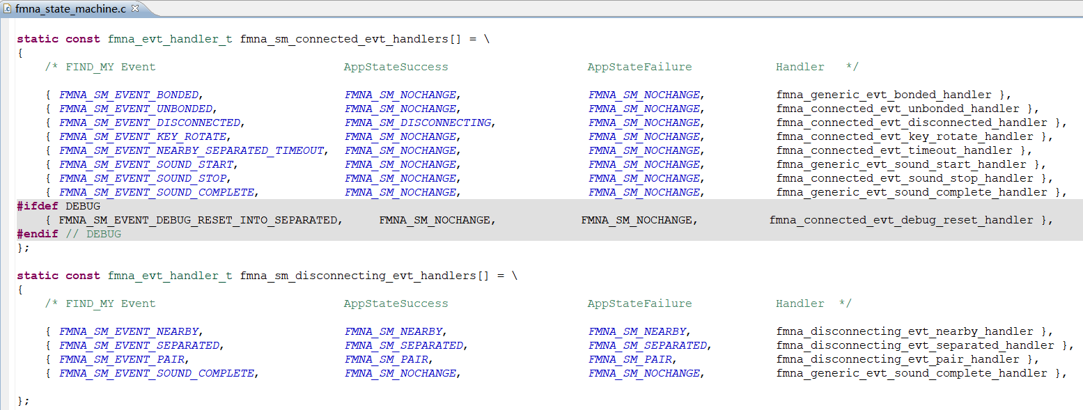

fmna_state_machine.c: It is used for logic implementation of the state machine, including handling events such as boot, pair, separated, nearby, connecting, FMNA pair, FMNA pair complete, connected, disconnecting, etc.
fmna_version.c: It is used for initialization and retrieval of FMNA version.

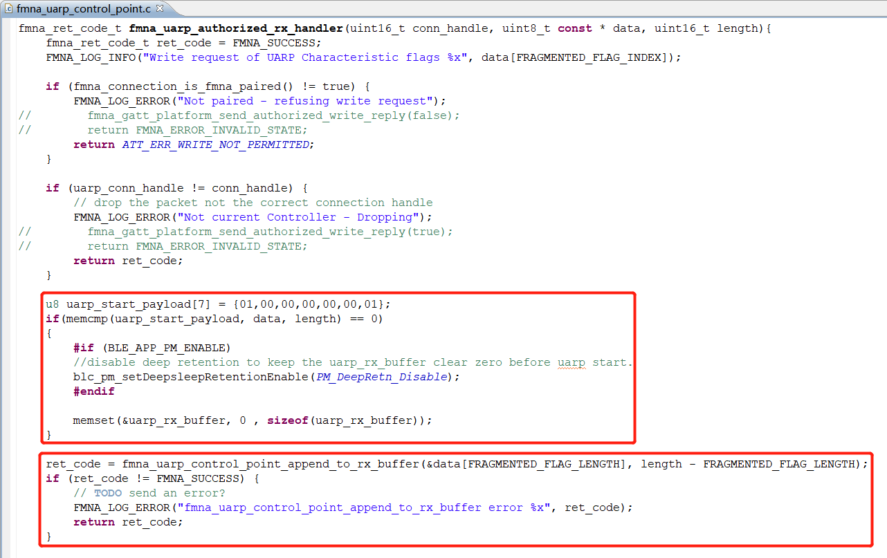

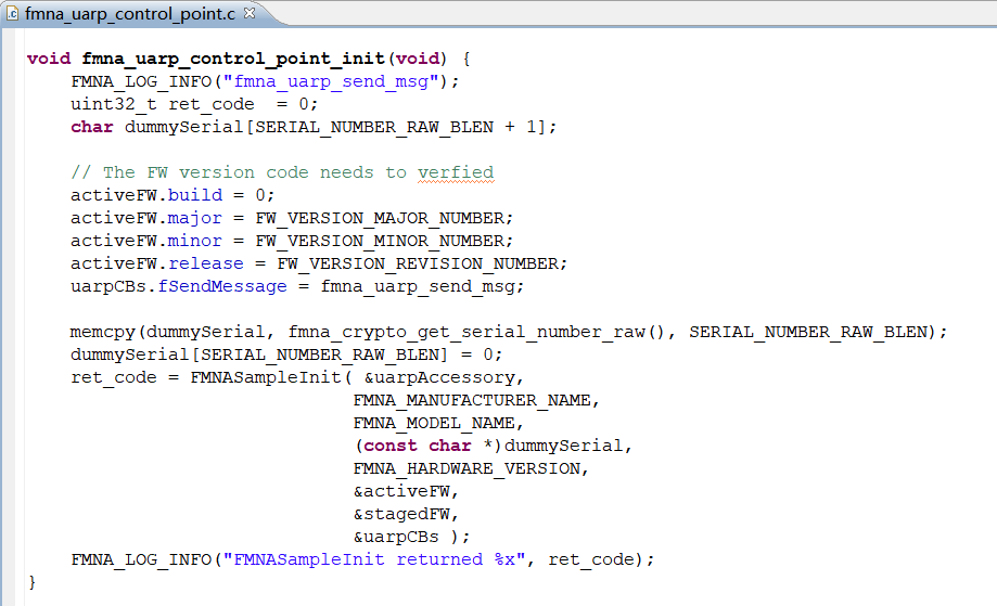

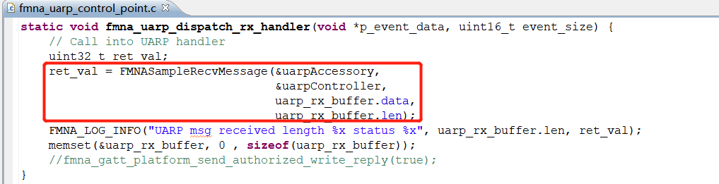

./UARP/fmna_uarp_control_point.c: It is used for UARP initialization, connection, disconnection, packet handling, and so on.
./UARP/FMNASampleUARP.c: It is used for FMNA sample initialization, controller addition/removal, message sending/receiving, buffer malloc/free, querying firmware information, firmware storage, and so on.

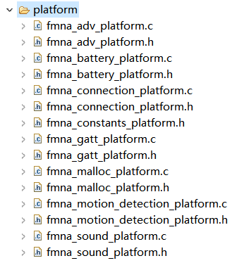

Platform Files
platform file structure
fmna_adv_platform.c: It is used for implementing FMNA to set the broadcast content for three states: FMNA Pair, Separated, and Nearby.
fmna_battery_platform.c: It is used for obtaining the battery level.
fmna_connection_platform.c: It is used for active disconnection, requesting sec info, obtaining serial number, and storing token in flash memory, etc.
fmna_gatt_platform.c: It is used for implementing the indicate logic in FMNA.
fmna_malloc_platform.c: It is used for implementing the malloc and free functionality.
fmna_motion_detection_platform.c: It is used for hardware simulation to implement motion detection functionality.
fmna_sound_platform.c: It is used for hardware simulation to implement sound play and stop functionality.

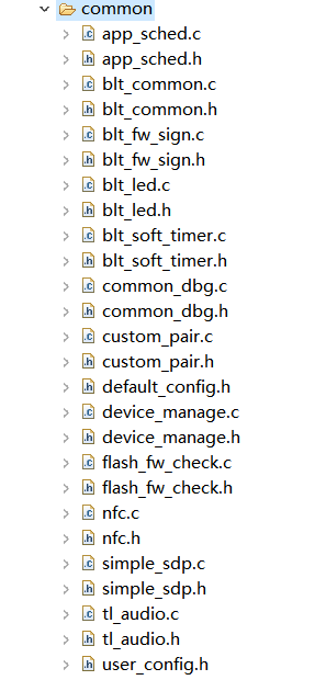

Common Files
common file structure
app_sched.c: It is used for implementation solutions for event schedulers.
blt_common.c: It is used for setting up the MAC address for Bluetooth devices.
blt_fw_sign.c: It is used for firmware signature verification.
blt_led.c: the LED control logic based on hardware implementation.
blt_soft_timer.c: It is used for the implementation of software timers.
common_dbg.c: It is used for hardware debug serial port initialization in low-power mode.
custom_pair.c: It is used for binding device information processing, MAC address management, etc.
device_manage.c: It is used for management of connection device information (e.g. connection handle, attribute handle, BLE device address, address type, etc.).
flash_fw_check.c: It is used for firmware crc check.
nfc.c: It is used for nfc function implementation.
simple_sdp.c: It is used for implementation of the SDP (Service Discovery Protocol) function for Master.
tl_audio.c: It is used for data format conversion for audio devices.

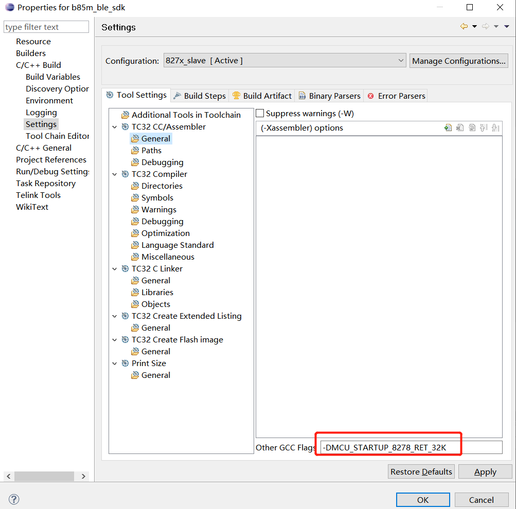

Take 827x_slave and MCU selects 8278 as an example, the method of cstartup.S file corresponding to user setting is as follows:
Find the file "cstartup_8278_RET_32K.S" under the boot/8278 folder, find the macro MCU_STARTUP_8278_RET_32K in the file, and then configure it in the project's property setting window as shown in the following figure.
cstartup selection

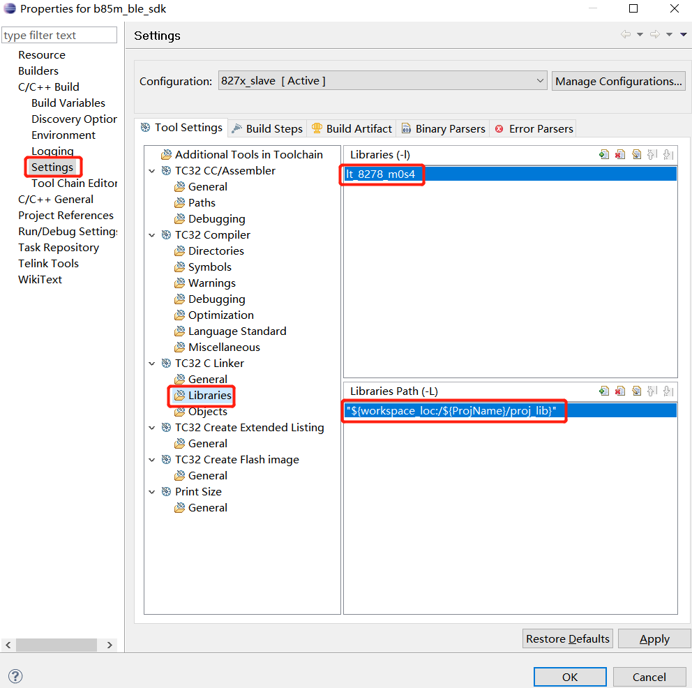

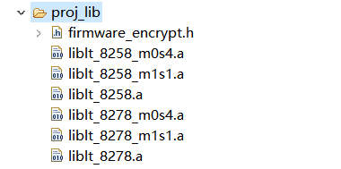

Library introduction
The library corresponding to the Telink FMN SDK configuration project is shown below.
Library provided by Telink FMN SDK
Library settings supported by Telink FMN project
Note
  • The Telink FMN SDK currently only supports the library of liblt_8278_m0s4.a.

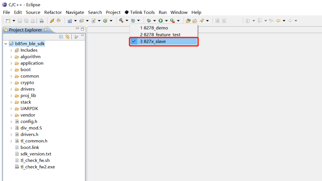

SDK project compilation configuration
SDK project compilation configuration: 827x_slave.
Project compilation selection

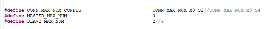

Multi-connection mode
Multi-connection mode: default supports 0 master + 2 slave connections.
Multi-connection mode configuration

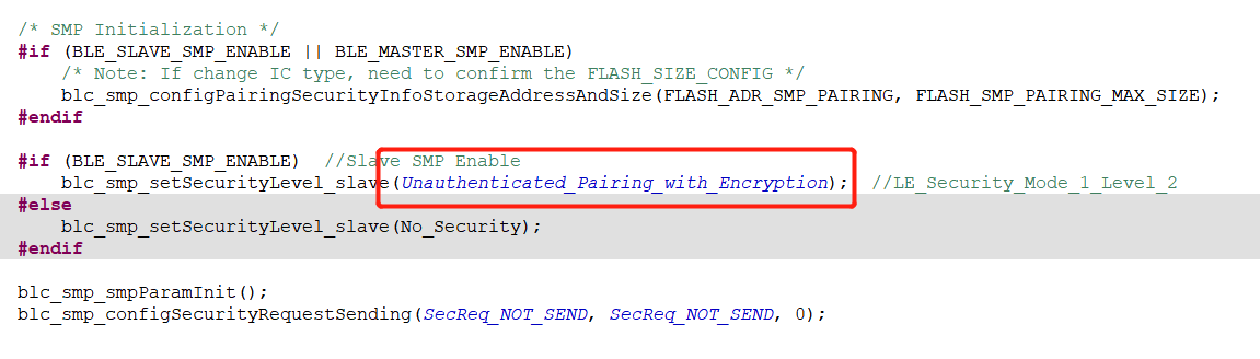

SMP configuration
SMP configuration: SMP enabled by default, SMP level: just work.
SMP configuration

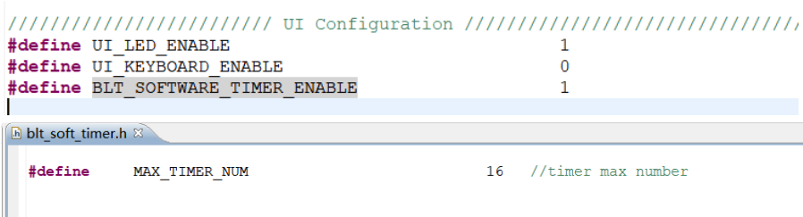

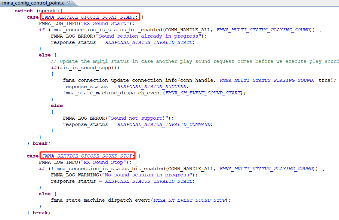

LED configuration
LED configuration: enabled by default, used for LED switching action to simulate the sound play, stop function of FMNA.
Software timer configuration
Software timer configuration: enabled by default, need to support FMNA multiple timer settings, currently supports up to 16 timer tasks.

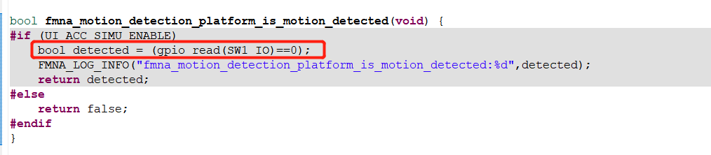

Motion detection configuration
Motion detection configuration: enabled by default, use GPIO high and low level to simulate motion action.

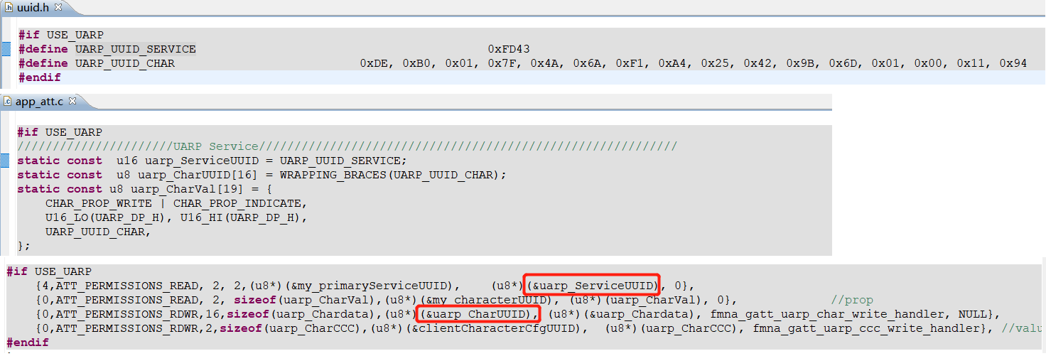

UARP function
UARP function: supported by default, need to use the tool APP FMCA to do test case to verify the firmware upgrade function.

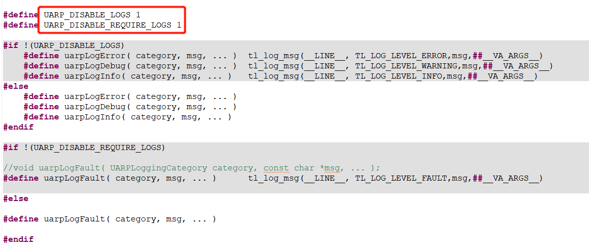

c. UARP debug function configuration: Enable UART_PRINT_DEBUG_ENABLE, then disable UARP_DISABLE_LOGS and UARP_DISABLE_REQUIRE_LOG to enable the debug UARP function.

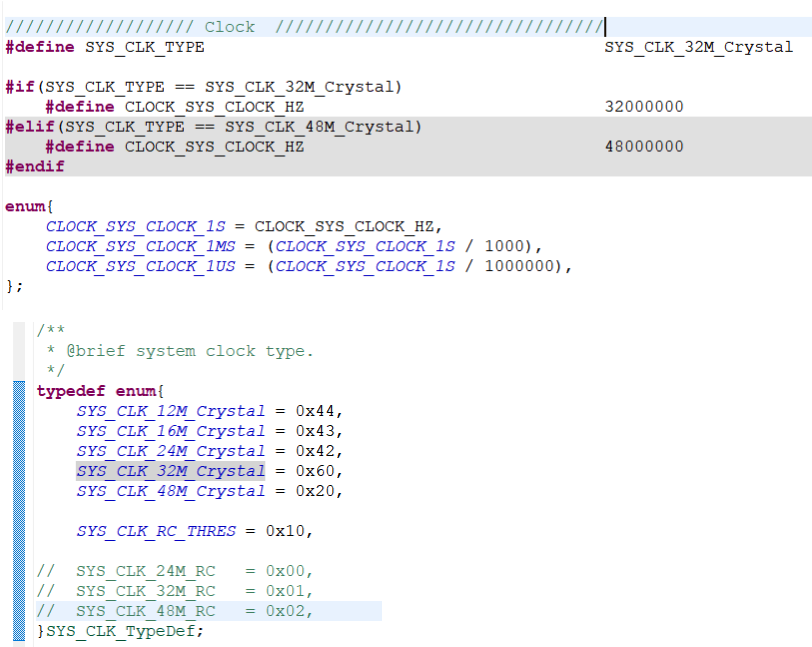

System main frequency configuration
System main frequency configuration: support 12M, 16M, 24M, 32M, 48M, with unit of Hz, it is recommended that users use the default value of 32M, too small value will affect the algorithm running speed, too large value will affect the low power consumption.
System clock setting

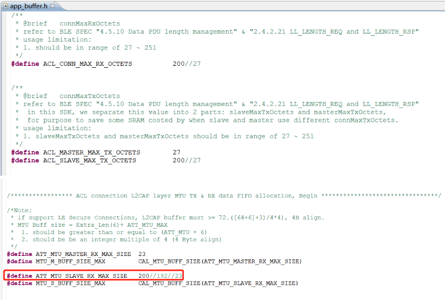

DLE and MTU settings
DLE and MTU settings: the default value of DLE is 200 and the default value of MTU is 200.

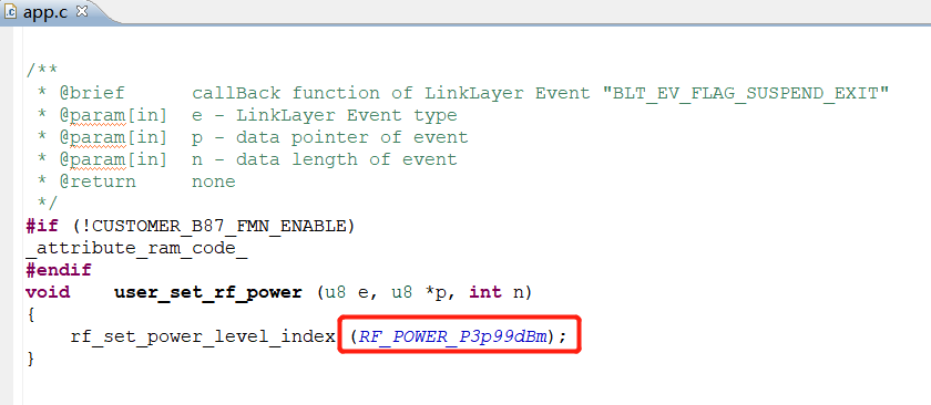

RF power setting
RF power setting: the default configuration is 4dBm as required by the FMN protocol.
RF power setting

Firmware update service
Service uuid: 0xFD43
Characteristics uuid: 94110001-6D9B-4225-A4F1-6A4A7F01B0DE
Firmware update service GATT setting

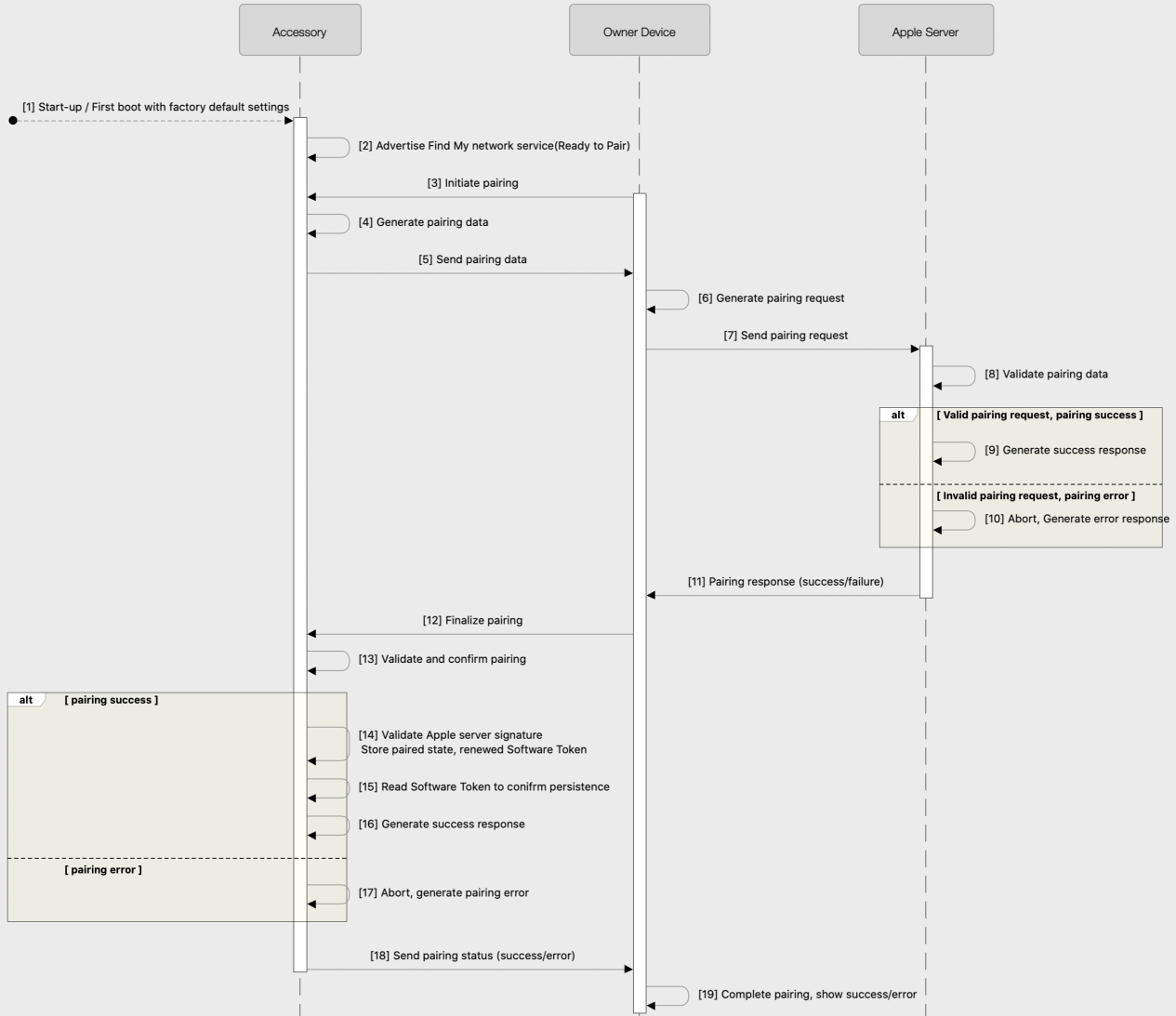

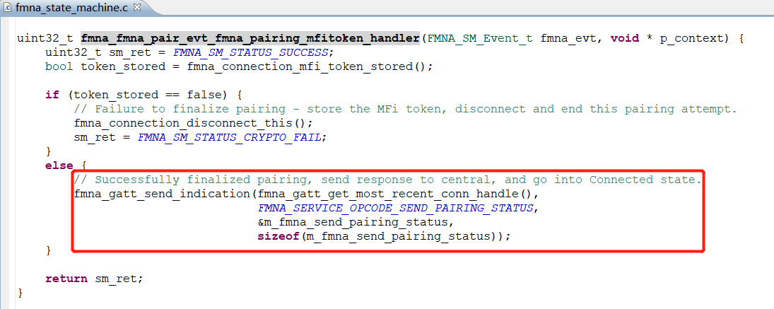

Processing logic of pairing command
FMNA_SERVICE_OPCODE_INITIATE_PAIRING

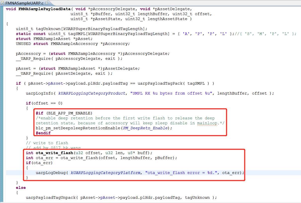

Since the retention RAM is not enough, the device receives the initiating pairing command, disables the deep retention function to ensure that the contents of all variables remain unchanged during the pairing process, and reads the token from the flash for pairing.
FMNA_SERVICE_OPCODE_FINALIZE_PAIRING
It is used to verify and confirm pairing to apple device (contains steps such as accessory verify S2, decrypt E3, generate C3, generate E4, send pairing status to owner device).
FMNA_SERVICE_OPCODE_PAIRING_COMPLETE
Calculate the primary key and secondary key, and start the key rotate timer to generate the key at regular intervals, and enable the deep retention function after the pairing is completed to reduce the power consumption.
Pairing command process

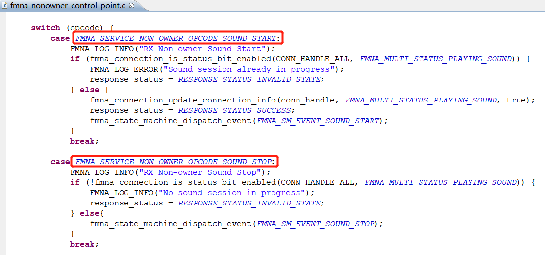

Sound play and stop for object location
Processing logic of play and stop command by owner control
Play and stop by owner control
Processing logic of play and stop command by non-owner control
Play and stop by non-owner control

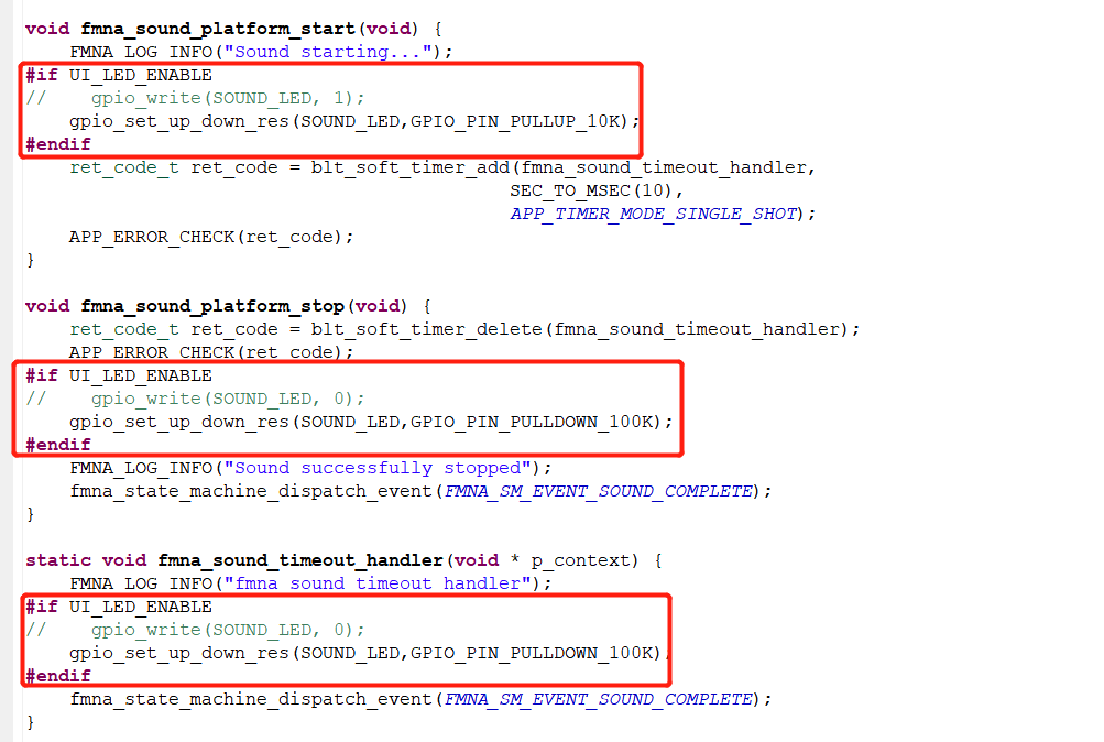

Sound play and stop
The sound play and stop processing is simulated by LED light on and off for demonstration, users need to realize this function.

Motion detection function
Start motion detection
Motion detection method
Demonstration of motion detect is simulated through the GPIO interface, which is required by the user to implement this feature.
Processing logic after motion detected
After judging the number of motion detections exceeds 10 times, it switches to backoff mode detection; if it does not exceed 10 times, it enters backoff mode detection after a 20-second timeout.
Process after motion detected
Switch to backoff mode

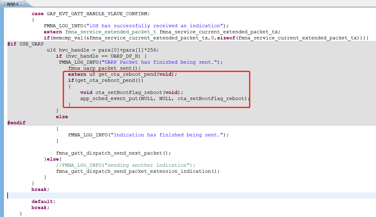

UARP firmware upgrade
UARP interface initialization
UARP initialization
Processing of UARP packets receiving
Since the retention RAM is not enough, the device turns off the deep retention function after receiving the first packet to ensure that the contents of all variables remain unchanged during the firmware upgrade process, and the packet is received to do group packet (append) processing of the data.
UARP packet receiving
Processing of UARP appended packets
Clear the data reception buffer when processing of the data after appended packets is completed.
Processing after UARP appended packets
Write UARP append data to flash
When the firmware data is received, every 512 bytes received will be written to flash. As the program runs to the position of writing the first data, it means that the firmware version and other information has been confirmed to be correct and can be upgraded. At this time, in order to ensure the speed of firmware upgrading and normal execution, the program will turn off sleep and not to enter sleep. Therefore, the function of deep retention is restored here to prevent the program from entering deep retention when the OTA is abnormal.
UARP response
After the data is processed, a response is sent to the owner device.
UARP response
Restart after UARP firmware received
Execute restart after firmware data receiving is complete.
SDK Module

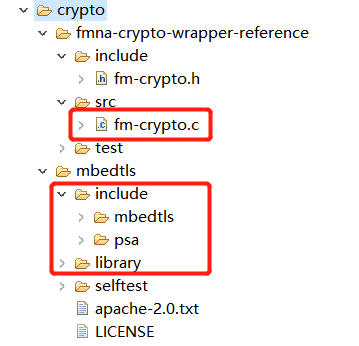

mbedtls algorithm library
It is a set of open source algorithm library, implements encryption algorithms, X.509 certificate operation, and SSL/TLS and DTLS protocols, and provides the reference implementation of the PSA encryption API specification. Telink FMN SDK used in the sha256 (hash calculation), ANSI x9.63 KDF (key calculation generation), NIST P-224 elliptic curve (elliptic curve point calculation and verification), ECDSA/ECDH (signature verification), AES-128-GCM (encryption and decryption) and other algorithms.
crypto file structure
fm-crypto function interface
The FMN application layer mainly uses the interfaces of the fm-crypto.c file (as shown in the figure below) to call the mbedtls algorithm library, in order to achieve functionalities such as pairing, encryption/decryption, signature verification, key generation, and hash calculation.

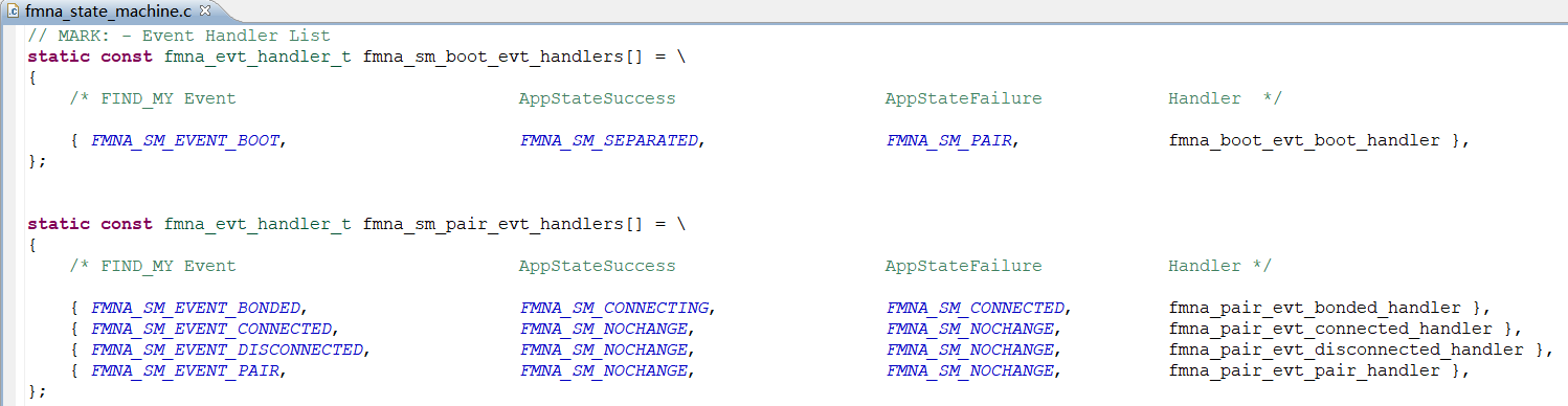

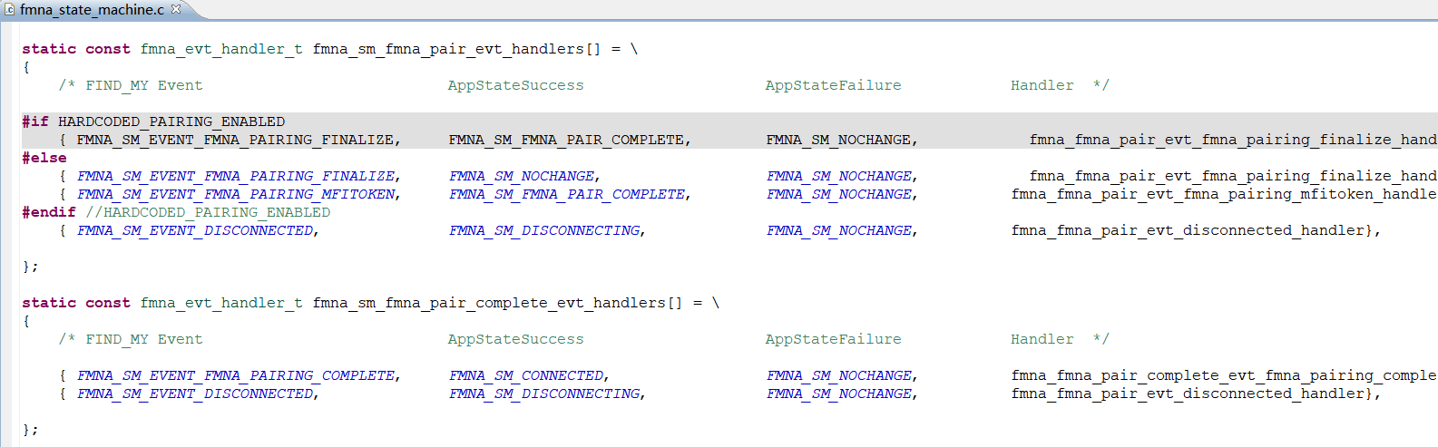

State machine
FMN state machine
The accessory operations can be described using a state machine, and the transitions performed between them are based on the logic of the interaction of the accessory with the owner device.
FMN state machine
FMN unpaired event handlers
Unpaired:The accessory must be in the unpaired state after the first power-up startup or before accessory pairing is complete. In this state, the accessory must treat the Find My network service as a primary service in the connectable broadcast package. The user initiates pairing at the owner device and thereafter the accessory enters the pairing process.
FMN connection and pairing
Connected:After successfully pairing with the owner device, the accessory must enter the connected state. Once the pairing is complete, the owner device may disconnect from the accessory. Once paired, the accessory cannot be paired with any other Apple device. It must remain paired until it successfully completes the unpairing process with the owner device. The accessory must re-enter the connected state from either the nearby or separated state, or when the owner device connects. The accessory can simultaneously connect to two Apple devices on the same iCloud account. The motion detection and unwanted tracking detection protocols are not available in the connected state. When the accessory enters the connected state, the broadcast payload should be set to the nearby key. If link encryption is not completed within 10 seconds, the paired accessory must disconnect.
FMN connecting event handlers
Note
  • The pairing process is also part of the connected state machine.
FMN pairing event handlers
FMN connected event handlers
FMN nearby
Nearby:The accessory must enter the nearby state immediately after disconnecting the owner device. The accessory remains in the nearby state for a set period of time (default 15 minutes). The Motion detection and unwanted tracking detection protocols are not available in the nearby state. When the accessory enters this state, the broadcast payload should be set to the nearby key.
FMN nearby event handlers
FMN separated
Separated:The accessory enters the separated state under 2 conditions: 1. the accessory has been paired and started from reset, power up and reinitialization. 2. the accessory enters the separated state after a timeout in the nearby state. The motion detection and unwanted tracking detection protocols are available in the separated state. When the accessory enters the separated state, the broadcast payload should be set to the primary or secondary key.
FMN separated event handlers

Pairing flow chart
FMN pairing flow
Pairing process
Generate pairing data: After the Bluetooth connection is paired, accessory will generate C1 in the pairing data and start the pairing process after receiving the initiating pairing data sent by the owner device, and then generate the key seed (SeedK1) for each pairing session, which is then encrypted by the input parameters (SessionNonce, Software auth token, Software auth UUID, Serial Number, Product Data, FW Version, E1, SeedK1) are encrypted by the encryption key (Q_E) to generate E2 in the pairing data.
Note
  • The accessory must regenerate SeedK1 for each pairing task.

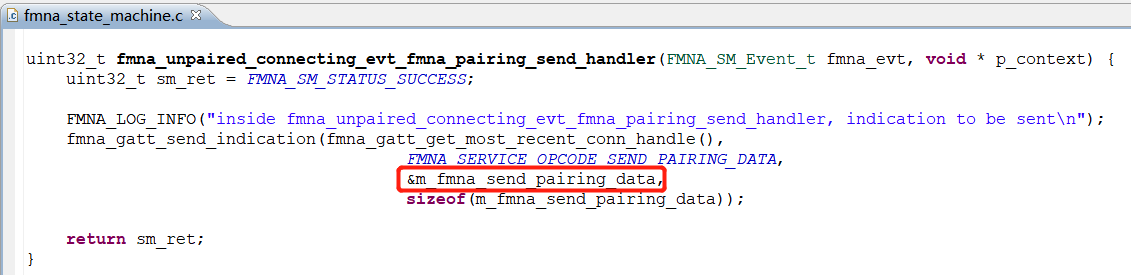

Send pairing data:The accessory sends the pairing data generated in the previous step (containing C1 and E2) via ble indicate.
Send pairing data

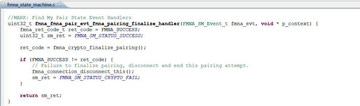

Finalize pairing:The owner device sends finalize pairing data to the accessory and initiates the final pairing process to complete the pairing.
Finalize pairing
Validate and confirm pairing:The accessory analyzes the finalize pairing data, verifies the signature (S2) in the finalize pairing data using the signing verification key (Q_A), decrypts E3 in the finalize pairing data to obtain the new token issued by the Apple server. It then generates C3 in the pairing status based on C2 in the finalize pairing data. The accessory assembles and encrypts the new token along with other parameters (Software auth UUID, Serial Number, SessionNonce, E1, Status) to generate E4 in the pairing status. Finally, the accessory saves the new token to flash for use in the next pairing process.
Send pairing status: The accessory sends the pairing status (containing C3 and E4) generated in the previous step through the BLE indication interface. The owner device receives the pairing status to confirm whether the previously issued new token has been successfully received by the accessory, thereby determining the success of the pairing process.
Send pairing status
Pairing complete:The owner confirms the successful pairing and issues a "pairing complete" to the accessory. The accessory will set the paired flag and enter the nearby state, then generate Primary and secondary keys and start the key rotation timer to initiate the iteration of Primary and secondary keys.
Pairing complete
