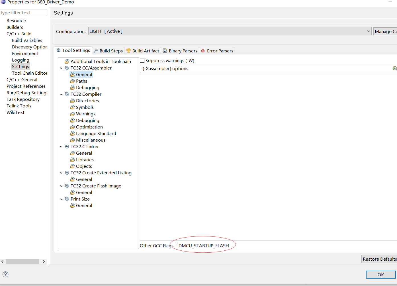

cstartup_flash.S: flash mode, the burning program runs in flash, you can choose this mode when the development board equips with external flash.
cstartup_otp.S: otp mode, the burning program runs in otp, as B80 eventually uses built-in otp, the otp option will be used for the final mass production products.
cstartup_sram.S: sram mode, you can use this mode for debugging when there is no external flash, and you need to do simple debugging to avoid the otp can't be changed after it is written.
"Compile Mode Options"

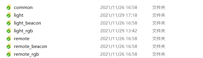

Demonstration
Inside the demonstration folder is the defined code for the user layer.
"Demonstration Folder Structure"
The common folder contains the folder options that are common to all compilation options. The rest of the folders correspond to different compilation branches.

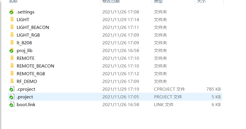

Project
The project folder is the folder for this project, where the .cproject and .project file are the corresponding project files, .boot and .link are the link files, which are not recommended to be modified by the customer, the proj_lib is the path where the library is placed, and the folders in it are the files generated by the compilation, for example, LIGHT.bin and LIGHT.lst will be generated inside the LIGHT folder.
"Project Folder Structure"

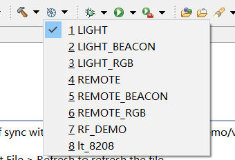

Demonstration Project
The B80 remote light SDK is a compilation branch for customer development, which allows users to observe the visual effects through demonstration operations and also to modify on the demonstration code to complete the development of their own applications.
"List of Compilation Options"

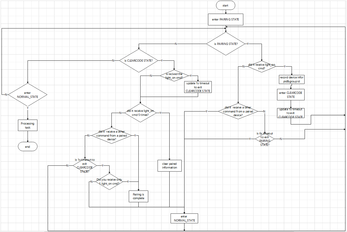

SDK pairing principle:
Within 5s of power up, short press the on light key of a group once, the pairing will be completed. The LED flashes 3 times after pairing success.
Within 5s of power up, short press the on light key of a group for consecutive 5 times (interval less than 500ms), it will finish clearing the pairing information. The LED flashes 5 times after clear pairing information successfully.
Within 5s of power up, if a non-light-on key command is received, it will exit pairing mode and enter the normal state.
Flowchart of SDK pairing is as below.
"Light & Remote Pairing Process"

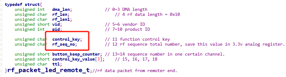

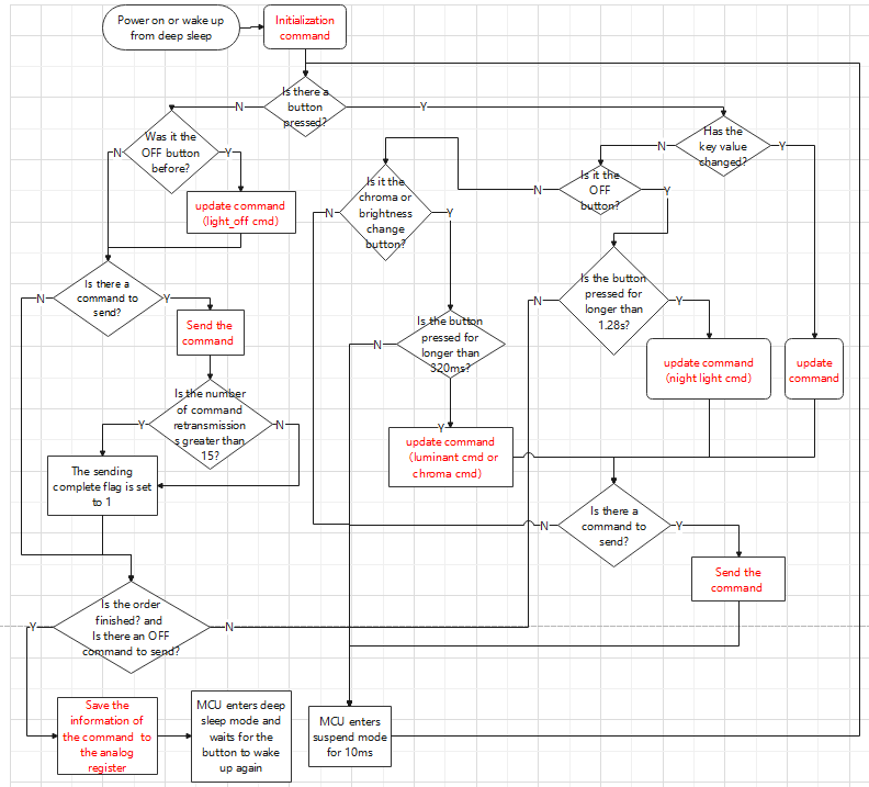

Take the remote project as an example. The description of the function for sending packet is as below.
"Command Packet Data Structure"
void package_data_init_func(void)
Sending packet data initialization. Configure VID information, reassign a specific otp address or PID of the remote, and get the saved information from the analog register.
void package_data_set_newcmd(unsigned char key_value,unsigned char* para)
Configure the new command. Update the rf_seq_no, control_code and control_code parameters.
void package_data_send_func(void)
Call the rf module to send the command out. (remote send TTL=5) (The command is normally repeated 15 times unless it is updated to a new command halfway through.)
void package_data_store_func(void)
Store the group&rf_seq_no information of the command code to the analog register. Prevents loss of information at a wake-up after deep sleep.
The logic flow chart for the sending packet is as below.
"Remote Command Sending Packet Process"

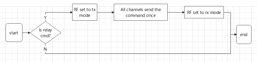

Take the light project as an example. The function that forwards the command is described as below.
Light forwards the received remote control commands to other light devices.
void rfc_send_relay_pkt(void)
Forward incoming remote commands, ttl minus 1, to prevent infinite forwarding.
"Light Command Forwarding Flow"

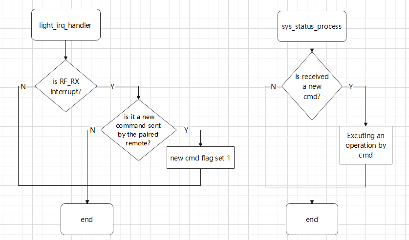

Interface description for packet receiving.
void sys_status_process(void)
The interrupt function "void light_irq_handler(void) determines that the data received is a new command from the paired remote. The corresponding control command is then processed in the function "void sys_status_process(void)".
The logic flow chart for packet receiving is as below.
"Light Command Response Flow"

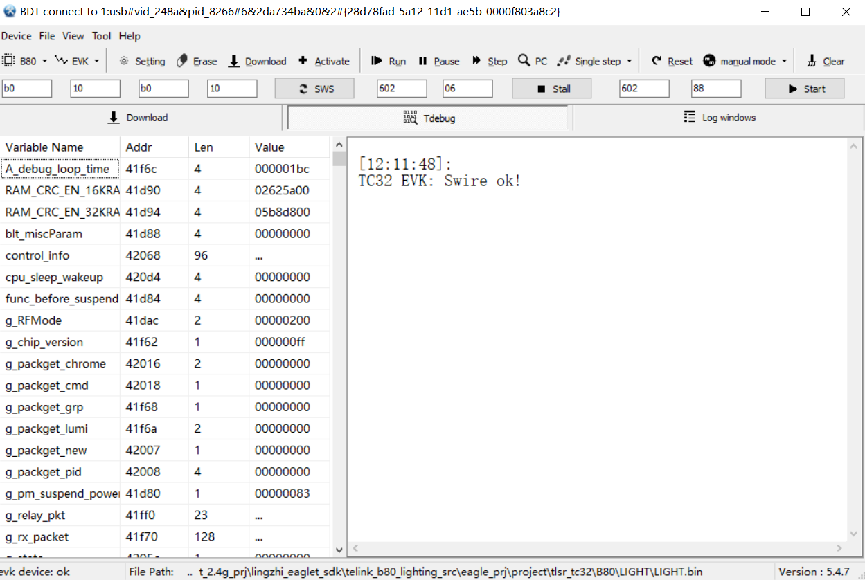

Debug by looking at the corresponding variables through the wtcdb tool.
"wtcdb Debug"

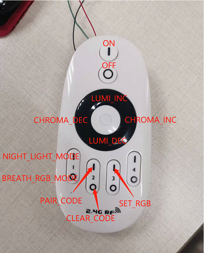

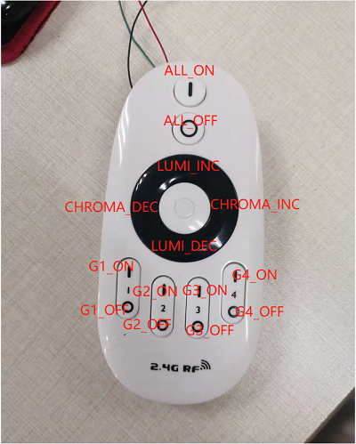

Key Functions of REMOTE& LIGHT and REMOTE_BEACON& LIGHT_BEACON
"REMOTE&LIGHT and REMOTE_BEACON&LIGHT_BEACON keys introduction"
All On:
Short or long press to send out an All On command to turn on all nearby lights paired with the remote.
All Off:
Press "<" for 1.5s, the key lifts and sends the All Off command to turn off all nearby lights paired with the remote.
Press the key ">" for 1.5s to send the all into night light mode command to put all nearby lights paired with the remote into night light mode.
Group 1 On:
Short or long press to send out a Group 1 On command to turn on all nearby lights that are paired with Group 1.
Group 1 Off:
Press "<" for 1.5s, the key lifts and sends the Group 1 Off command, turning off all nearby lights paired with Group 1.
Press the key ">" for 1.5s to send the group 1 into night light mode command to put all nearby lights paired with group 1 into night light mode.
Group 2 on / group 3 on / group 4 on:Ditto for "Group 1 On".
Group 2 off / group 3 off / group 4 off:Ditto for "Group 1 Off".
Luminance increase / Luminance decrease:
Select the group (press the group on/off key, e.g. "Group 1 On" or "Group 1 Off") and press the Lumi_inc / Lumi_dec key.
Short press of the key sends a single command in a single pass. The luminance changes once.
Long press of the key for about 320ms each, to send a continuous command and the luminance changes continuously.
Chromaticity increase / chromaticity decrease:
Select the group (press the group on/off key, e.g. "Group 1 On" or "Group 1 Off") and press the Chroma_inc / Chroma_dec key.
Short press of the key sends a single command in a single pass. The chroma changes once.
Long press of the key for about 320ms each, and the command is sent continuously and the chroma changes continuously.
Key Functions of REMOTE_RGB&LIGHT_RGB
"REMOTE_RGB&LIGHT_RGB keys introduction"
Color temperature light on:
Short or long press to send out a light on command to turn on all the nearby color temperature lights paired with the remote.
Color temperature light off:
Short or long press to send out a light off command to turn off all nearby color temperature lights paired with the remote.
Luminance increase / Luminance decrease / chromaticity increase /chromaticity decrease:
Short press the key to send a single command, light led changes once.
Long press the key, 320ms timed update command, light led changes continuously.
RGB breathing light mode does not respond to color temperature and luminance adjustment commands.
Night light mode:
Short or long press to send out a night light mode command to put all nearby color temperature lights paired with the remote into night light mode.
RGB breathing light mode:
Short or long press to send out a night light mode command to put all the nearby color temperature lights paired with the remote into RGB breathing light mode.
Pair code:
light powers up < 6s, short press or long press the remote to send out pairing command, light receives command, retains pairing information and flashes light 3 times.
light power on > 6s, short press or long press the remote to send out pairing command, no action on the light.
Clear Code:
light powers up < 6s, short press or long press the remote to send out a clear code command, light receives the command, clears the pairing information and flashes 5 times.
light power on > 6s, short or long press the remote to send clear code command, no action on the light.
RGB settings:
Short or long press to send out the RGB setting command to turn on all RGB lights of nearby color temperature lights paired with the remote by 50%.
