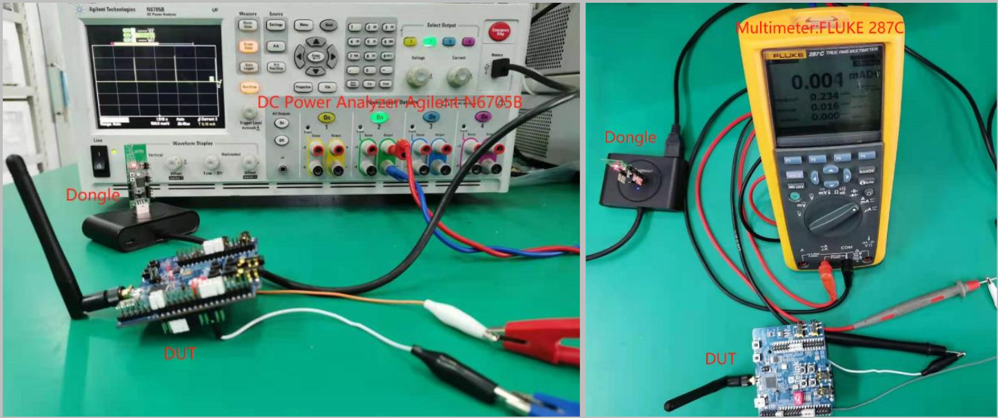

Software and Hardware
The hardware and software for the test are listed as below:

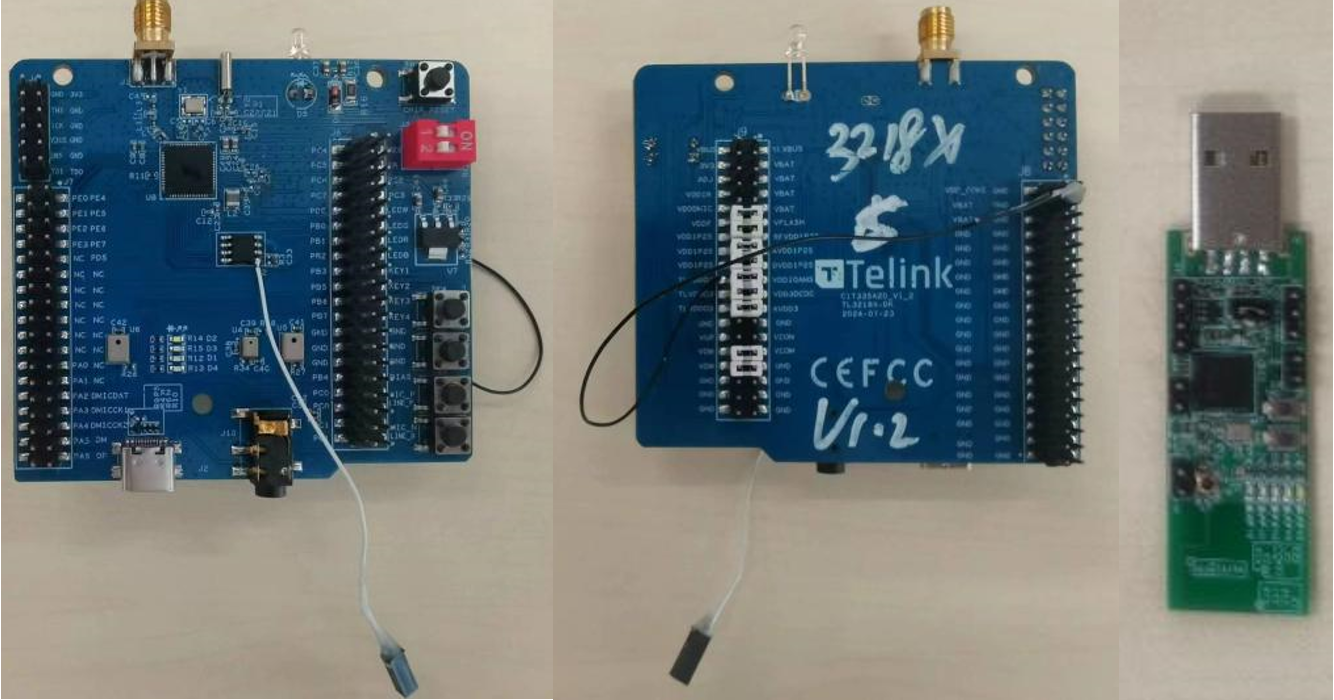

- Test board: C1T331A20_V1.0/C1T335A20_V1.0 with TL321x chip
- SDK: tl_ble_sdk V4.0.4.2 (Note: this report uses the optimized code based on this version, while the system clock is adjusted to XTAL_24M.)
- Test tool: Agilent Precision DC Power Analyzer (Model: N6705B), Multimeter FLUKE 287C
- Power supply: Agilent_N6705
Test Method and Test Item
Test Method

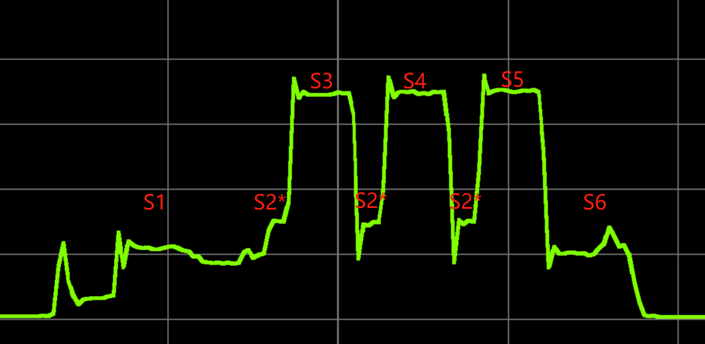

The Agilent N6705B was used to supply 3.3V to the test board. When the test board was advertising, the Agilent N6705B was used to record the current waveform and data in the advertising state of the test board; the test board was connected to the 8258 dongle and the Agilent N6705B was used to record the current waveform and data in the connected state of the test board.
Power the test board at 3.3V using a downloader, and connect in series the multimeter FLUKE 287C into the circuit for current test in the advertising and long connection states.
Note: The tables of average current in the text for the advertising state and the long connection are based on data measured by the Multimeter FLUKE 287C, and the rest are based on data measured by the Agilent N6705B.

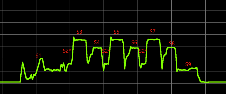

Test in Advertising State
CONNECT adv & 0dBm & Deep retention
Test condition 1 for advertising state (CONNECT adv & 0dBm & Deep retention):
- Power supply: 3.3V
- ADV type: CONNECT_12B_1S_3CHANNEL
- TX power: 0dBm
- Mode: LDO&DCDC mode
- 32K clock source: Internal 32KHz RC
- PM: Deep retention

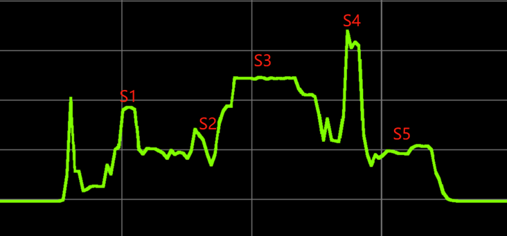

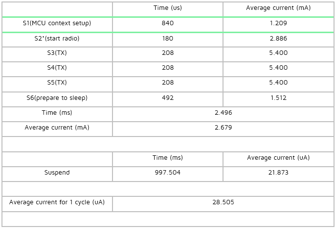

UNCONNECT adv & 0dBm & Suspend
Test condition 2 for advertising state (UNCONNECT adv & 0dBm & Suspend):
- ADV type: UNCONNECT_16B_1S_3CHANNEL
- TX power: 0dBm
- PM: Suspend

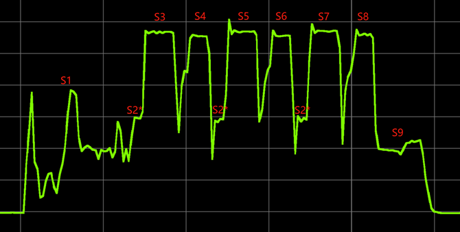

CONNECT adv & 3dBm & Deep retention
Test condition 3 for advertising state (CONNECT adv & 3dBm & Deep retention):
- TX power: 3dBm

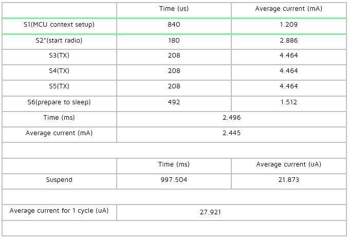

UNCONNECT adv & 3dBm & Suspend
Test condition 4 for advertising state (UNCONNECT adv & 3dBm & Suspend):
- TX power: 3dBm
- PM: Suspend

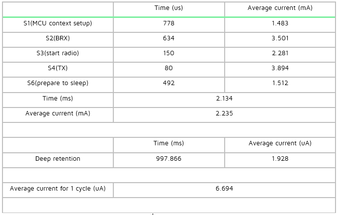

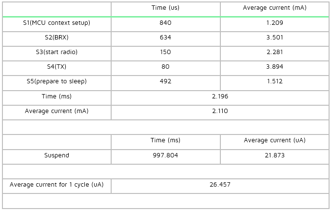

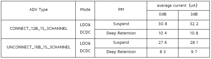

The average current for each test condition in the advertising state with Internal 32K RC are as follows.

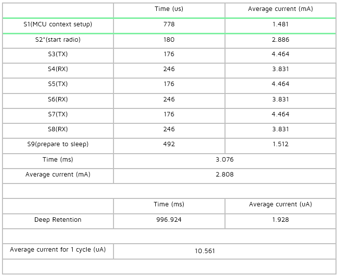

The average current for each test condition in the long connection are as follows.
